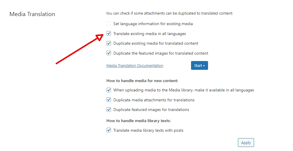

Manually deleting what we think are extraneous images does not work as I believe this multiple images issue was because we did not remove WPML properly from this site. No matter which image we delete, it completely disappears on the post where it was displayed.
So I thought to re-install WPML in order to properly remove it this time, only the WPML database tables are not being re-created, and the whole site is consequently crashing when trying to perform certain actions.
So yes, I am now well aware how to properly remove WPML, but in order to do that I need to first re-install it, along with the appropriate database tables.
Basically, my 2 questions are how to force a re-create of all WPML database tables? And could it have been WPML that caused this multiple image issue, and how to fix that, if it was WPML that caused it?

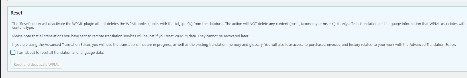

When you disable (or even delete) WPML plugins, all icl_ tables still remain there. This works for most other plugins, rarely plugins will remove all the data upon their removal or deactivation, especially more complex ones. That being said, with WPML all the language information and settings are preserved so you can come back later.
The only option that does what you did is our "Reset and deactivate WPML" button which is only available through troubleshooting and warns you what would happen.

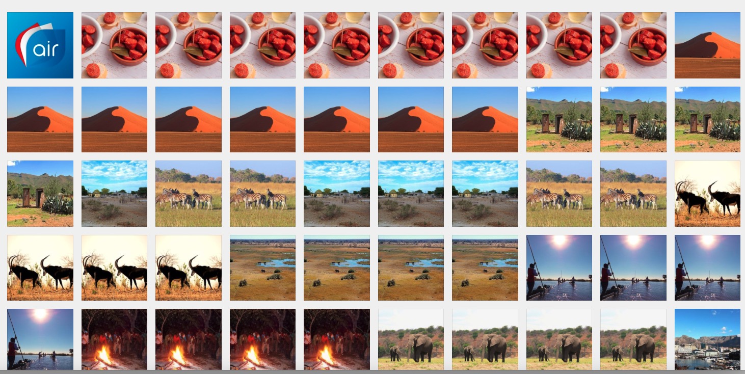

Fact: I'm looking at 4 'copies' of all images in the WP media library. They just need to become one. How hard can it be to write a script to collate these references to the same image? Sure, such a script probably doesn't exist yet as no one has ever done something like this before, ever....

After about 2 weeks of solid research, and finally hiring someone to look into it, I think I have finally realised what happened. Unfortunately though, said pro could not offer a guaranteed fix, except for a very detailed report, which included thousands of orphaned database entries.
But yes, you might actually be right when you say there is no script that can fix something like this, no single script, and even then, the final consensus is that our only real option now is to re-build the entire library from scratch. In our case this isn't a huge problem as we still have all images locally saved, and there are only about 800. We just have to now go into each post one by one and re-upload/attach. We are looking at several days for the 2 of us to do this. We are just slightly concerned about losing rankings for all the images as the engines might see them as new.
The other option is to just leave it in this state, but as we are now actively working on this site again having 4 copies of everything gets in the way. Which copy do we add to posts?
I'm now 99% certain my manually dropping the icl_tables the first time did not cause this problem. The same tables the plugin itself drops anyway.
It would seem the WPML removal instructions are missing 1 very important step:
Step 1: Remove the secondary language(s) and all existing translations. Fine....
But what it would seem should be done next is all the images from the other languages also need to be deleted, even if not translated. Depending on the exact settings, WPML usually duplicates the references to every image, ready for translation. In other words, if you have an existing site and then later add WPML, you can force a duplicate of existing images. You can then set it to automatically duplicate any subsequent media uploads, to be later translated. It could be that you don't intend translating everything, so you might not want WPML to duplicate everything. What are those default settings?
You say to only remove 'all existing translations', so one does not realise they must also go into the media library, switch to any other languages, and delete whatever is in there, even if not translated. Only then should you move onto the next step.
I thought because I had not translated anything on this site, there was nothing else for me to delete, so I neglected to look in the media library and proceeded to delete the .mo .po files, then reset/deactivate the plugin.
Now I have 4 'copies' of all images because I actually first installed WPML in 2021, then again last year. But WPML is now gone again as we are not planning on translating this particular site. I must also admit that this site has been a bit neglected for a few years now, so I didn't notice the media library until it was way too late.
Each time after removal, the WPML duplicated images now appeared in one library, and when WPML was re-installed the 2nd time it saw those 2 copies as 2 images, and now we have 4.

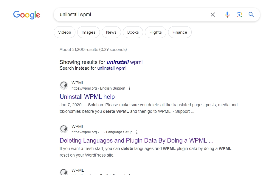

"It is not up to WPML to warn clients, nor I am aware that other plugin and theme developers warn their client on not to delete database tables directly, this is more of a common WordPress (and not only WordPress) knowledge."
It actually is, if you want to make your product more accessible to beginners. And no, such knowledge is not that common as you might think, especially considering how 'easy' it is to start with WordPress these days. Yes, there are warnings out there, just not always that clear, even to someone like me who's been doing this a while.
Sometimes a little white glove help is required. Not everyone thinks like a developer. 10 years on and I still have so much to learn about all this, and I'm at it pretty much every day.
So imagine how WPML looks to someone just starting out after they just Googled 'best translating plugin'. WPML usually comes up top, but with no obvious warnings that it is not for beginner website builders. Fact; it is not. With that said, it is a very powerful plugin, and we will be sticking with it, but maybe only because switching would be more work than learning how to just keep using it 😉 I think it has got to be the most advanced set of plugins I have ever worked with.
I know, I need a much better backup strategy, and I've been doing this for a while. How much of a backup strategy does an absolute beginner have?

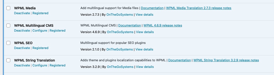

In the latest screenshot; perhaps you can include a link to 'Plugin removal instructions. Must be followed exactly'. This is assuming they are not missing any steps. Only then can you be absolved of all responsibility, if something goes wrong.
