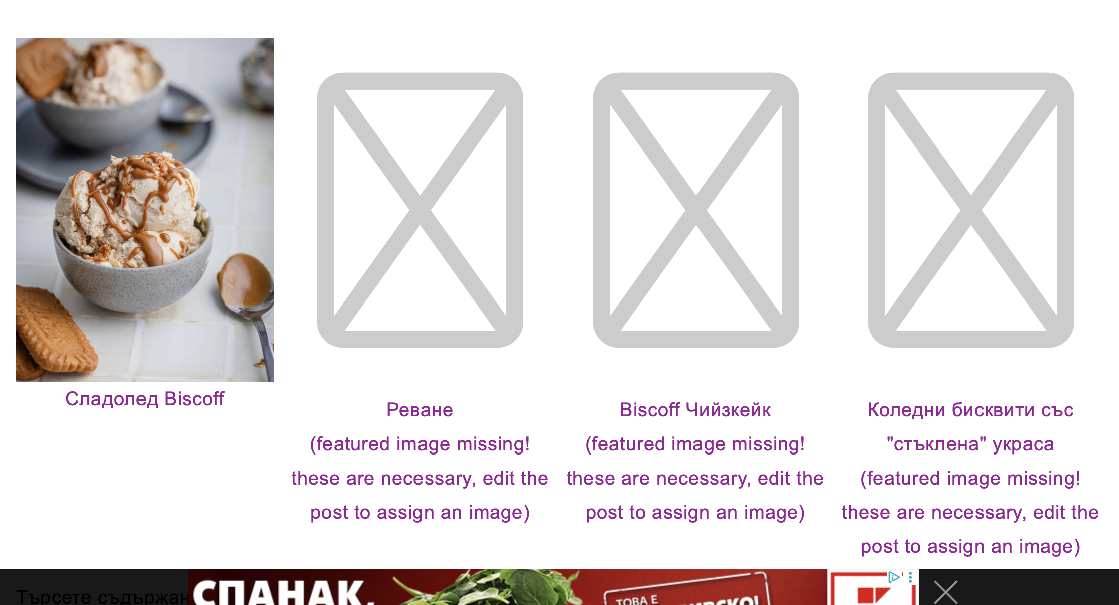

I just realized when I was posting a new post that some of my images are dissapearing in my second language (Bulgarian). They are just not in the media library there. Not sure what happened, this was not the case before.
The featured images are suddenly missing for my latest posts, please see attached.
In the latest post I had to manually translate them which made no sense but I did it, that is why one image appears on the roll.

Hi, I had another post with missing featured image: hidden link
It is an old post and I found the problem in Google search console.
I had to fix it right way because it is one of my highest performing posts and the missing featured image was ruining the SEO.
I checked other posts, so far I don't see more but that is very, very strange. The original photo was not missing in the Bulgarian media library, as long as I could see.
My only concern is why is it happening and how can we stop it from happening again.

Hi, I have another update: the latest posts that I had fixed previously, again lost their featured image in Bulgarian. I haven't fixed them. These are:
Can you please check again and if we can stop this issue from happening?

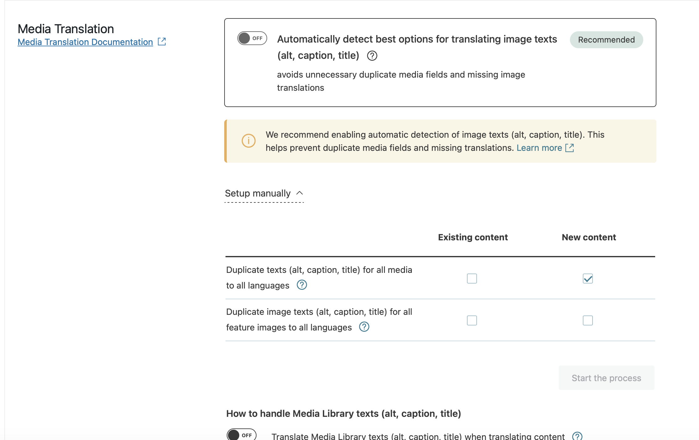

February 26, 2026 at 8:40 am #17855392
danielaL-14
For now I deactivated this button since I don't really care about translating images and alt text. I just want them to appear in both languages as they are.

Please go to WPML --> Media translation activate all the options and then click on "Start the process". I have recorder a video: hidden link
Then you can activate again "Automatically detect best options for translating image texts (alt, caption, title)"
Please let me know if that solves the issue.
