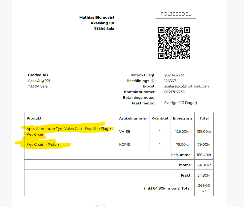

I have found an issue while printing invoice for orders. When I manually print the invoice it always give the product name in English for the first invoice even the complete template is in respective language (order received from the different language store)

I understood your point but my concern is that when I'm printing the invoice only the first invoice is printing the product name in English and other invoices are prinitng in correct languages.
Basically we have multiple lanaguages store and the invoice is printed according to user's default language from which the order is received. so when we print the invoice even if the user's lanaguage is swedish then the invoice is printed in Swedish except the Product name. I tried to debug this issue but couldn't find any break-thru.

Basically, we have created a custom plugin for printing the invoices where we are printing multiple invoices in different languages altogether. Here the case is that the invoice needs to be printed in the language in which the user has placed the order.
I have mentioned below the code through which I have printed the invoice. Please check
$order_list = [101, 102, 103, 104, 105];
foreach ($order_list as $orderId) {
$order = new WC_Order( $orderId );
foreach( $order->get_items() as $item_id => $item ) {
$itemName = $item->get_name();
Here the $order_list contains the order IDs, which are in different languages.
We are using `WC_Order` class to get the order details and when I am getting the product name it will always be in English for the first invoice i.e 101 order. even if the 101 order is in any language, it always return the product name in English and second onward it is giving correct product information. Also if we place 101 on second position in that case it is giving in correct language.
