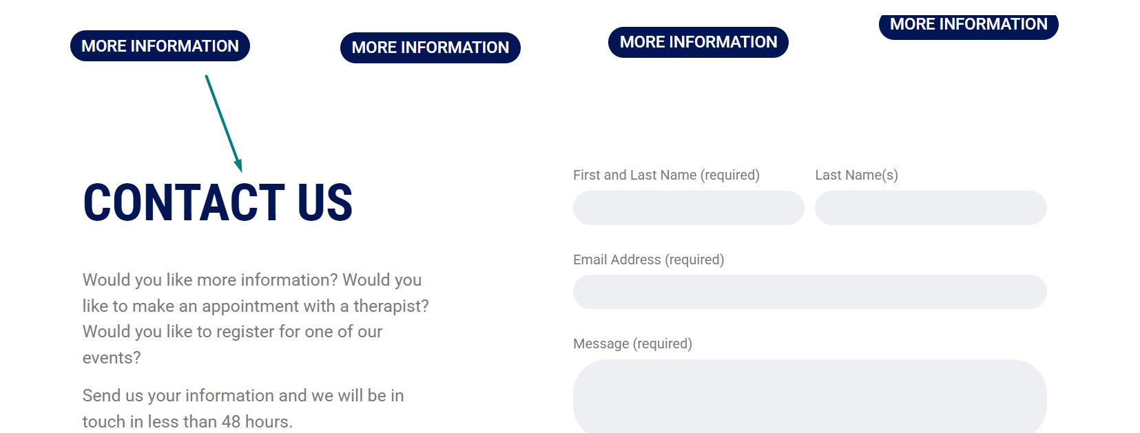

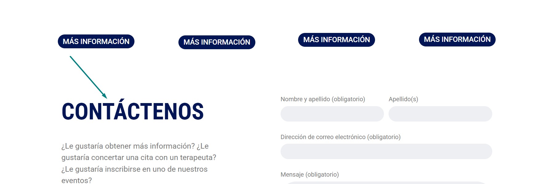

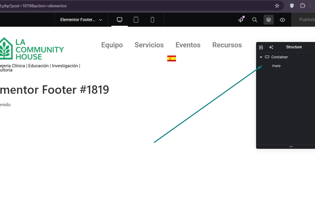

Thanks for sharing the login details. It seems the empty footer was set for the entire site. I removed it, and the correct footer now appears in all languages.
Could you please check and confirm on your side?
Thank you
