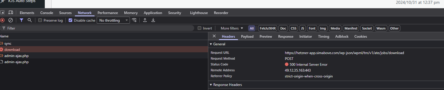

Our 2nd-tier team reviewed the issue and found that the site was blocked during the redelivery attempt. After unblocking it, they encountered a 500 error on the download endpoint. The server debug logs show multiple PHP maximum execution time errors, such as:
* Maximum execution time of 30 seconds exceeded
* Maximum execution time of 60 seconds exceeded
* Errors originating from object cache, plugins, and WPML libraries
These indicate that some processes are taking too long to execute, likely due to caching or custom code impacting performance.

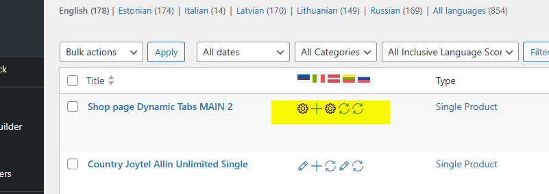

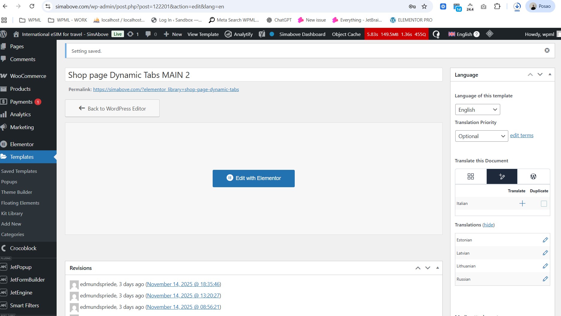

After applying the above changes, please try sending the Elementor template "Shop page Dynamic Tabs MAIN 2" for automatic translation via the Translation Dashboard.

this rest call stalls no idea why. even with lscache disabled (but lscache has noting to do with this)
{jobs: [{ateJobId: 168760487,…}], lockKey: "ab7b76a9-de0e-4532-849b-4b0bf295c206"}
jobs
0
ateJobId
168760487
ateStatus
6
jobId
17987
status
2
url
"hidden link"
lockKey
November 14, 2025 at 2:16 pm #17579449
elvisL-3
i also see wpml requests timing out , but they should not timeout so i cannot increase limits as it will oveload server. will try to setup staging server

If I check hidden link or hidden link, it looks that the translation did got through, or?
Is there any other template or other post type where it fails?
