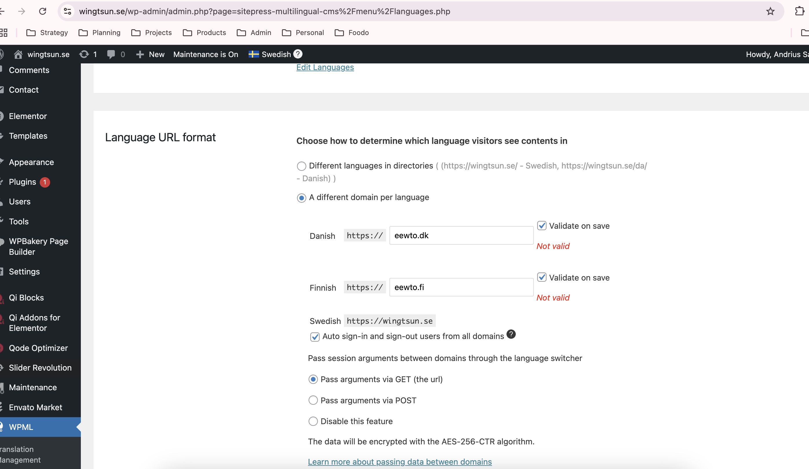

I’m currently configuring WPML to use a different domain per language. The Danish domain (hidden link) and Finnish domain (hidden link) are marked as 'Not valid', even though they are correctly entered and point to the appropriate servers. The Swedish domain (hidden link) is working correctly. I’ve enabled 'Validate on save' for both non-working domains, but it still returns the error. All domains are properly configured in DNS and accessible via browser. SSL certificates are active and working as expected. I’ve tried clearing WPML cache, re-checking domain DNS and SSL status, saving settings with and without validation enabled, and verifying domain accessibility directly in the browser.
Domains for Danish and Finnish are marked as 'Not valid' in WPML.
Could you please help identify why these domains are showing as invalid?
How can I fix the issue with the domains being marked as 'Not valid'?

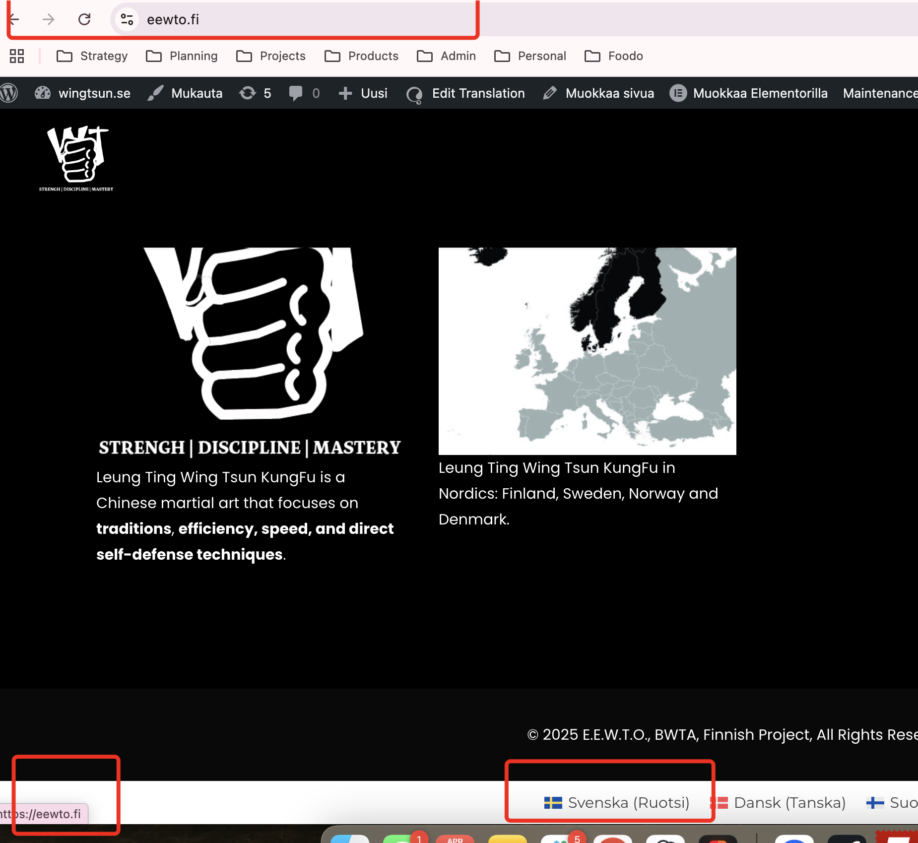

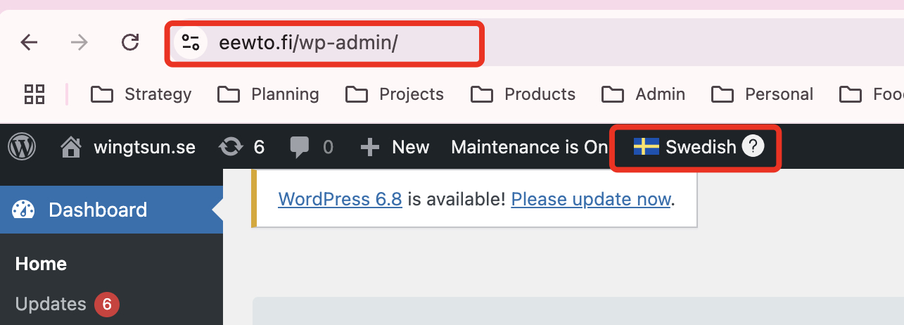

The code lines were removed, but the issue remains. When changing the language in the footer, it still redirects to the .fi domain instead of returning to the root domain of wingtsun.se. Also this is changed in backoffice automatically.

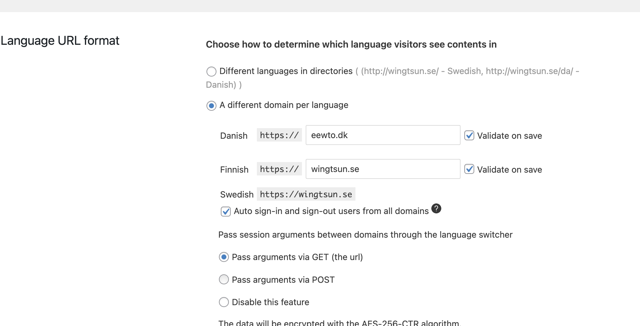

Additionally, I’ve observed that the issue persists when selecting a language-specific domain (e.g., .se/dk or .se/fi). In these cases, WPML still overrides the main domain to .fi (the Finnish version), regardless of the selected configuration.
This suggests that the issue is more global and likely tied to WPML itself, rather than the multi-domain setup or domain mapping.

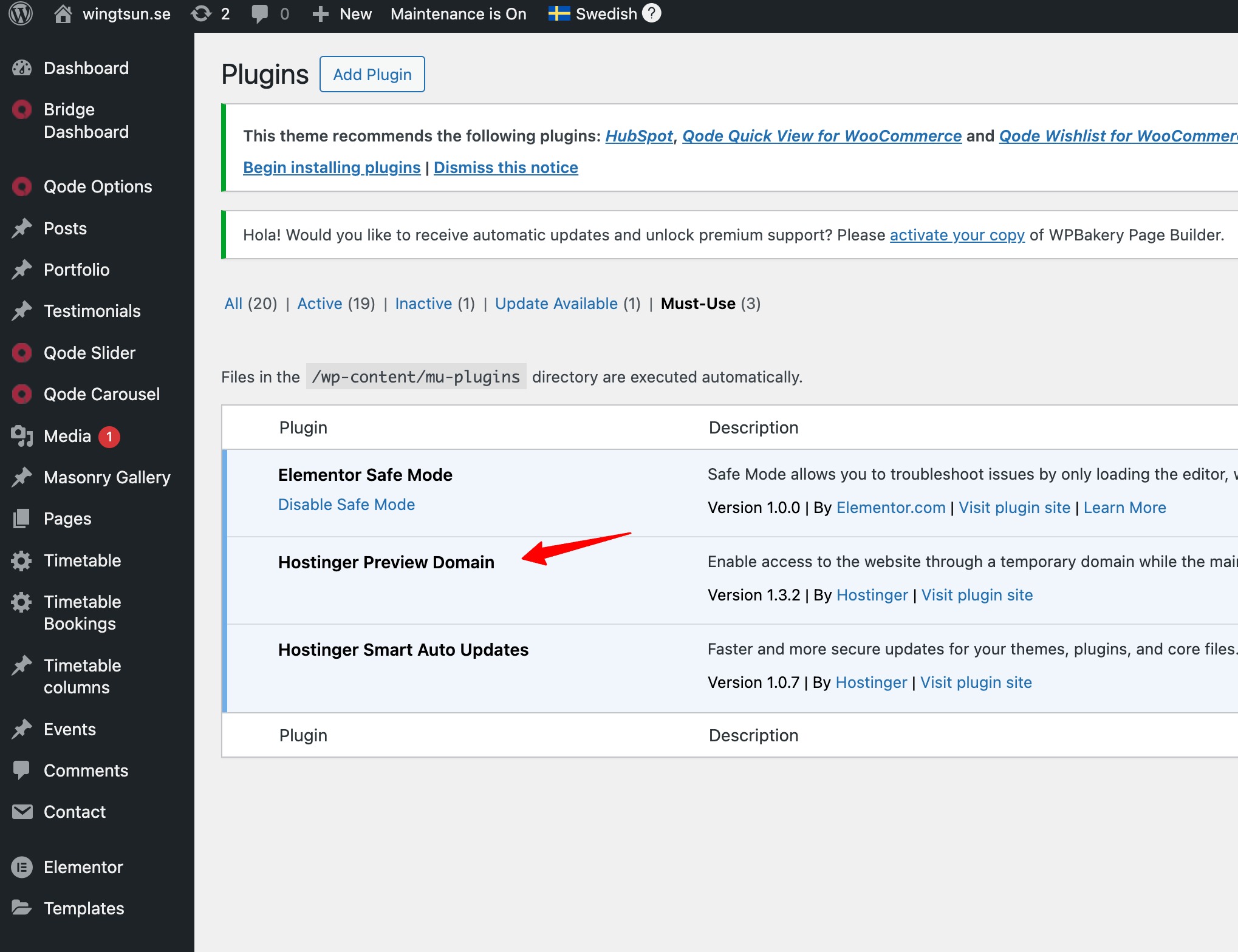

We have had the same issue and reports from clients, it is a known issue, and the solution for now is to disable that plugin, as I have said. If you are not sure how to do it, you can provide me with FTP access and I can do it for you.
Image attached, so you can see the plugin is used on your website.

Yes, it worked. As you mentioned in your last message, that module wasn’t under the main modules but in the MU Plugins section. Thanks for your help!
