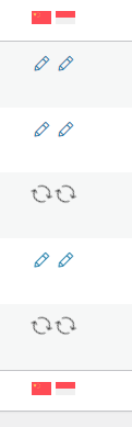

On some pages the status refresh translation never finishes and keeps loading

Thank you for contacting WPML support, I’m happy to help you with this issue.
The translation should be done in a few seconds/minutes. If it takes a long time to complete, there should be an issue that causes the translation stuck.
Please try to enable a minimal environment as below, re-translate the page and see if it helps.
- Deactivate all non-WPML plugins
- Switch to a standard theme of WordPress
If it persists, you can go to WPML > Support > Advanced Translation Editor > Share some screenshots of the recent error logs with me.
Refer documentation https://wpml.org/faq/translation-status-stuck-or-displaying-the-error-wpml-didnt-manage-to-translate-this-page/
Look forward to your reply.

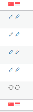

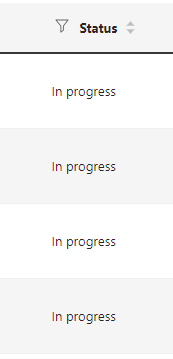

Some pages have been successfully translated, but there is 1 page (product) that has not completed the translation process

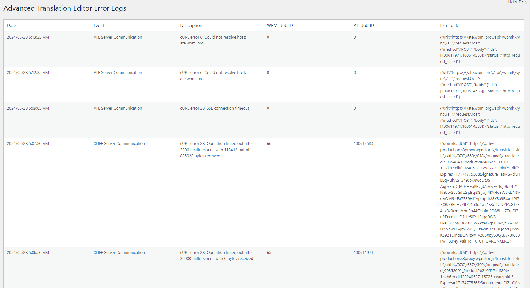

The product page has a large content to translate in the Advanced Translation Editor and it takes time to deliver the translation to your site. I see there is an error in the log that indicates the lack of PHP setting max execution time on your site.
[29-May-2024 07:07:57 UTC] PHP Fatal error:  Maximum execution time of 30 seconds exceeded in /home/ridaresi/public_html/wp-content/plugins/sitepress-multilingual-cms/vendor/wpml/collect/src/Illuminate/Support/Traits/Macroable.php on line 56
then I add the following code to the file wp-config.php to increase this PHP setting value
set_time_limit(300);
now you can see the page Products is translated completely.
