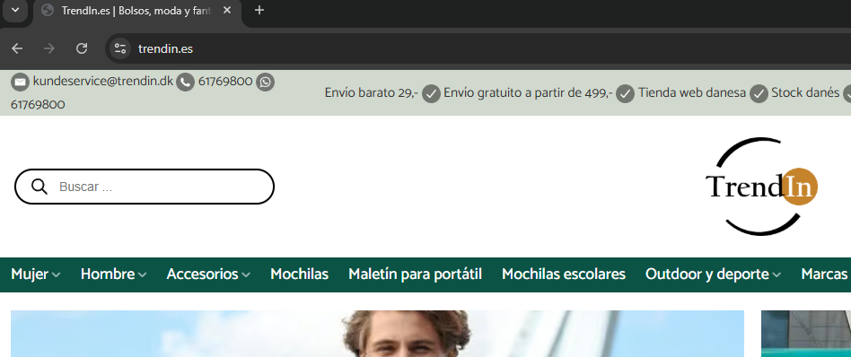

October 22, 2025 at 4:37 pm #17509234
Thanks for your reply. I've translated the Search form here hidden link... and it works fine as shown in the attached screenshot.
However, there appears to be a cache-related issue, as it is not displaying the correct string on the frontend yet.

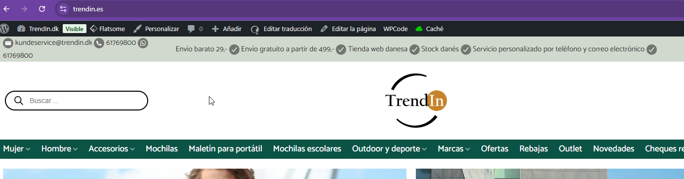

October 23, 2025 at 6:29 am #17510877
Thanks for your reply. Sorry, I focused on explaining how to translate the search form field and overlooked your question about the glossary. The glossary is only used within the Advanced Translation Editor and doesn’t apply to translating strings that appear on your website. You can learn more about it here: https://wpml.org/documentation/translating-your-contents/advanced-translation-editor/how-to-create-and-manage-glossary-entries/
I’ve cleared the cache several times, and it’s displaying correctly now. I also checked using an incognito browser, as shown in the attached screenshot. Please note that strings on your website can only be translated through the String Translation, while your page and post contents should be translated using the Advanced Translation Editor.

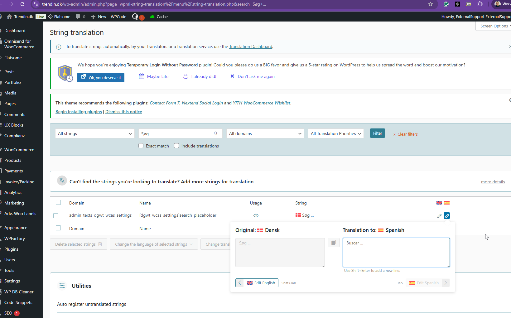

Thanks for your reply. You cannot translate strings using Glossary, and I'm not sure why your changes are not saving. Are you able to replicate this again?
So, what I've done is to search for the string using the String translation here hidden link and translate it. I did not do anything else other than this.
