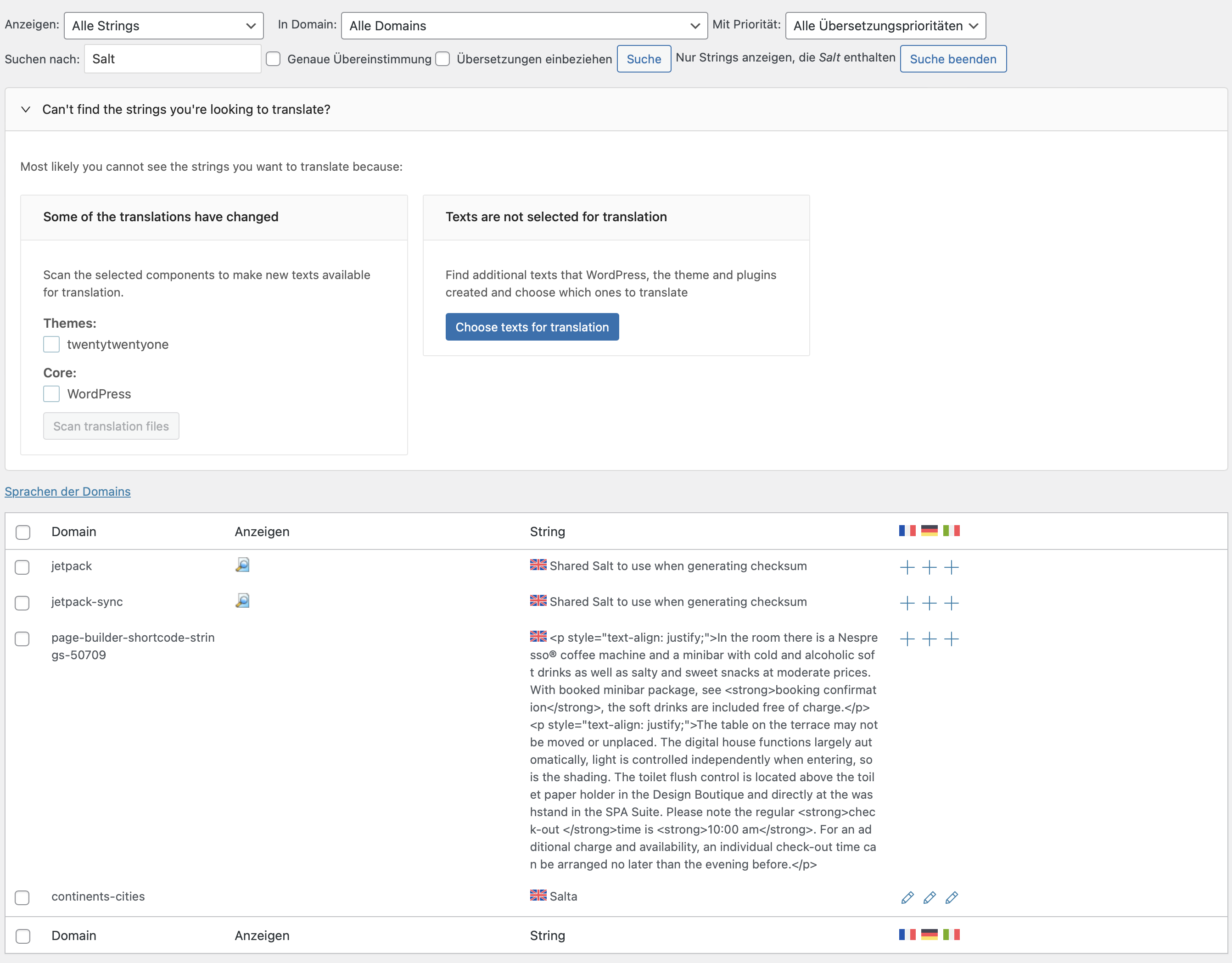

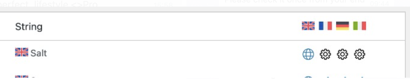

I had a problem with the term salt, it was always displayed with the gears and couldn't be edited. Then I removed it from the strings and now I can't add it anymore. What happened. Can someone please give me heroes?
This article didn't help.
https://wpml.org/de/documentation-3/ratgeber-zum-loslegen/string-ubersetzung/finden-von-strings-die-nicht-auf-der-string-translation-seite-erscheinen/

Hi there, Tobias.
Go to WPML > String Translation and at the bottom of the page you will find a checkbox called "Look for strings while pages are rendered". You can enable (check) that and then go in the front end to a page where you have that string showing up (and refresh the page 1-2 times) and then go back to WPML > String Translation and search for that string and see if it now shows up (refresh the page a couple times before searching).
It should show back in WPML > String Translation now.
