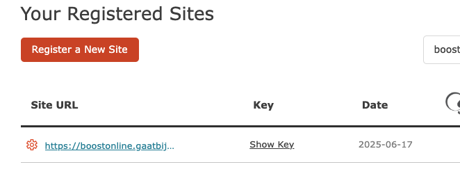

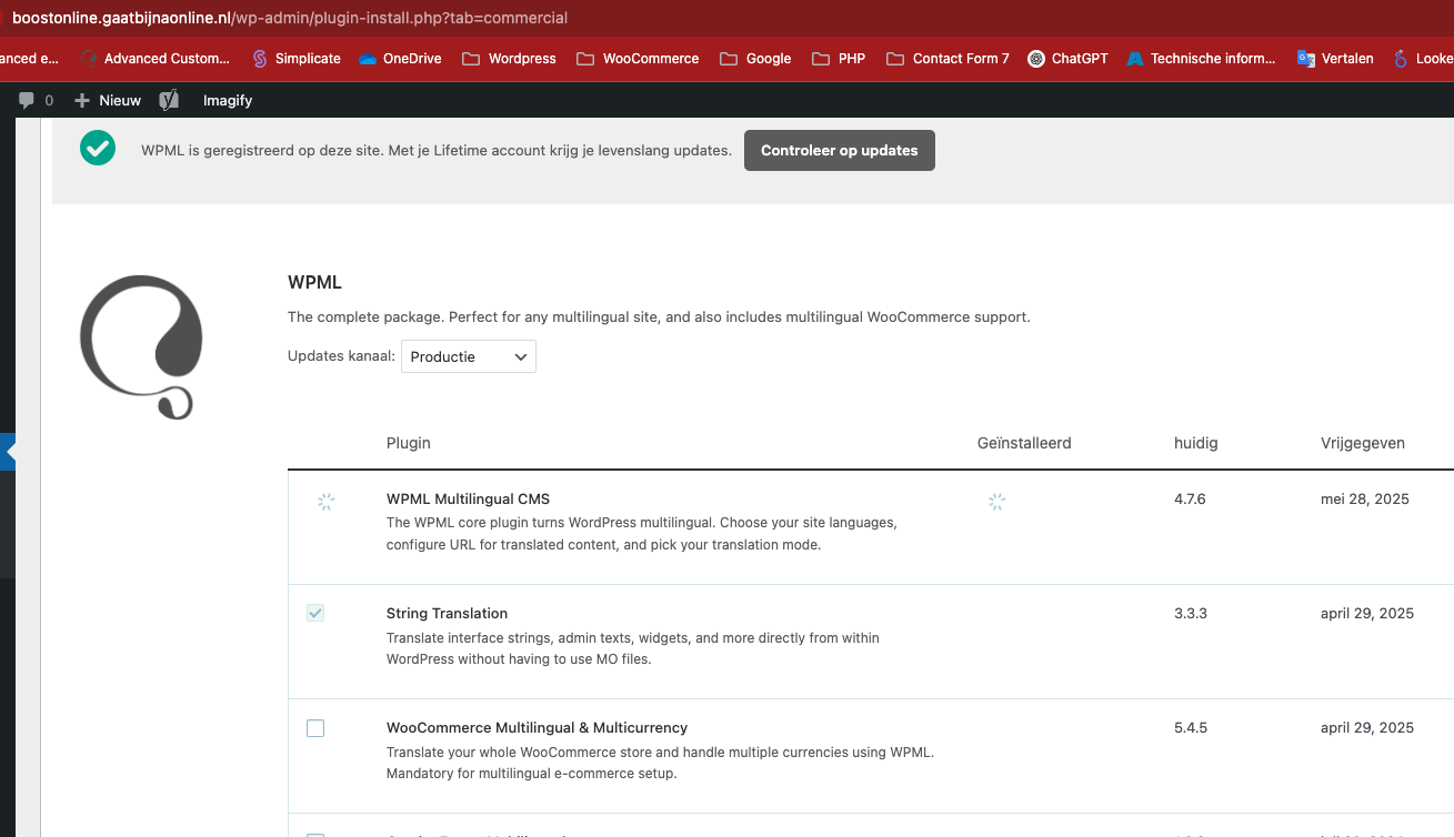

I have not done any changes and am installing the OTGS plugin where it asks for the register key. I have created this first - as shown in screenshot. Then I go back to my site and click the packages I want to install. Once again (with a completely new setup) this did not work. The rotating 'loading' icon just keeps going and going, even after 30 minutes, as shown in second screenshot.
As the site is new, there is no registry key to delete. I create it for the first time, or are you saying to create the key, then delete the key and re-create it?
