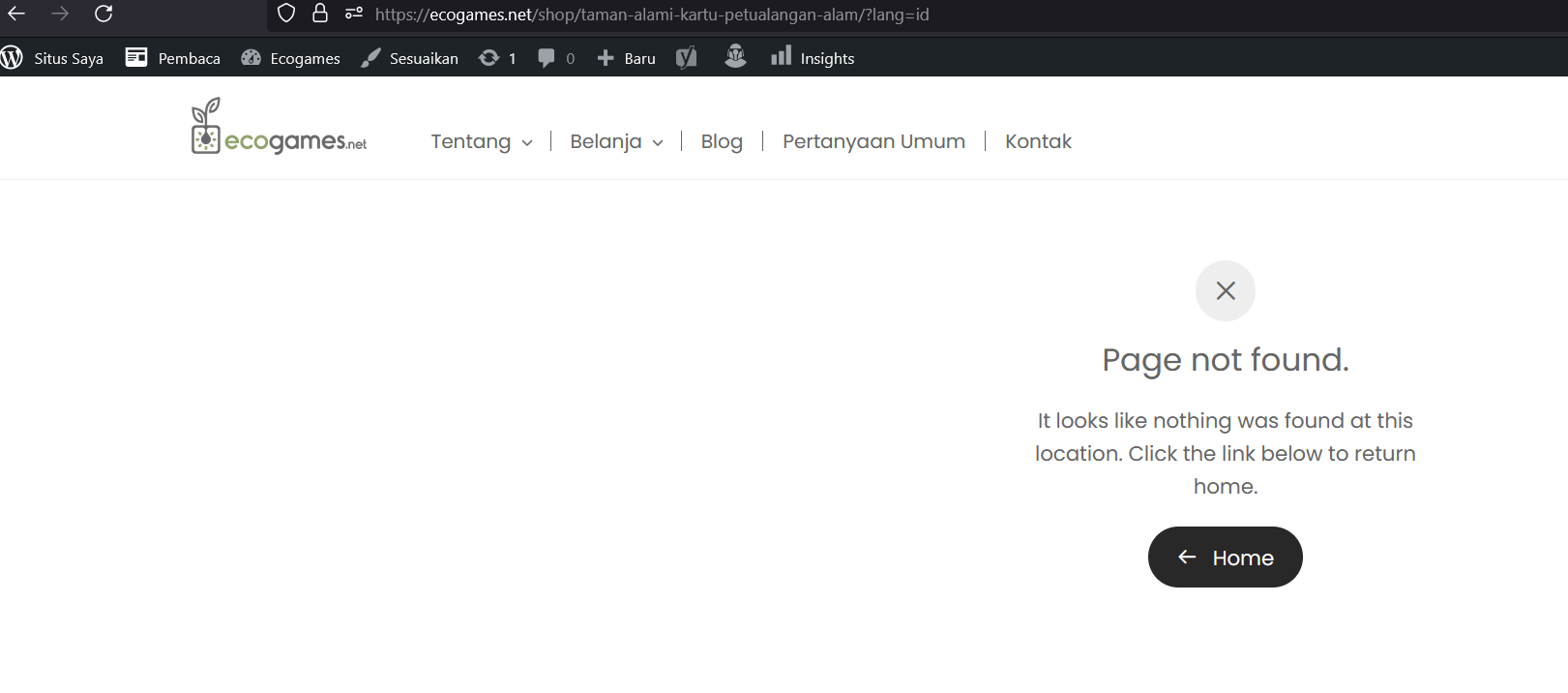

Multi-Language is only working on plain URL

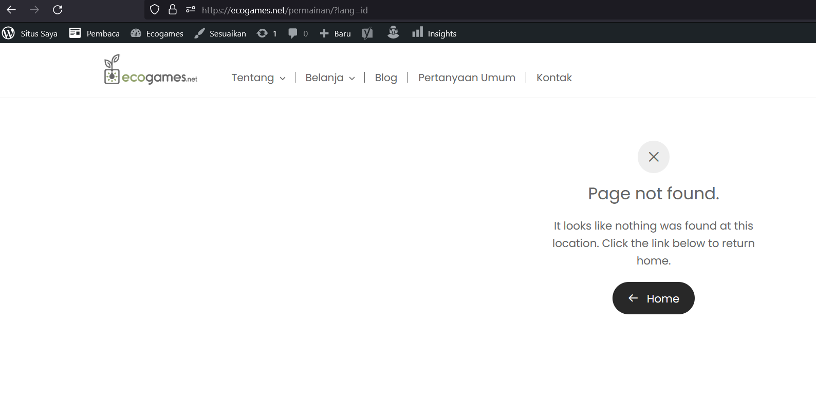

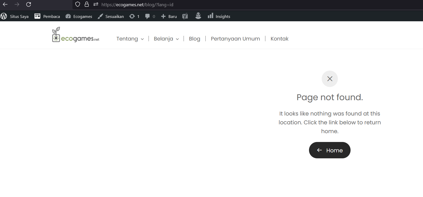

It works for the homepage only.
Could you have a check the inside page,
ex: hidden link

When I checked the WordPress setting on your site, I noticed that the REST API is currently not enabled. Please check this screenshot: hidden link
When I tried to access WP-JSON from the Indonesian language, I also encountered a page not found error. This configuration could be causing the issue with Certain Indonesian translations.
You can also check that by going to "WPML > Support" and scrolling down to the "WordPress" section. If you try to access hidden link, you should receive a JSON response, which is not happening in your case.
