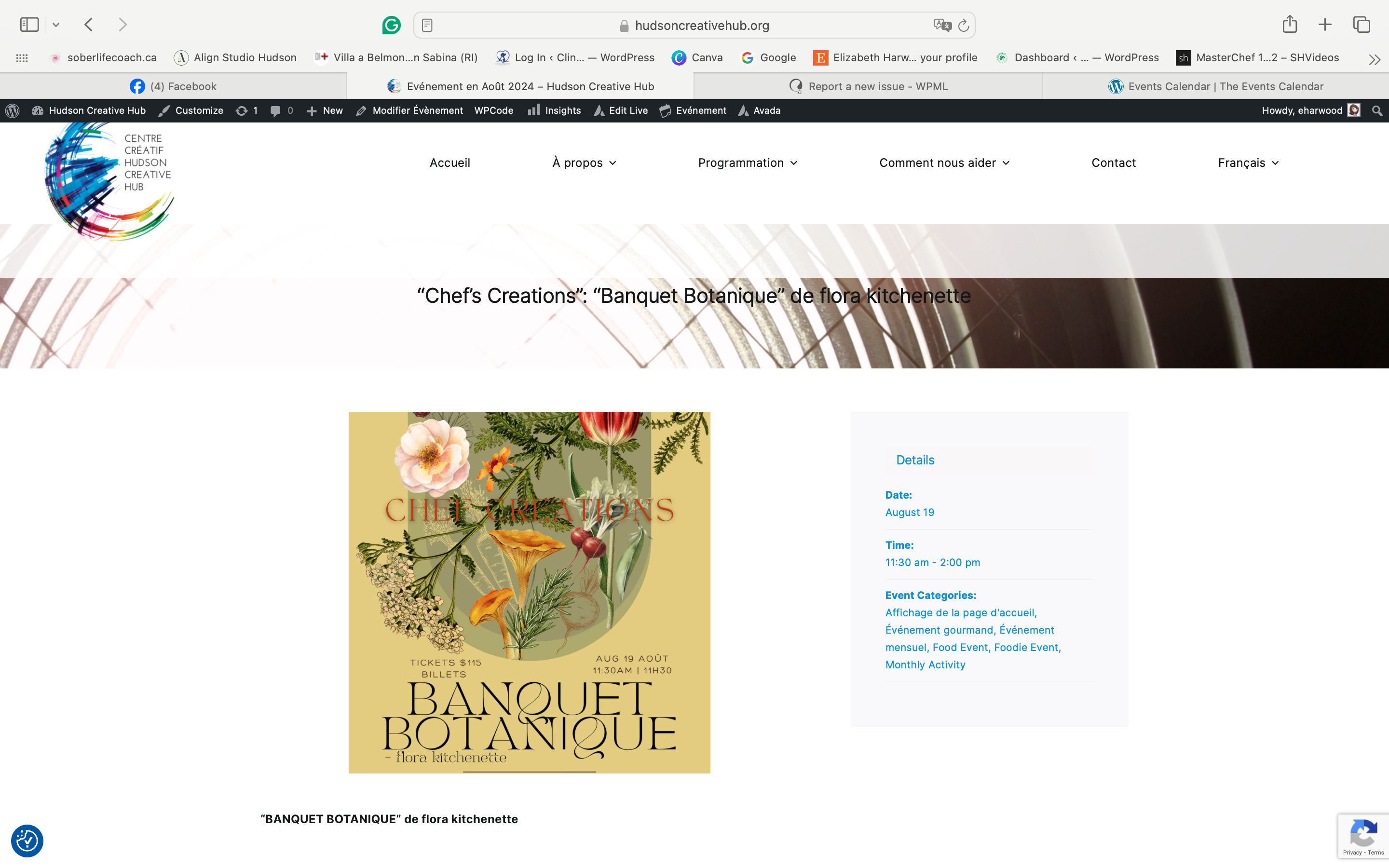

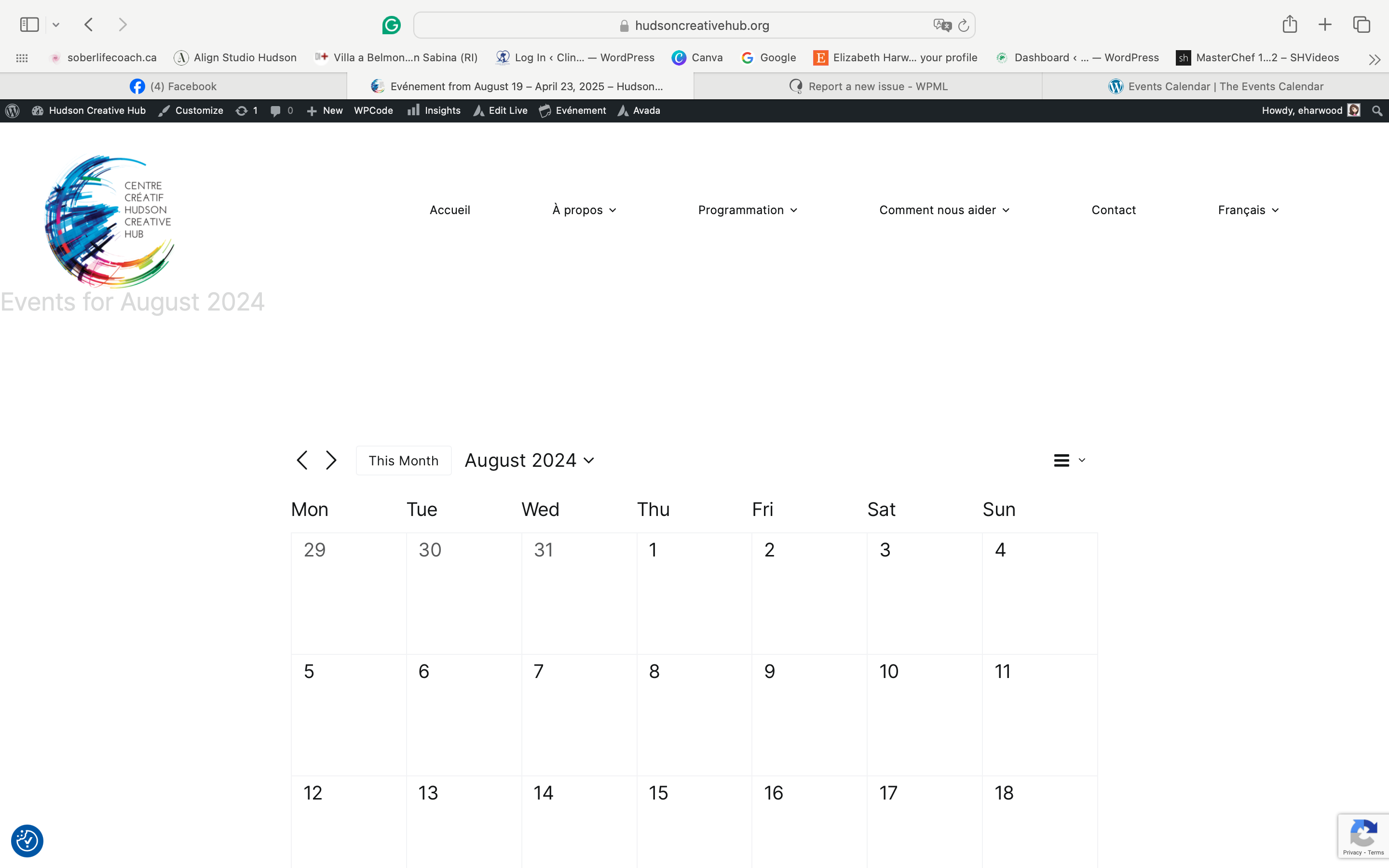

Only part of our events Calendar is translating. The additional information box is not translating.
We have added the string translations, and it still appears in English, instead of french as expected.
We have contacted the Support from the plugin "Events Calendar" say we should reach out to you as it should be compatible with their plugin. As part of the plugin elements are translating.

I was able to observe the issue and found that it mostly works fine with 2024 theme, while issue happens when switched to Avada theme.
