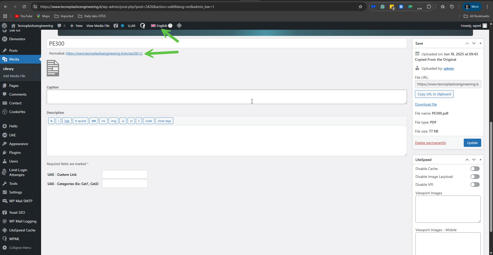

I've found out the correct link to the English PDF is, for example, this:
hidden link. Please notice the -2 at the end of the URL. You can also see it on the media attachment post here: hidden link. You will need to click 'Translate Anyway'. Please see the attached screenshot.
So, as I mentioned, it works on my test site. I'm unsure why it is not working on your site. I need your permission, please, to proceed with the things I requested in my previous reply.

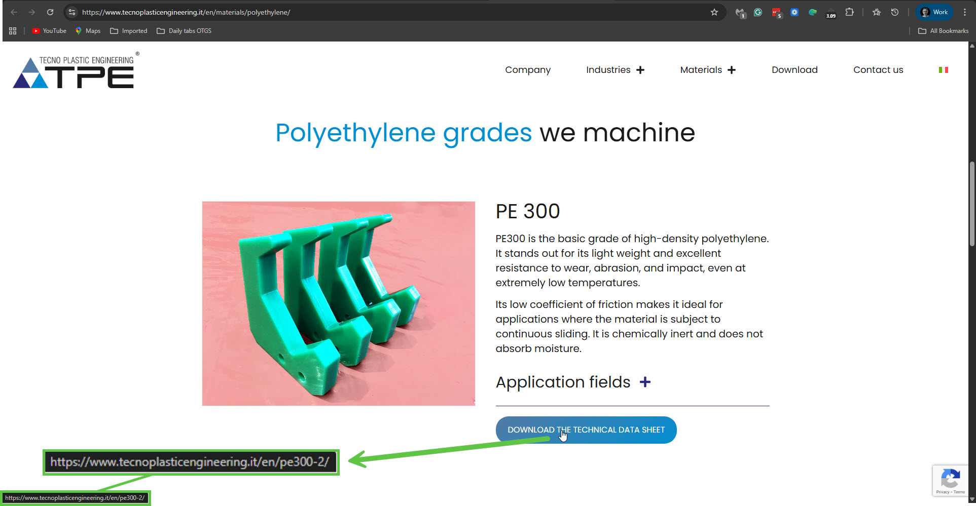

Currently, I can see that the links to the PDF files on the English version of your site work. Please see the attached screenshot. I assume you have either applied the workaround or have found the fix for this problem. Is everything alright regarding this issue now?
