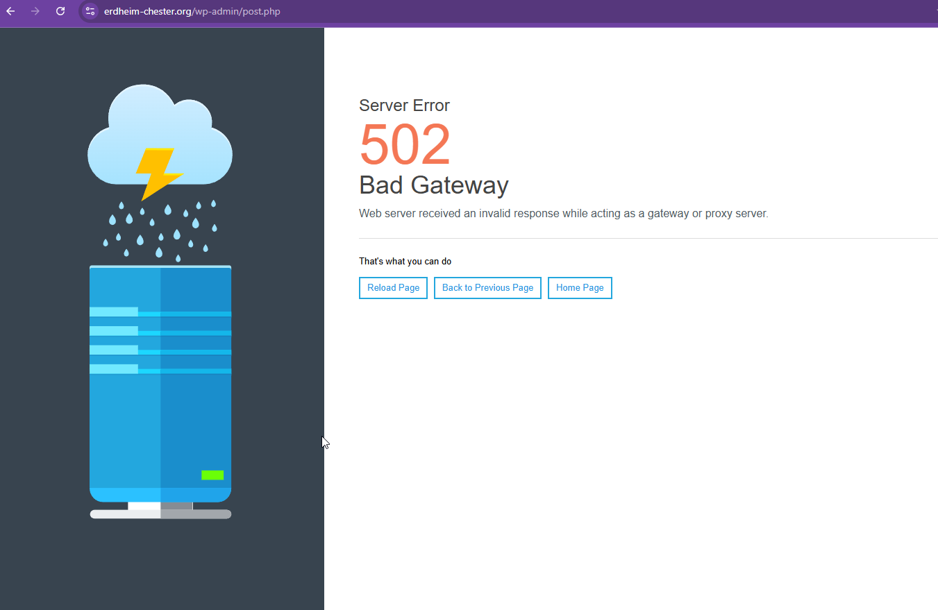

Thanks for your reply. I'm getting "502 Gateway" when I try to update this page hidden link as shown in the attached screenshot.
