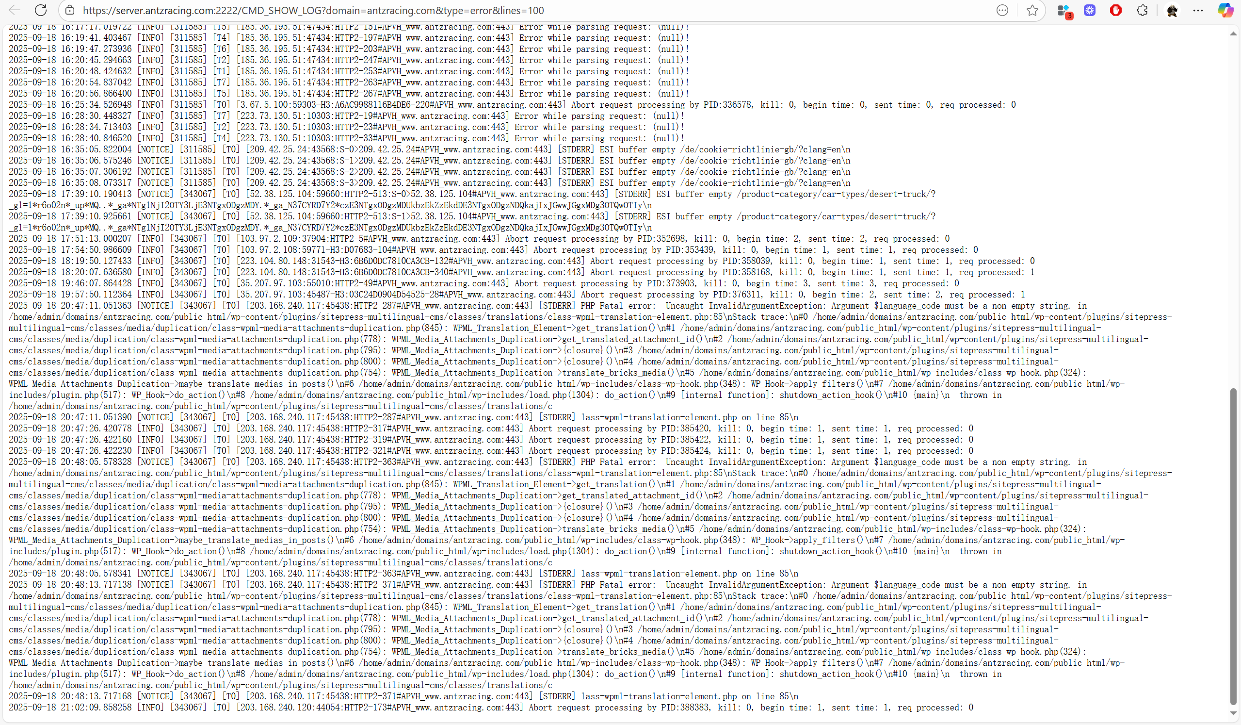

This morning, I found this error log and there are a lot of logs since Sept 7. Please check if it's related and how to fix it:

A lot of errors in server log, and new error notification in WPML dashboard. I am scared.

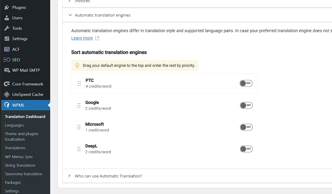

There is a language mapping issue on your site, and languages can not be mapped, as all translation engines are disabled.
If you want to continue using automatic translation, you need to activate at least one translation engine at WPML > Translation Dashboard > Translation Tools > Automatic translation engines.
After enabling at least one engine, please map the languages again at WPML > Translation Dashboard > Translation Tools > Language mappings.
If this will not solve the issue, please let me know.

I followed the guide and solved the mapping issue. But this seems to be a bug that I can't disable all the translation engines which will cause the mapping issue.

Indeed, this seems to be a bug or a UI issue, as you should not be able to disable all translation engines while automatic translation is enabled on the site.
Examples:
- site has available credits or a subscription for Pay-As-You-Go
- the feature "Translate Everything Automatically" is enabled
- The Advanced Translation Editor is enabled to translate everything automatically by default
If any of these criteria are met, you usually should not be able to disable all translation engines.
