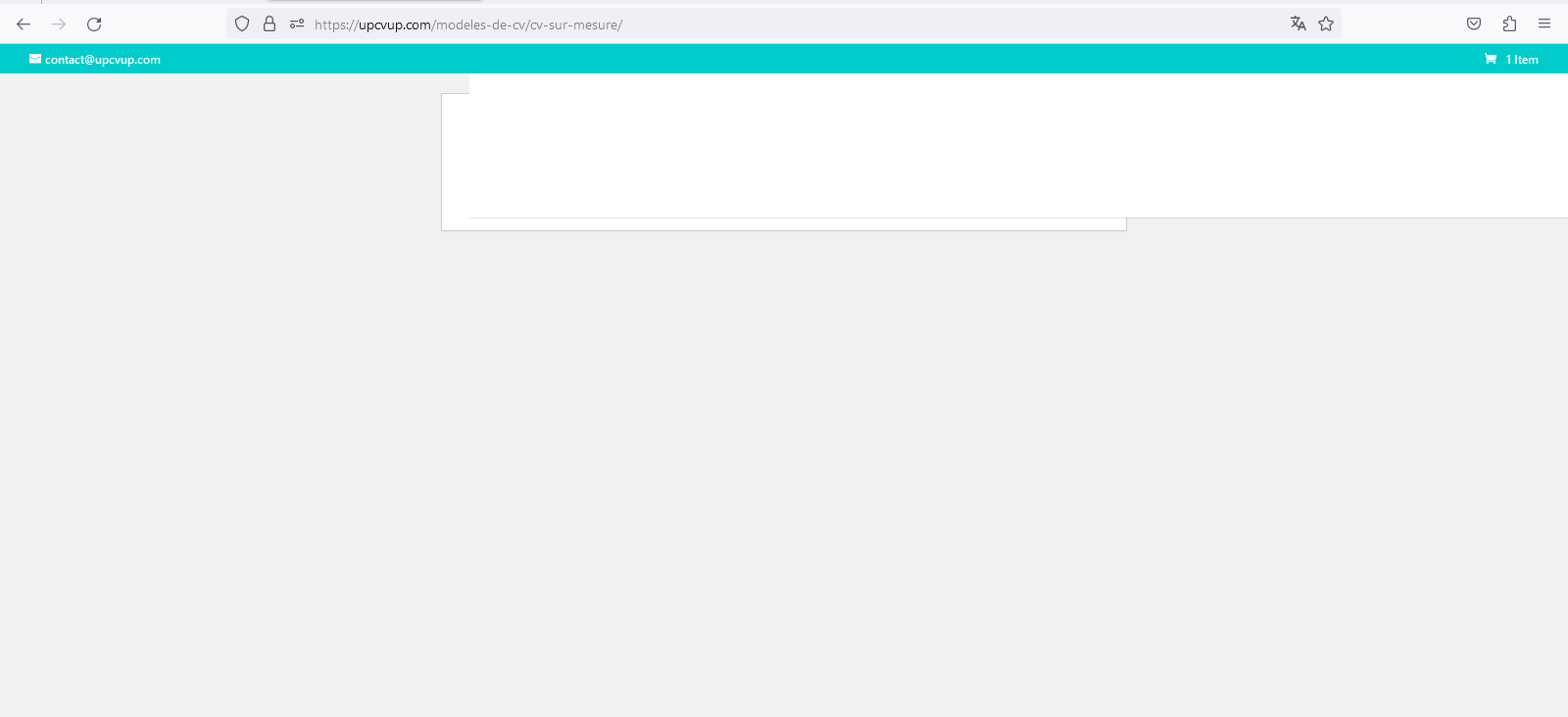

Hello guys,
I purchased to WPML today, I installed the plugin and when I activate WPML Multilingual CMS the whole website went down
Could you please help 🙂

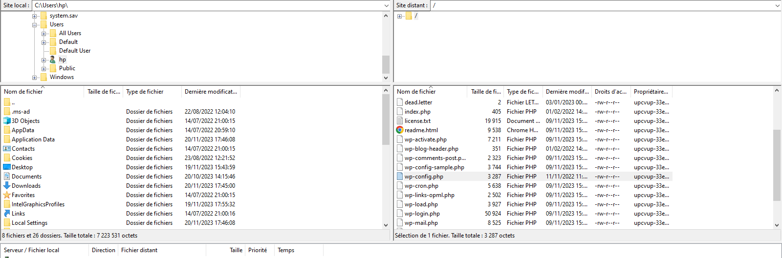

November 20, 2023 at 6:39 pm #14880295
saadS-7
Hi Marcel,
Thank you so much for your reply.
I finaly found my wp-config.php through FileZilla (see the photo attached) but I cannot open it so I can do the following :
1 define('WP_DEBUG', false);
Change to:
1 define('WP_DEBUG', true);
2 define( 'WP_DEBUG_LOG', true );
3 define( 'WP_DEBUG_DISPLAY', true );
Could you please help. Thank you again in advance.
Best Regards.
Saâd
November 20, 2023 at 6:43 pm #14880421
Marcel
Hi Saâd,
You can right-click on the file in FileZilla and select "View/Edit". This will download a temporary local copy of the file and open it with your chosen configured editor. The local copy is necessary as FTP files cannot be opened directly on the server. Once you save and close the file, it will ask you if you want to upload and overwrite the existing file.
Best Regards
Marcel
November 22, 2023 at 8:39 am #14893727
Marcel
Hi
I marked your reply as private as you exposed your DB credentials in our public forum.
You can search in the file for "/* That's all, stop editing! Happy publishing. */" and add directly ABOVE.
If you need further assistance activating the debug.log, I might need access to your FTP to activate it for you. But if you add these constants as mentioned, the site will not go down :).
Best Regards
Marcel

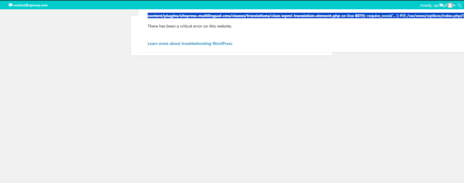

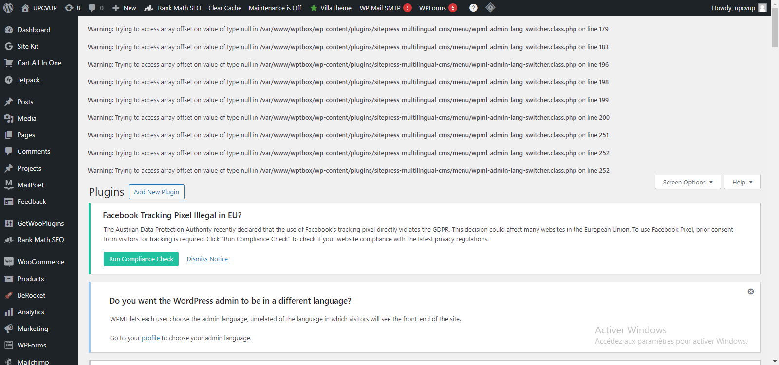

November 22, 2023 at 1:04 pm #14897689
saadS-7
Hi Marcel,
Thank you for your help and support.
I followed the septs above. And after reactivating the plugin the website went down again.
Please see attached the screeshots.
Thank you in advance for your patience.
Kind regards.
Saâd

November 24, 2023 at 11:22 am #14916287
saadS-7
Good morning Marcel,
I hope that you are doing well.
Here's the error log :
[22-Nov-2023 11:14:05 UTC] PHP Warning: Trying to access array offset on value of type null in /var/www/wptbox/wp-content/plugins/sitepress-multilingual-cms/menu/wpml-admin-lang-switcher.class.php on line 179
[22-Nov-2023 11:14:05 UTC] PHP Warning: Trying to access array offset on value of type null in /var/www/wptbox/wp-content/plugins/sitepress-multilingual-cms/menu/wpml-admin-lang-switcher.class.php on line 183
[22-Nov-2023 11:14:05 UTC] PHP Warning: Trying to access array offset on value of type null in /var/www/wptbox/wp-content/plugins/sitepress-multilingual-cms/menu/wpml-admin-lang-switcher.class.php on line 196
[22-Nov-2023 11:14:05 UTC] PHP Warning: Trying to access array offset on value of type null in /var/www/wptbox/wp-content/plugins/sitepress-multilingual-cms/menu/wpml-admin-lang-switcher.class.php on line 198
[22-Nov-2023 11:14:05 UTC] PHP Warning: Trying to access array offset on value of type null in /var/www/wptbox/wp-content/plugins/sitepress-multilingual-cms/menu/wpml-admin-lang-switcher.class.php on line 199
[22-Nov-2023 11:14:05 UTC] PHP Warning: Trying to access array offset on value of type null in /var/www/wptbox/wp-content/plugins/sitepress-multilingual-cms/menu/wpml-admin-lang-switcher.class.php on line 200
[22-Nov-2023 11:14:05 UTC] PHP Warning: Trying to access array offset on value of type null in /var/www/wptbox/wp-content/plugins/sitepress-multilingual-cms/menu/wpml-admin-lang-switcher.class.php on line 251
[22-Nov-2023 11:14:05 UTC] PHP Warning: Trying to access array offset on value of type null in /var/www/wptbox/wp-content/plugins/sitepress-multilingual-cms/menu/wpml-admin-lang-switcher.class.php on line 252
[22-Nov-2023 11:15:23 UTC] PHP Fatal error: Uncaught InvalidArgumentException: Argument $language_code must be a non empty string. in /var/www/wptbox/wp-content/plugins/sitepress-multilingual-cms/classes/translations/class-wpml-translation-element.php:80
Stack trace:
#0 /var/www/wptbox/wp-content/plugins/sitepress-multilingual-cms/vendor/wpml/fp/core/Maybe.php(106): WPML_Translation_Element->get_translation()
#1 /var/www/wptbox/wp-content/plugins/sitepress-multilingual-cms/classes/language-switcher/class-wpml-ls-settings.php(397): WPML\FP\Just->map()
#2 /var/www/wptbox/wp-content/plugins/sitepress-multilingual-cms/classes/language-switcher/class-wpml-ls-settings.php(407): WPML_LS_Settings->{closure}()
#3 /var/www/wptbox/wp-content/plugins/sitepress-multilingual-cms/classes/language-switcher/class-wpml-ls-render.php(144): WPML_LS_Settings->get_menu_settings_from_id()
#4 /var/www/wptbox/wp-includes/class-wp-hook.php(326): WPML_LS_Render->wp_get_nav_menu_items_filter()
#5 /var/www/wptbox/wp-includes/plugin.php(205): WP_Hook->apply_filters()
#6 /var/www/wptbox/wp-includes/nav-menu.php(762): apply_filters()
#7 /var/www/wptbox/wp-includes/nav-menu-template.php(151): wp_get_nav_menu_items()
#8 /var/www/wptbox/wp-content/themes/Divi/header.php(283): wp_nav_menu()
#9 /var/www/wptbox/wp-includes/template.php(790): require_once('...')
#10 /var/www/wptbox/wp-includes/template.php(725): load_template()
#11 /var/www/wptbox/wp-includes/general-template.php(48): locate_template()
#12 /var/www/wptbox/wp-content/themes/Divi/page.php(3): get_header()
#13 /var/www/wptbox/wp-includes/template-loader.php(106): include('...')
#14 /var/www/wptbox/wp-blog-header.php(19): require_once('...')
#15 /var/www/wptbox/index.php(17): require('...')
#16 {main}
thrown in /var/www/wptbox/wp-content/plugins/sitepress-multilingual-cms/classes/translations/class-wpml-translation-element.php on line 80

November 24, 2023 at 4:31 pm #14919705
Marcel
the Fatal error message in the log was helpful. You are already running the latest version, so you can try to solve it using the mentioned troubleshooting options as described here: https://wpml.org/forums/topic/php-fatal-error-uncaught-invalidargumentexception-argument-language_code-must-be-a-non-empty-string-2/#post-11497417.
More information about WPML troubleshooting options can be found here: https://wpml.org/documentation/support/wpml-troubleshooting-options/.
Please remember to back up your site before starting those actions.
