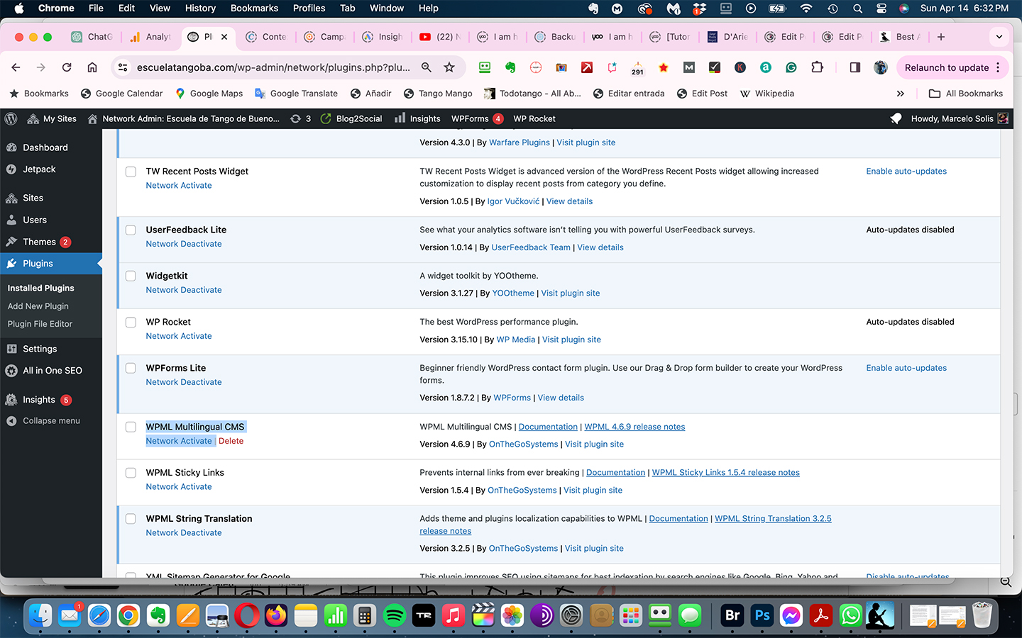

April 15, 2024 at 1:39 am #15516876
Marcelo Solis
Tell us what you are trying to do? I am trying to network activate WPML Multilingual CMS.
Is there any documentation that you are following? No.
Is there a similar example that we can see? Yes. I attached an image. This is a WordPress Multisite.
What is the link to your site? hidden link

Thank you for sharing the error log. I have thoroughly inspected the log file and did not find any issues originating from WPML or its add-ons in the stack traces. The majority of the fatal errors are being generated by the "MarceloSolis" theme, specifically from the file `templates/post/content.php:12`.
Here is the full stack trace: `PHP Fatal error: Uncaught Error: Call to a member function get() on null in /www/wp-content/themes/MarceloSolis/templates/post/content.php:12`.
Since the fatal error appears to be coming from the theme, could you please switch to a default theme like "Twenty Twenty-One" and check if the issue with activating the WPML Plugin persists? This will help determine if the problem is specifically related to the theme.
If the issue persists even after that, you can download the latest version of WPML(4.6.10) from your WPML.ORG account(https://wpml.org/account/downloads/) and then try to install and activate the plugin.
Let me know how it goes. I will be happy to help if you need further assistance in this matter.

By clicking on the "Download WPML Manually" link (Screenshot: hidden link) from the Downloads page, you'll be able to access the latest version of WPML and its add-ons. Please download the most recent version of WPML from there.
Once you have installed the latest version, please try to activate it and check if you're still having the issue.
If the problem continues, it might be due to a conflict between plugins. I kindly request you to deactivate all plugins on your site, and then try activating WPML and the String Translation. If the activation is successful, you can gradually reactivate the other plugins. Please ensure you take a backup of your site before proceeding with these steps.

Marcelo Solis
Problem solved!
