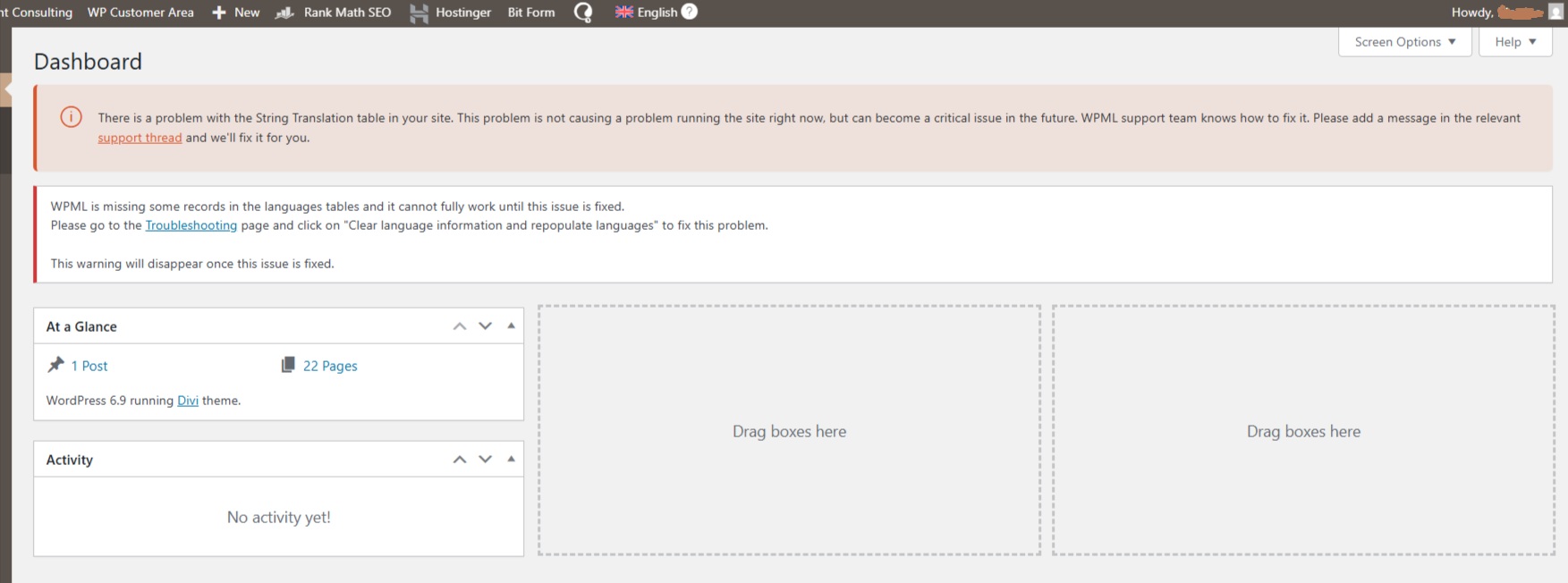

I just created a ticket but after skipping the debug info screen (which I can't access - fatal error) I was brought to an empty ticket screen and I have no past tickets ... Guess that was another fatal error?
Anyway. These errors won't solve, and I can't do anything else due to fatal errors. My site content isn't shown anymore either on the front- or backend.
For now I'm renaming the plugin so I can access my site again and I'll wait a bit for support although I honestly regret going for WPML instead of Polylang as I had planned before being convinced this plugin would be "easier and better" 🙁

See attachment for the errors on the main screen.
After that, it was only fatal errors.

I'm back to this error now:
WPML is missing some records in the languages tables and it cannot fully work until this issue is fixed.
Please go to the Troubleshooting page and click on "Clear language information and repopulate languages" to fix this problem.
This warning will disappear once this issue is fixed.
Clearly, it won't.
I also have no more access to my pages and the front-end is 404'ing now.
I do have access to the debug-info now -- tho again, I had add-ons active that are NOT active now.
