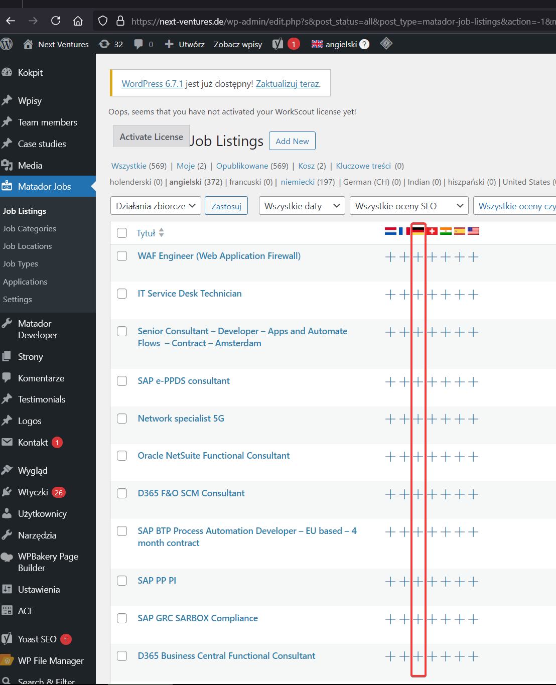

I am trying to maintain connections between translations in different languages on my site hidden link. Previously, the German version was correctly linked as a translation from English.

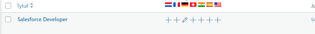

The connections between languages and their translations have disappeared for existing content, specifically in the DE column. However, new translations are working correctly.
What could be the cause of the missing connections between existing translations?
Why are new translations working correctly while existing ones are not?

As you mentioned that the translations are working on the frontend but appear disconnected in the backend, it’s possible that the language information for the German posts hasn’t been correctly propagated, causing this issue. I noticed that there are around 197 posts currently available in the German language.

I've checked and it looks like the translations are not connected at all. Not sure what causes this issue and there are a few methods we can do to troubleshoot or resolve this.
1. You can contact your hosting provider and ask them to restore the site to an earlier date so that we recheck this for you.
2. Reconnect the pages as shown in this screen recording. hidden link
3. Export both languages using the method here https://wpml.org/documentation/related-projects/wpml-export-and-import/ and then, reconnect it manually. Then, reimport it back to your Website.
Let me know what you think.
