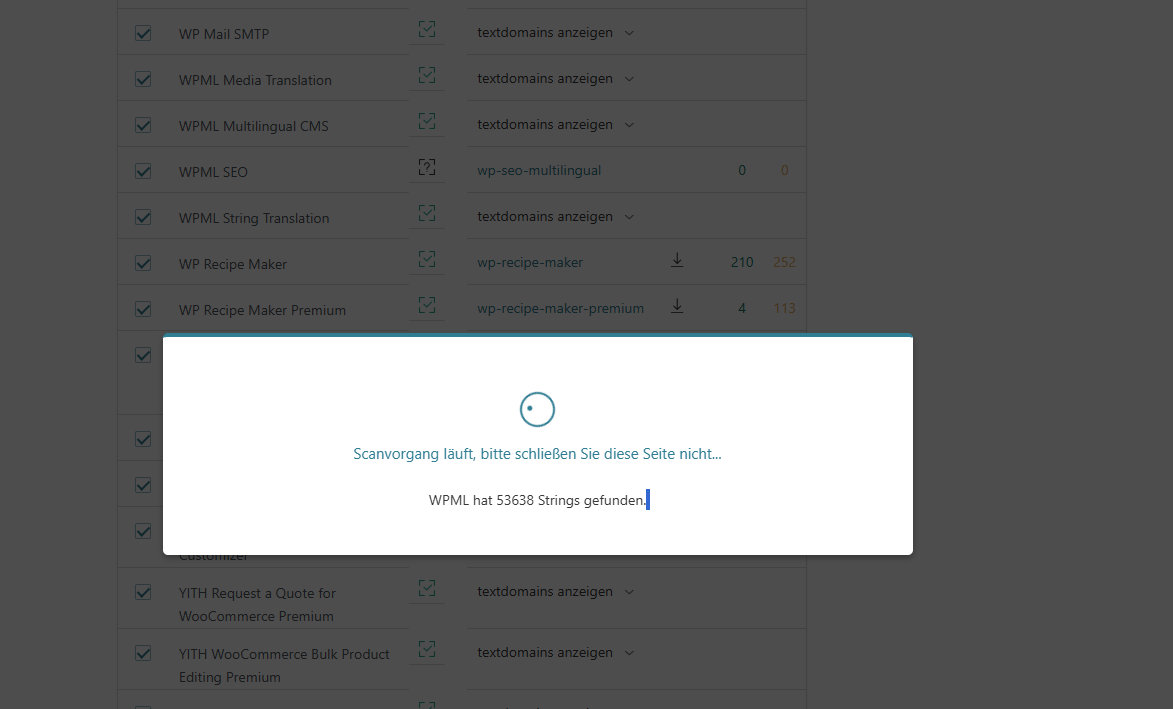

peterS-172
Hi WPML Support,
we're encountering persistent problems with the String Translation module. Specifically:
The scanning process often freezes or becomes unresponsive, even when all caches are cleared.
We have 53,638+ strings registered (see attached screenshot).
Translations don’t reliably appear in Italian or English, even after saving them.

We’ve already:
Rescanned strings
Cleared transients and caches
Updated all WPML components
Could you please advise:
Whether these _load_textdomain_just_in_time notices are critical?
If our string tables might be bloated or corrupted?
Whether it’s best to disable automatic string scanning for some domains?
Thanks for your help!
