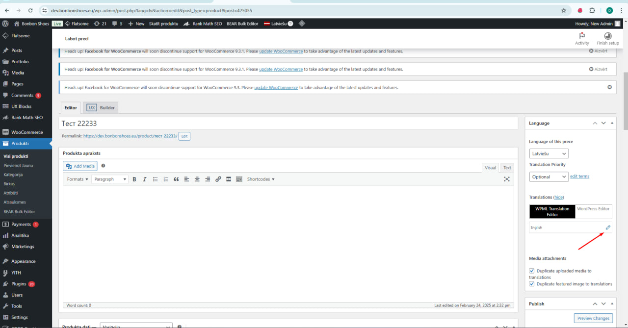

andrewE-3
We have rolled back our website to the previous version of the plugin and made the necessary configuration adjustments. Currently, the page is being duplicated and both variations and attributes are loading correctly; however, the description translation is not being applied, even though it indicates that the translation is ready.
Please see the attached screenshots for more details.
February 24, 2025 at 2:42 pm #16741654
Otto
WPML Supporter since 09/2015
Timezone: America/Argentina/Buenos_Aires (GMT-03:00)
I am glad you managed to automate the duplication process.
As I explained here:
https://wpml.org/forums/topic/problem-with-translation-via-rest-api/#post-16707139
the wpml_make_post_duplicates behaves as the WPML duplicate "translation": it creates a synched copy of the original content. It does not trigger the automatic translation. How are you doing the translation after duplicating the original content?

February 25, 2025 at 7:10 am #16744072
andrewE-3
How to do auto-translate content after duplication?
We are now doing the translation through editing in the product card. (attached screenshots)
February 25, 2025 at 1:33 pm #16746085
Otto
Yes, that's the expected flow.
WPML's API does not include any hook to handle the translation flow yet 🙁
Have you tried enabling "Translate Everything Automatically" (see attached screenshot)? After you create the original product programmatically via the rest API it is not automatically translated? If not, you may try resaving the product using save_post.
But this is just a workaround and I didn't test it. At the moment, WPML does not provide an official method to trigger the Advanced Translation Editor’s (ATE) automatic translation programmatically.
