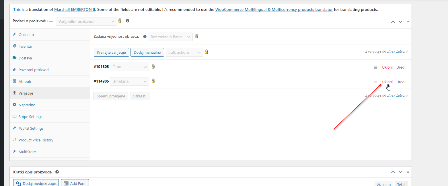

Our Second Tier Support has successfully resolved your issue, and here's what you can do to rectify it.
The problem was addressed by executing the "Fix post type assignment for translations" function in WPML > Support > Troubleshooting. Although the variations had a language assigned, they were still not visible and set to "Any variation".
To resolve this, follow these steps when editing the translated product:
1) Resave the product - this resolves the black variation issue.
2) Delete the translated white variation and resave - this synchronizes with the original, making both variations available.
3) How to delete a locked variation in the translation?
Please refer to the attached screenshot and simply click delete, then resave.
We've fixed both products here to demonstrate that the solution works.
Could you give this a try and let me know how it goes?
