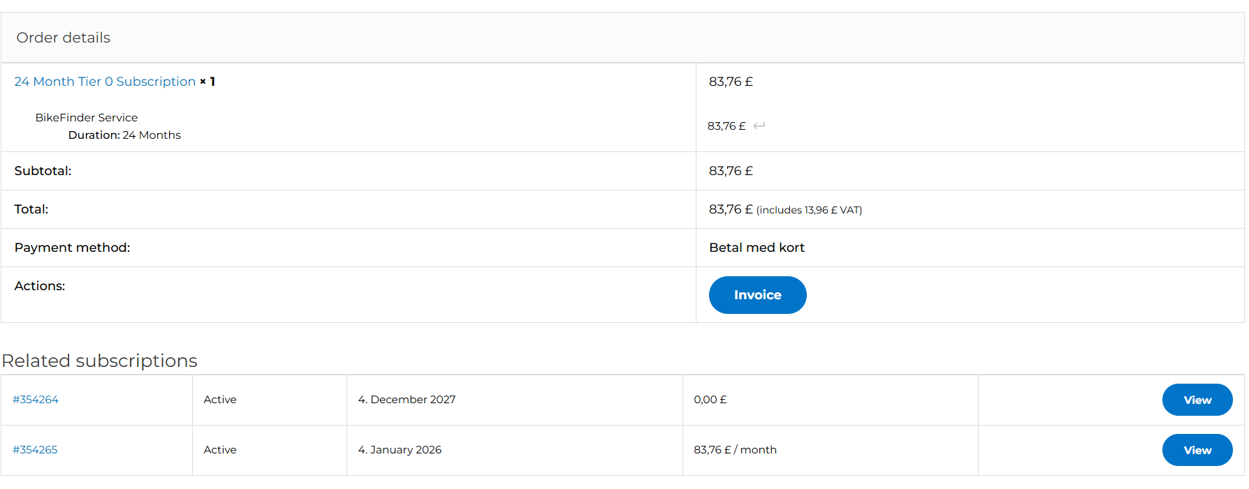

See the attached screenshot for how this appears as a test transaction on staging.

Compare the subscriptions between one that worked and one that didn't for the default language:
Worked as expected (no WPML plugins active): hidden link
Did not work as expected (WPML plugins active): hidden link + hidden link

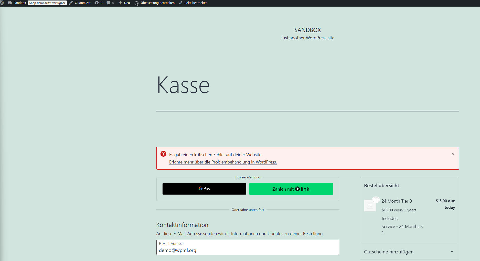

However, I should note that I'm having issues replicating the issue. I have gotten it to the point where the English page allows you to purchase the bundles as expected, but I'm getting a generic critical error on the German page when I try to make a purchase (see screenshot).
Is there a way for me to see the error on a sandbox site like this? It is difficult to know exactly what went wrong without some debug logs.

From the debug log, it seems like the site is running out of memory. But I figured out that the subscriptions still went through anyway, and they looked like expected (one subscription for the bundle). So I wasn't really able to replicate the issue.
