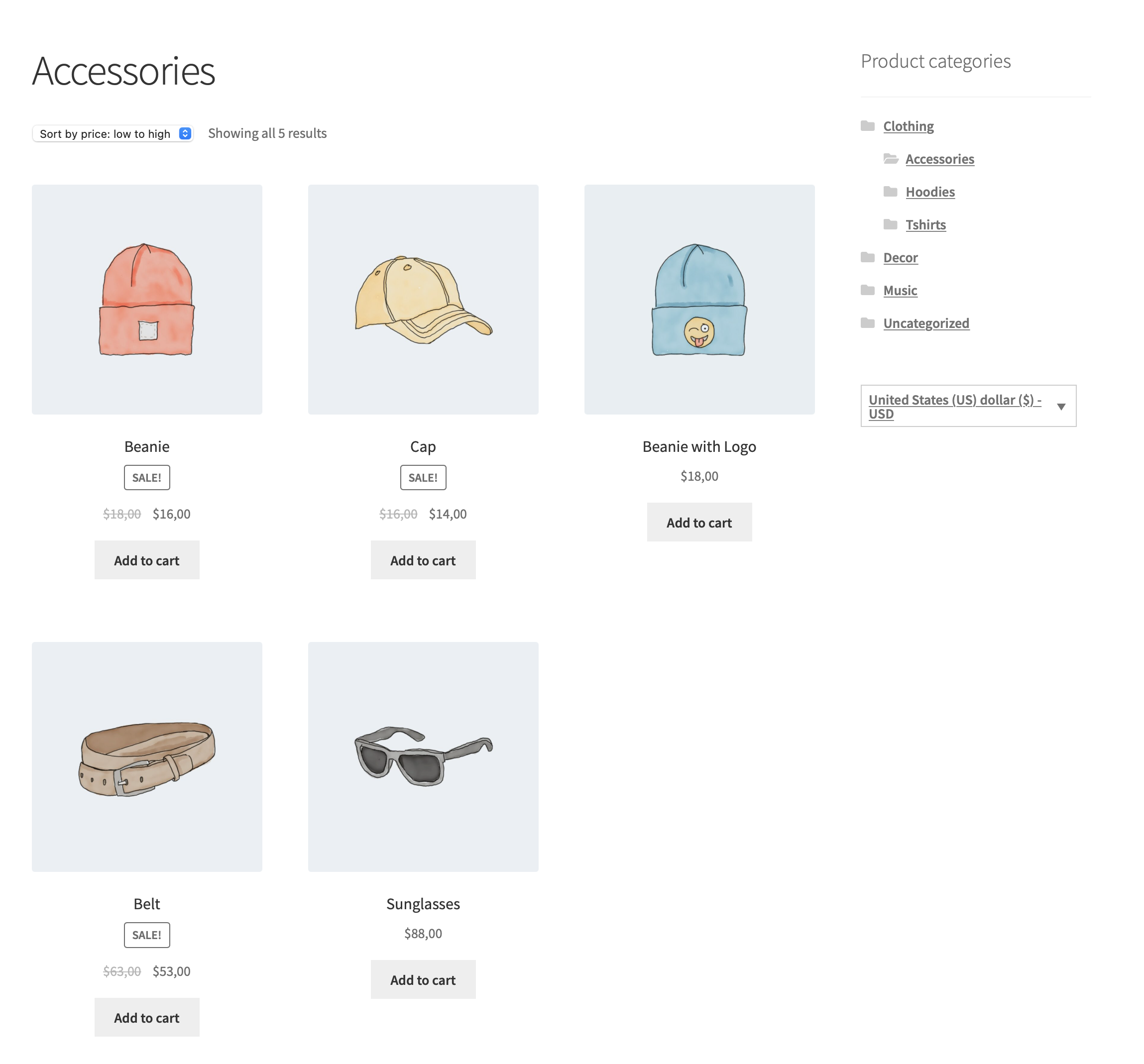

I was not able to reproduce the error here on this sandbox site:
Steps to reproduce:
1. Select category "Accessories"
2. I have set custom prices in 2nd currency
3. Test the sorting by price: low to high
4. This seems to work in both currencies.
Can you please confirm this on your end. This sets a baseline that product sorting is working with a basic setup of Woocommerce, multicurrency, and custom pricing in 2nd currrency.
We can then check what is the difference between your site and the baseline example.

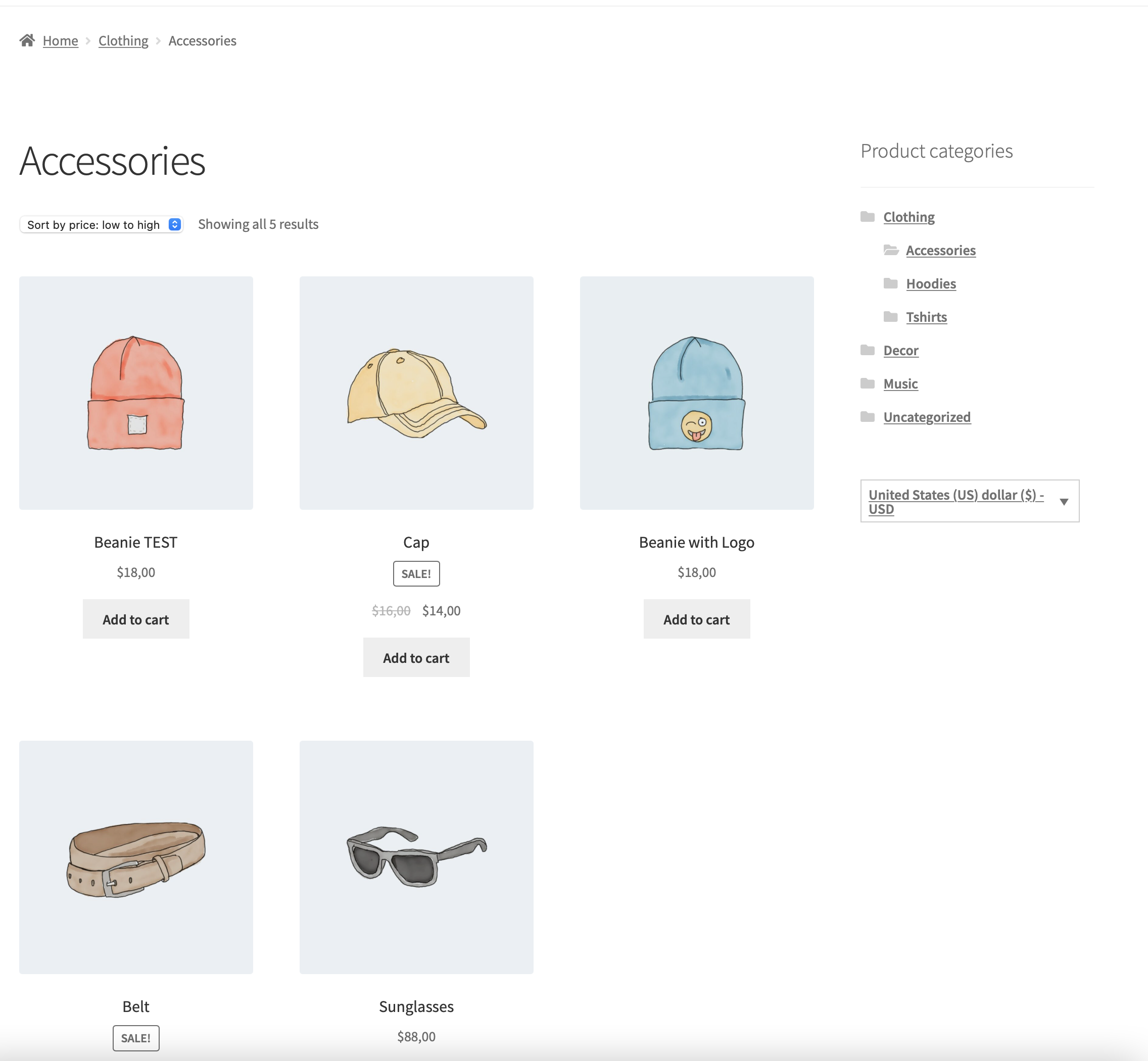

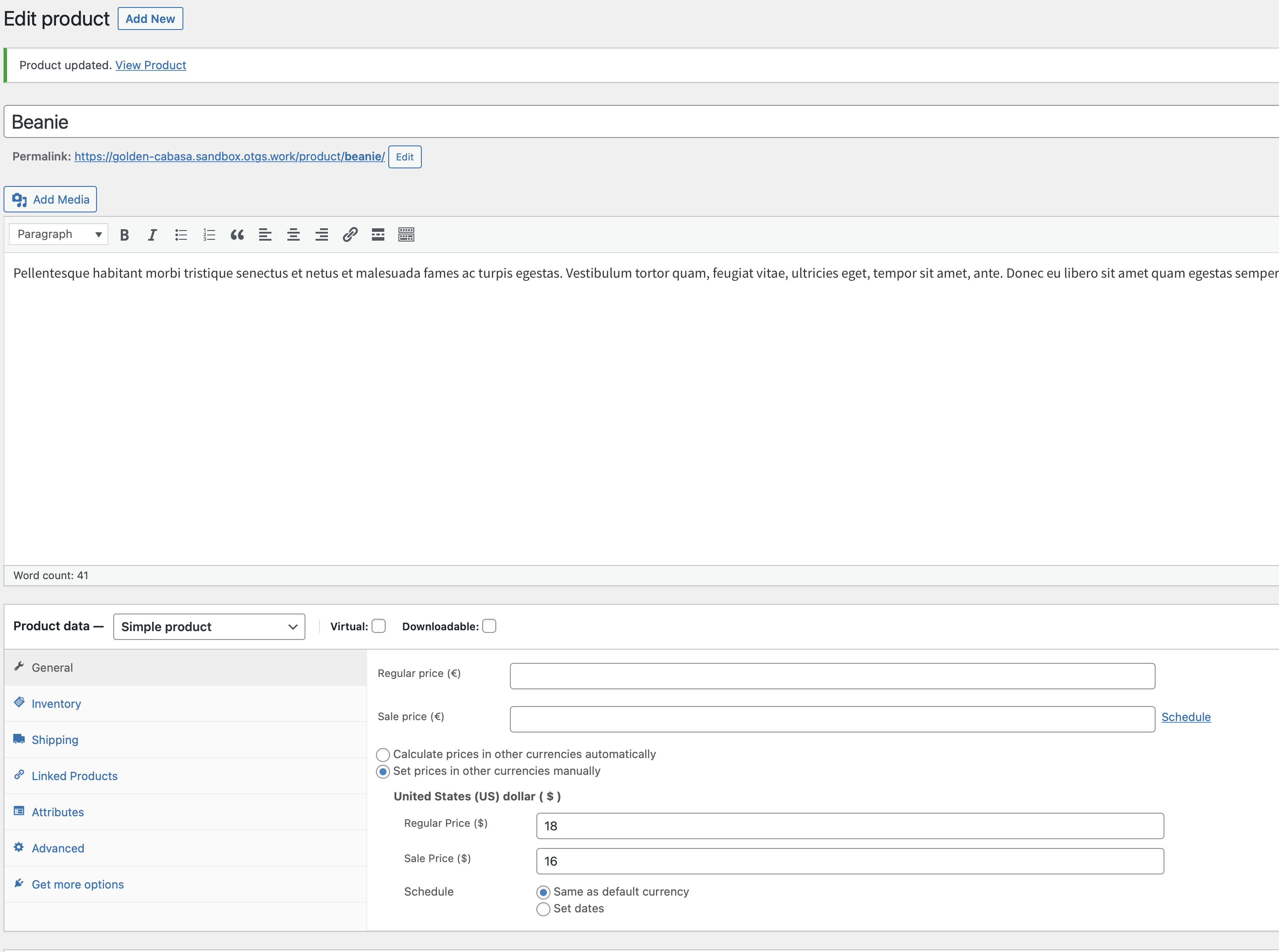

Hi Yvette, I have checked your sandbox instance and made changes in this product: hidden link remove regular price from product, then when I sorted it is showing wrong product at first. Instead it should show the one has $14 first but it is showing $16 one first. See attached images for ref.
I checked hidden link on this link on frontend.
September 27, 2021 at 8:18 am #9664895
Yvette
Timezone: Europe/Paris (GMT+02:00)
OK- thanks for that! So, the question is, why do you have " " for the field "Regular Price"?
On your staging site, if I deactivate our plugins, the sorting is still not working. It seems that you need this field for Woocommerce logic to work. I am not sure our plugin is affecting this behaviour.

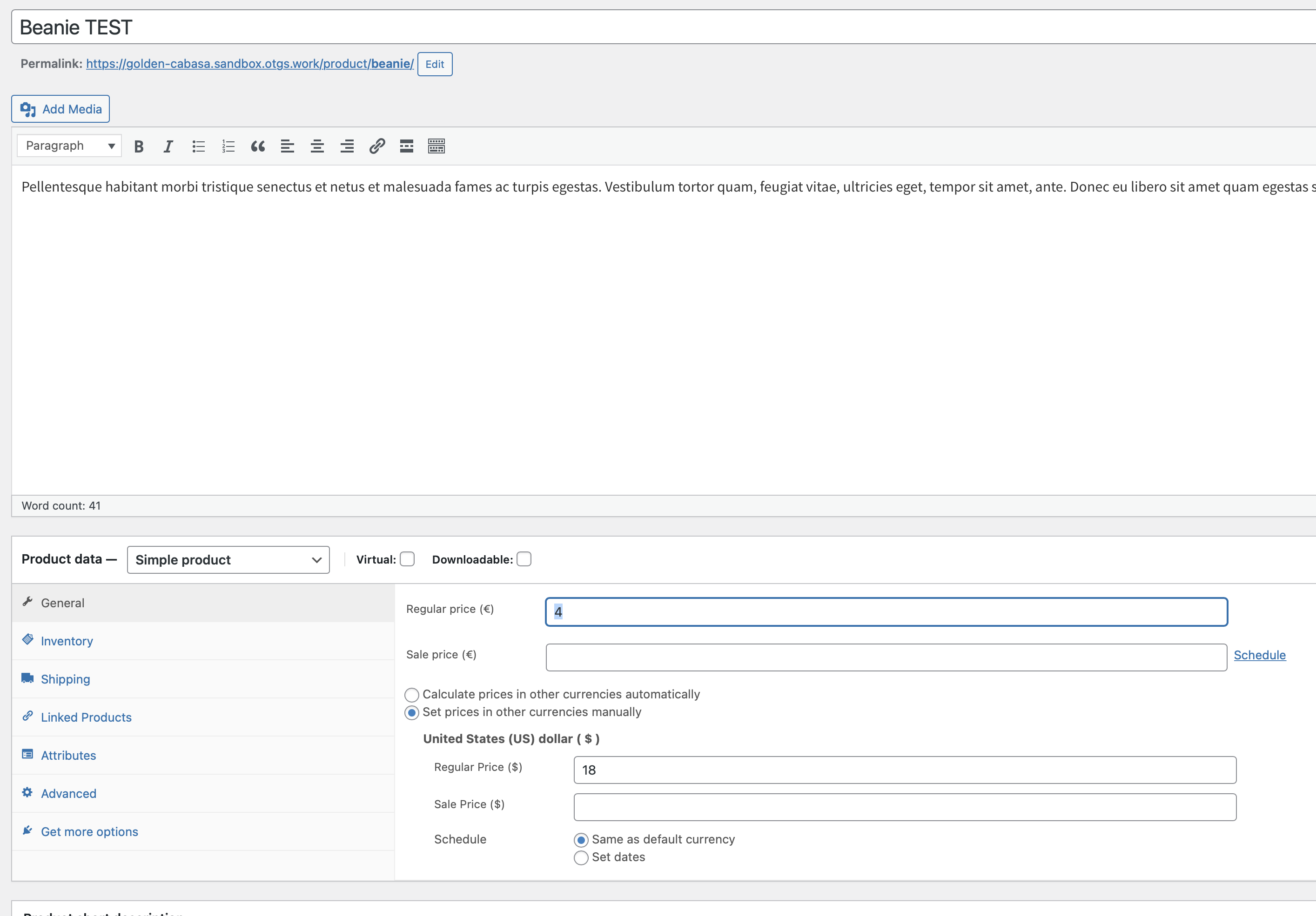

steveJ-15
Hi, I edited product again and made regular price as 4. But when I am sorting at front-end it is showing price as $18 but showing at first in the high-low, whereas it should show after the 2nd product as it has price grater than the 2nd one. See attached images for clarity.
September 27, 2021 at 10:19 am #9666705
Yvette
OK! I agree. I have this concrete example I can escalate.
