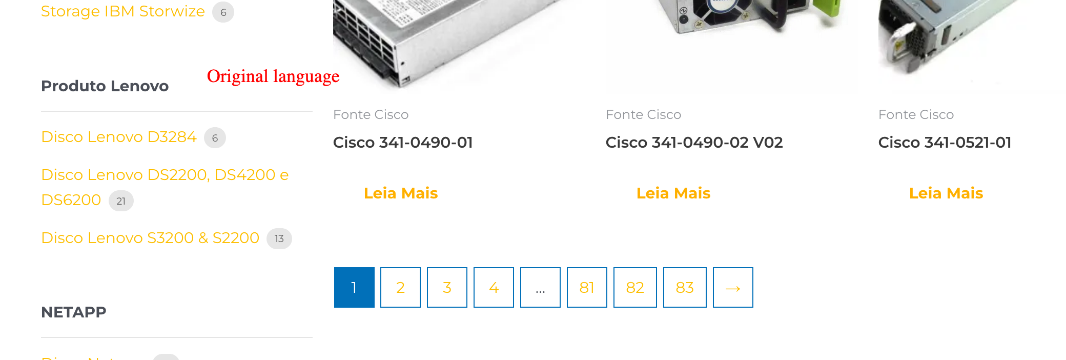

Some products were added, but they are not updating in other languages despite updating and rescanning.

Some products were added, but it's not updating in other languages.
I've already tried updating and rescanning, but it didn't work.

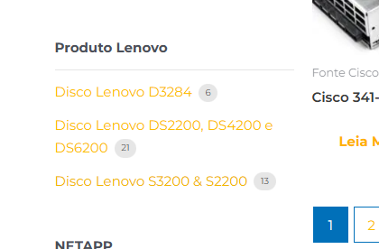

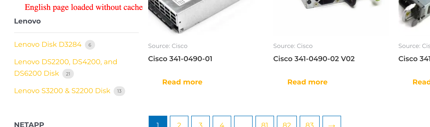

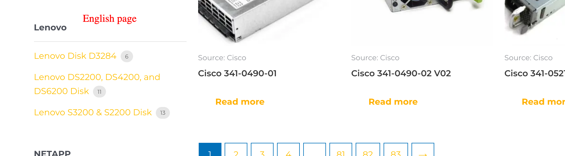

I’ve looked into your setup to better understand the configuration and why you might be seeing a difference in the product filter counts.
From what I can see, the pages are being cached, and the filter count is not updating as a result. I recommend clearing all types of cache—both at the site level and on the server side—to ensure the data is refreshed correctly.
I’ve attached screenshots for your reference.
