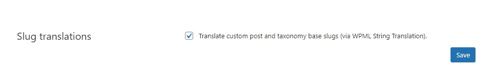

Team checked in sandbox and recommends turning on "Translate custom post and taxonomy base slugs (via WPML String Translation)" in WPML -> Settings -> Slug translations and save.
If it is already turned on, please just save and then resave permalinks.
We've checked in sandbox and it seems to work fine. You may need to try this on your site. Also remember to clear caches and force reload the pages you visit to check.
Please let me know.

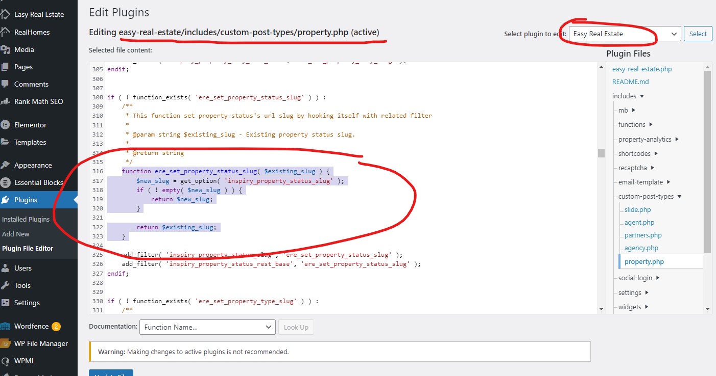

Team did some digging and found that there's a conflict with the "property-status" string from the "easy-real-estate" textdomain in the plugin's code.
To fix this please use the following workaround:
IMPORTANT: Take full backup of your website and database beforehand.
1) Open the wp-content\plugins\easy-real-estate\includes\custom-post-types\property.php file.
2) Replace the ere_set_property_status_slug() function (line #316..323 approx - as shown highlighted in the attached screenshot):
function ere_set_property_status_slug( $existing_slug ) {
		$new_slug = get_option( 'inspiry_property_status_slug' );
		if ( ! empty( $new_slug ) ) {
			return $new_slug;
		return $existing_slug;
3) With:
		// WPML Workaround for compsupp-6912
		if (class_exists('Sitepress')) {
			$existing_slug = 'property-status';
			return $new_slug;
4) Save the file.
5) Go to WPML > Settings > Taxonomy Translation.
6) Click on "Set different slugs in different languages for Property Statuses" and translate the slug.
7) Re-save permalinks.
8) Clear all caches and recheck.
Unfortunately the sandbox has been expired and I can not confirm it in there beforehand. So please apply these steps in your site and let me know if this works for you?

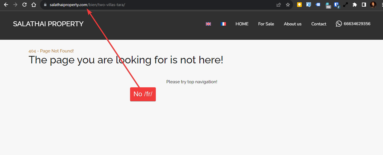

But we still have a very strange issue. Once on thsi page, if you click on any property, the initial URL seems correct but then we get a 404 and the /fr/ in the URL seems to disappear.
I attached screenshots for you.
This is also happening for the "about us" page which is the "agency" in the template.

I've checked and can see the problem. But the problem is random and weird. For example:
- Go to hidden link or hidden link and switch to French.
- On French page, mouse hover a property title and notice it gives the URL, i.e. hidden link
- If you click this it takes you (sometimes) to the correct URL (i.e. hidden link)
--- But if you refresh or reload, it takes you hidden link (404 not found)
--- Strangely, if you just add /fr/ to the URL again i.e. hidden link it brings back the correct one.
And sometimes it even stays at the correct URL.
I am not sure either something from the theme or the said plugin is in play or is it cache or server. I've tried clearing caches as well.
However, I'm discussing this with the team and 'll get back to you accordingly.

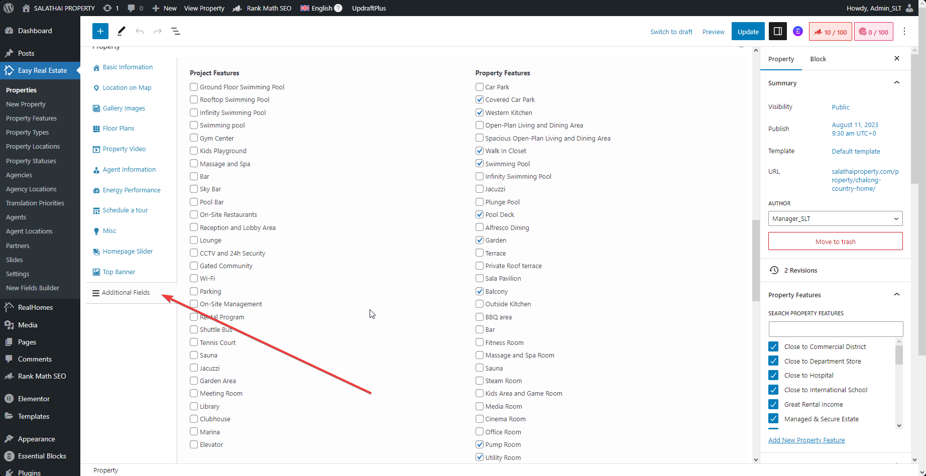

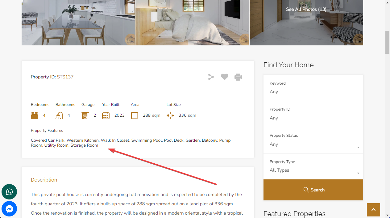

1) On the homepage, the header is a "property slider" from the theme, and strangely enough, it's not showing in the French version.
2) On a property page, the "Additional Fields" are not showing. (see screenshots)
Promise, these are the last things :))
Thanks again
