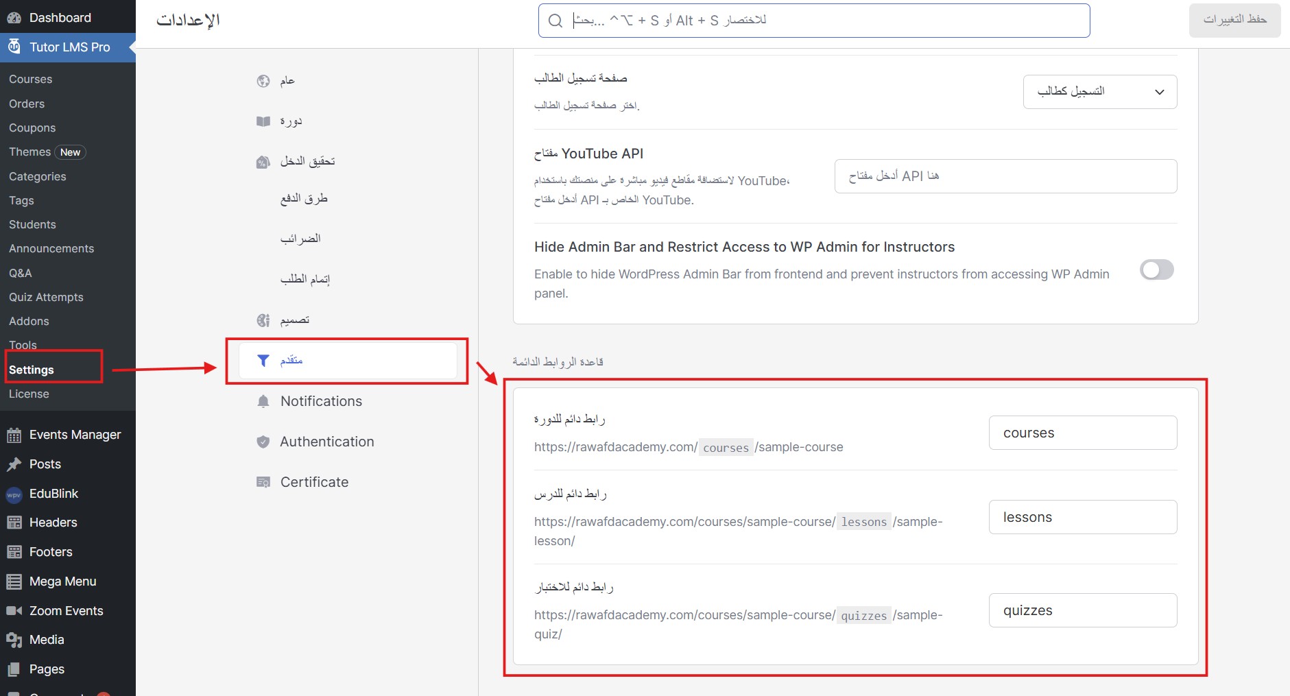

I was able to find and fix the problem. There were actually 2 issues which needed to be taken care of:

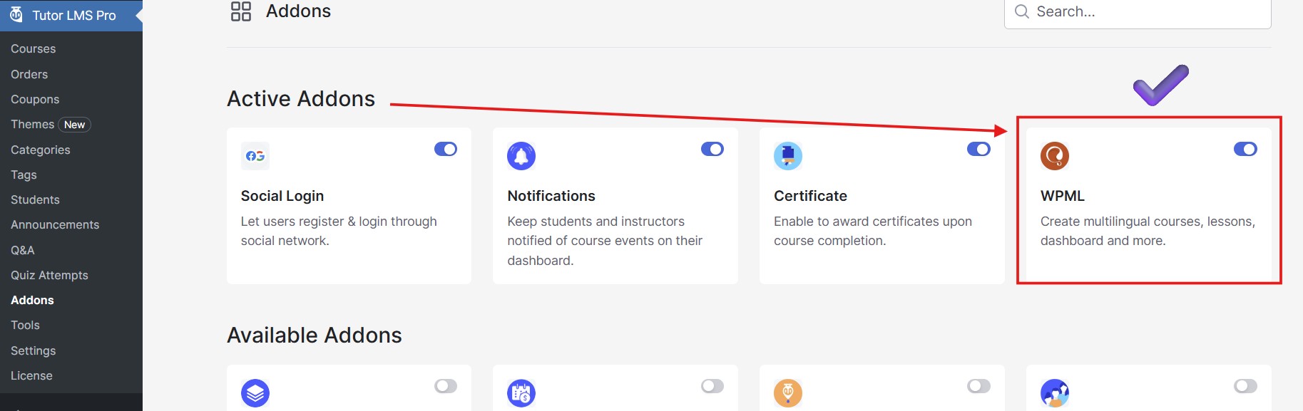

1) Missing WPML Addon: When using WPML with Tutor LMS Pro, a WPML addon needs to be active. This is provided by the Tutor LMS Pro and can be activated from Tutor LMS Pro -> Addons -> WPML. I've activated it.

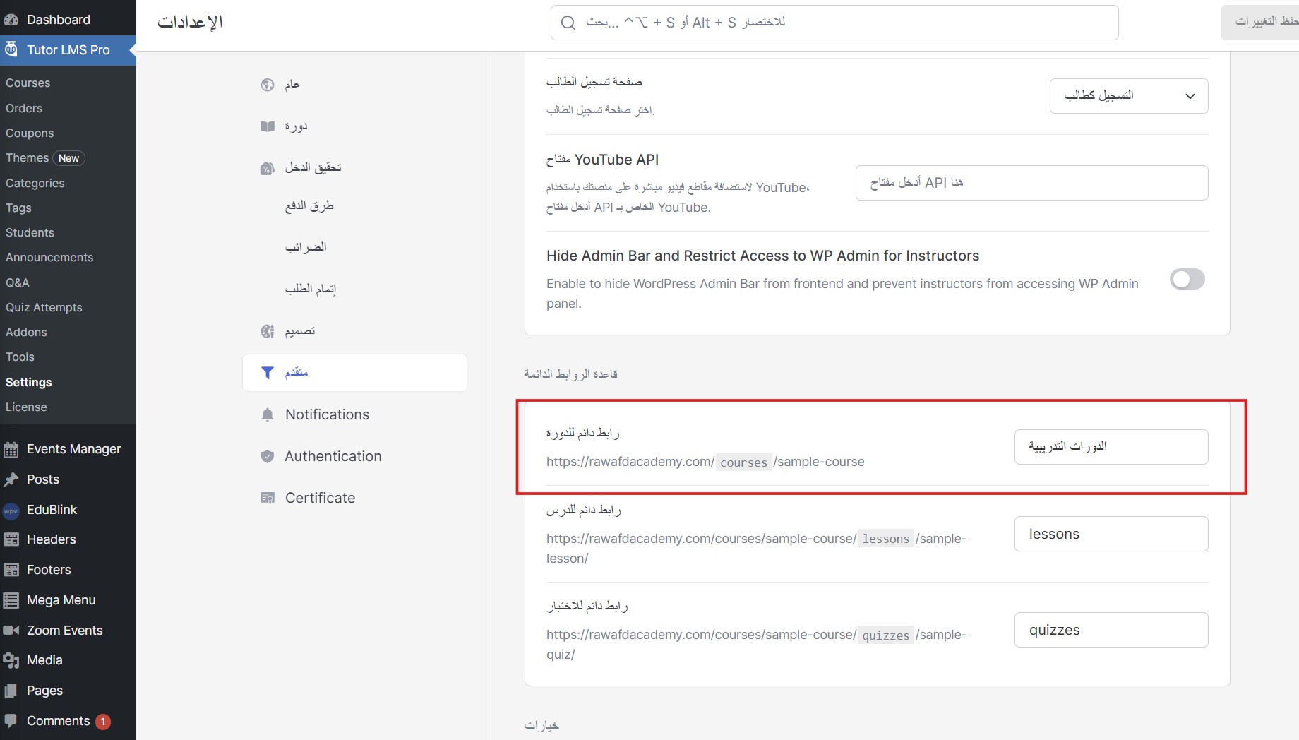

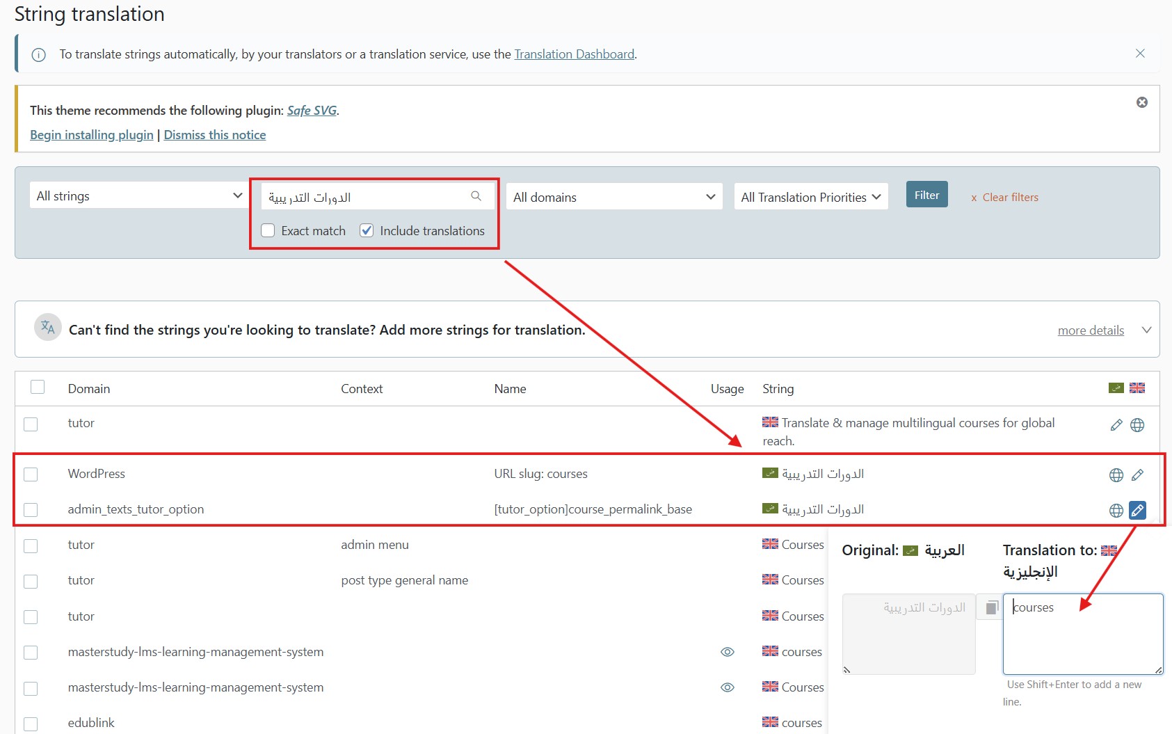

2) Problem with "[tutor_option]course_permalink_base": There seemed to be some kind of database corruption for the said option. This stores the base slug for Courses (i.e. /courses/) as defined in Tutor LMS' Advanced Settings. So I searched for it String Translation, changed language, removed, redefined in settings (in Arabic and later back to English) and it seems to work fine now.
Attached are the screenshots for references, as well as, hidden link. Please note that I've reverted back this slug to English one (i.e. courses) and have removed its Arabic definition from String Translation.
