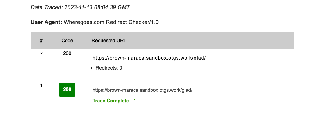

I tried to click on this link hidden link but it is working without any redirection. So it does not work for me on your installation neither !
I tried with different devices and browsers... When checking the redirections too there are any.

Christopher Amirian
WPML Supporter since 07/2020
That is correct. I guess this is the default behavior of WPML. But I am going to ask for a second opinion and get back to you.
