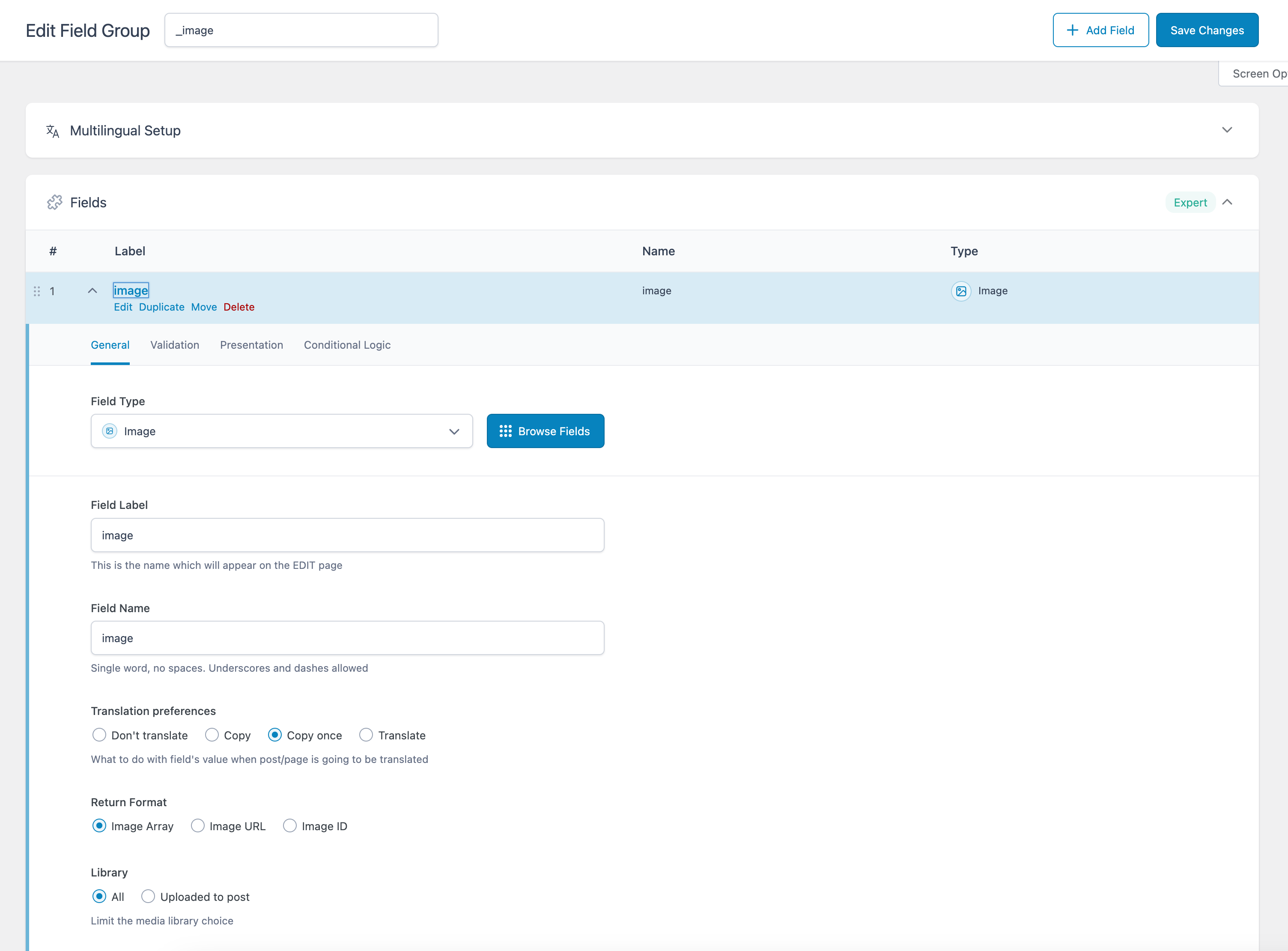

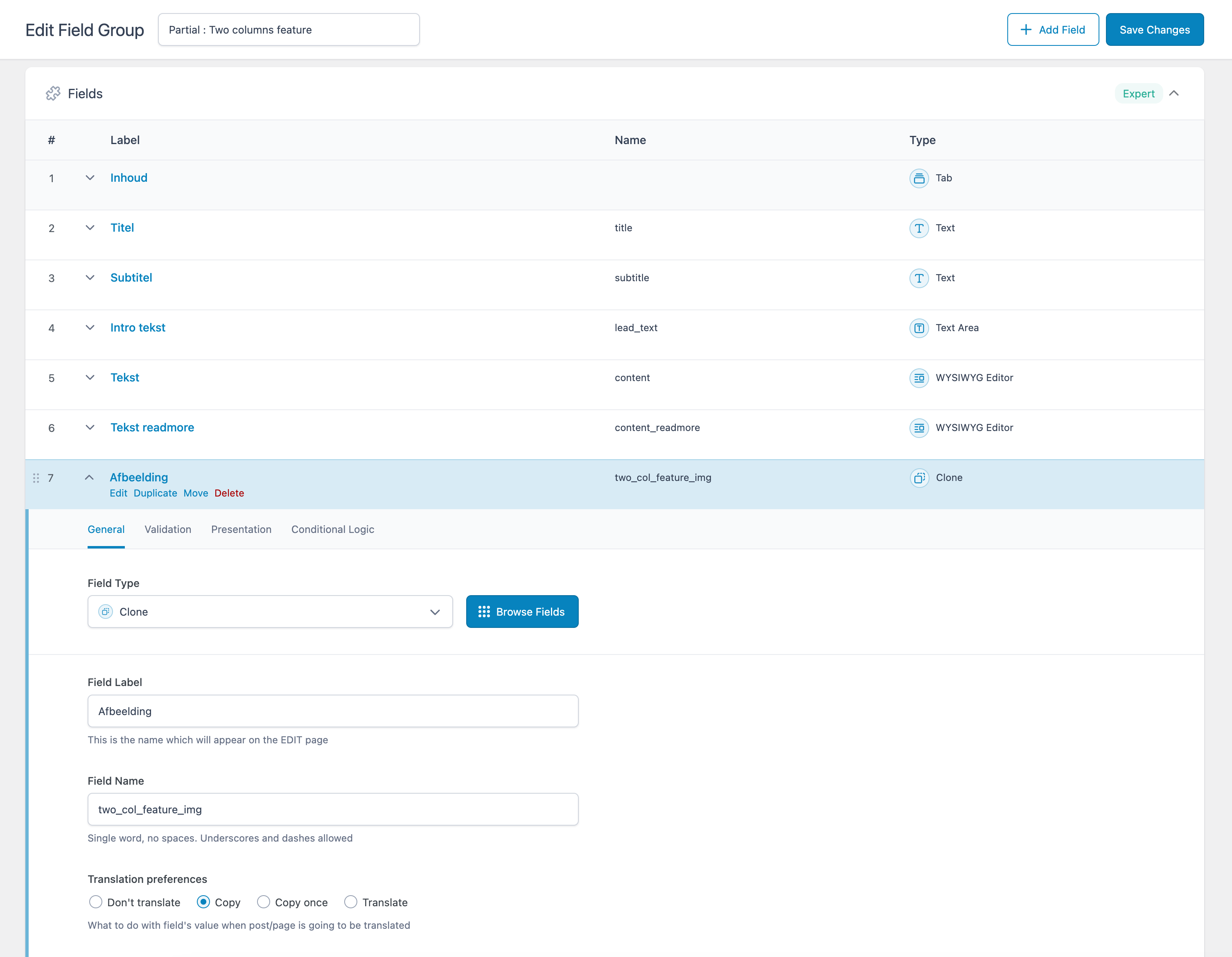

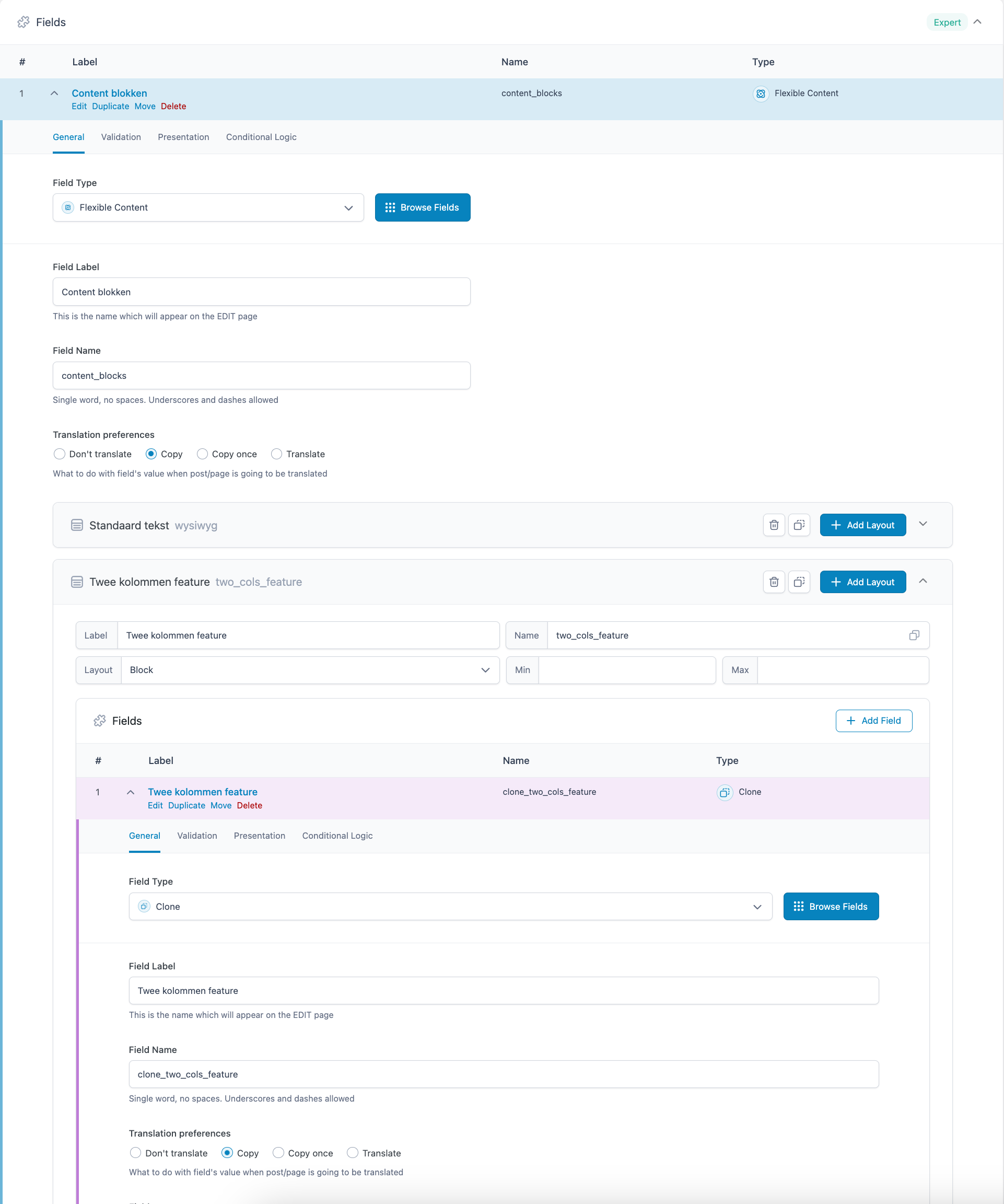

In the attachments the structure
Level 0: Flexible content block with clone blocks
Level 1: Clone block from the flexible content
Level 2: Clone block image from the clone block of level 1

I’ve reviewed and successfully resolved the issue with uploading images on the Sandbox. The root cause was that the primary field group, "Content blokken," was set to "Copy," which prevented manual content additions in the subfields, including the image fields. After adjusting the field configuration, I was able to update the image in the translated version without any issues.
Here’s what I did:
- In the "Page: Content" field group, I changed the translation preference for the "Content blokken" field to "Copy-once," allowing the data to be copied initially while enabling manual changes afterward.
- Within the "Content blokken" field, there is a "Twee kolommen feature" field containing the Title and image field. I also set the translation preference for this field to "Copy-once."
- The fields within "Twee kolommen feature" were cloned from the "Two columns feature." I accessed the "Two columns feature" field group and set the translation preference for the "image" field to "Copy-once."
- Since the image is a cloned field, the fields within the image field were copied from the "_image" field group. I opened the "_image" field group and set the translation preference for the "Image" field to "Copy-once" as well.
