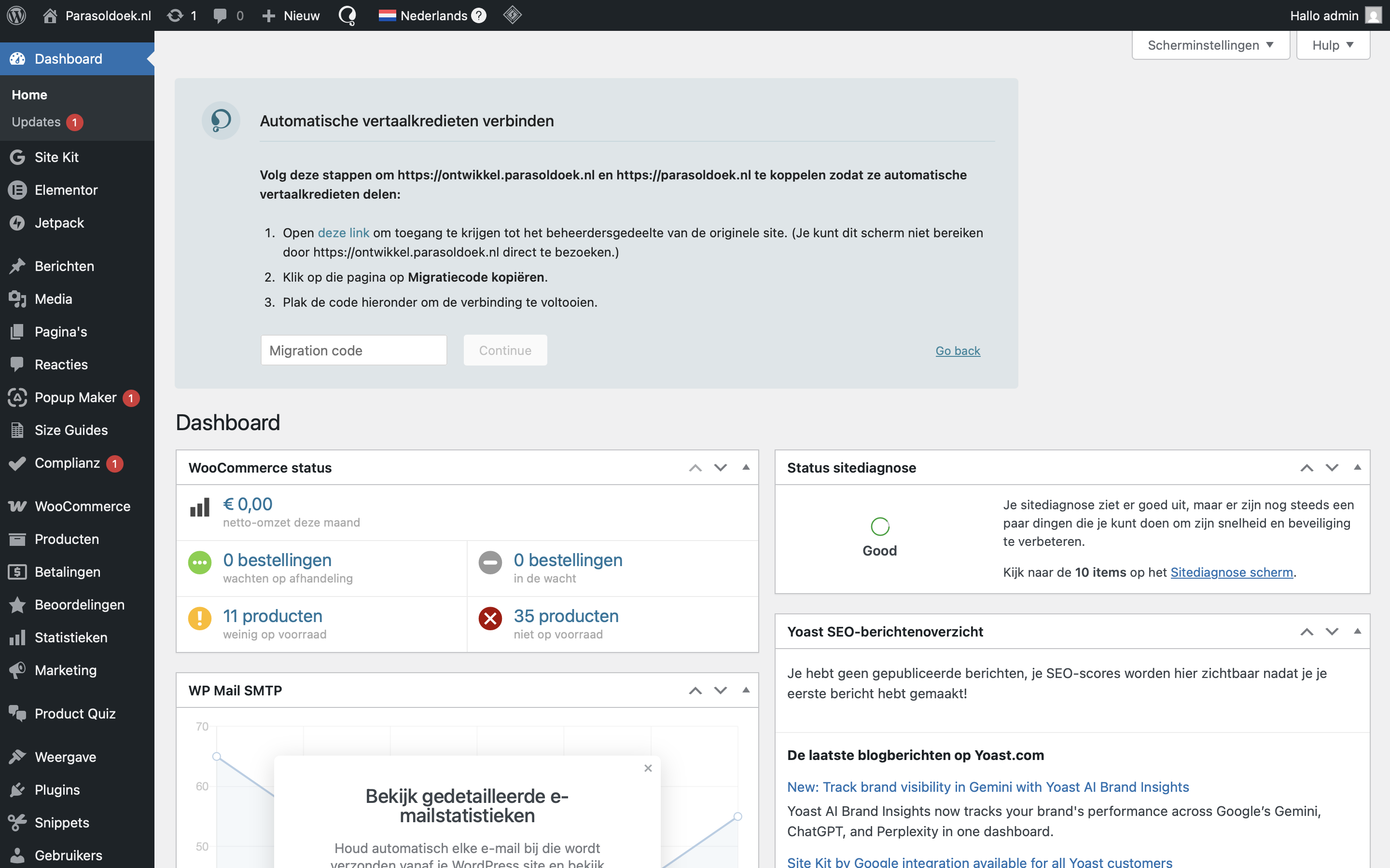

At the moment, we are unable to translate anything in the webshop. We would appreciate your assistance in checking why the translation functionality is not available and helping us set this up on the live site.
Additionally, when I try to start the migration process, I’m unable to proceed. I follow the required steps, but I eventually end up on a page that does not exist.
Please see the attached screenshots for reference.
Could you please let us know how to proceed from here or assist us with completing the migration and setup?
Thank you in advance for your support.

Thanks for your reply. You’ll need to complete the migration before you can use the translation features. Please follow the steps below (in English):
1.When prompted by WPML, select “No, I changed the address of the site to this new one.”
2.On the next prompt, select “No, you will need to assign credits or set up a pay-as-you-go plan for this site to use automatic translation.”
Once you’ve completed these steps, please let me know and I’ll recheck everything on my end.
If you’re still unsure how to proceed, feel free to share your website’s WP admin access using the private reply option I’ve enabled. If you do share credentials, please make sure you have a backup prepared beforehand.

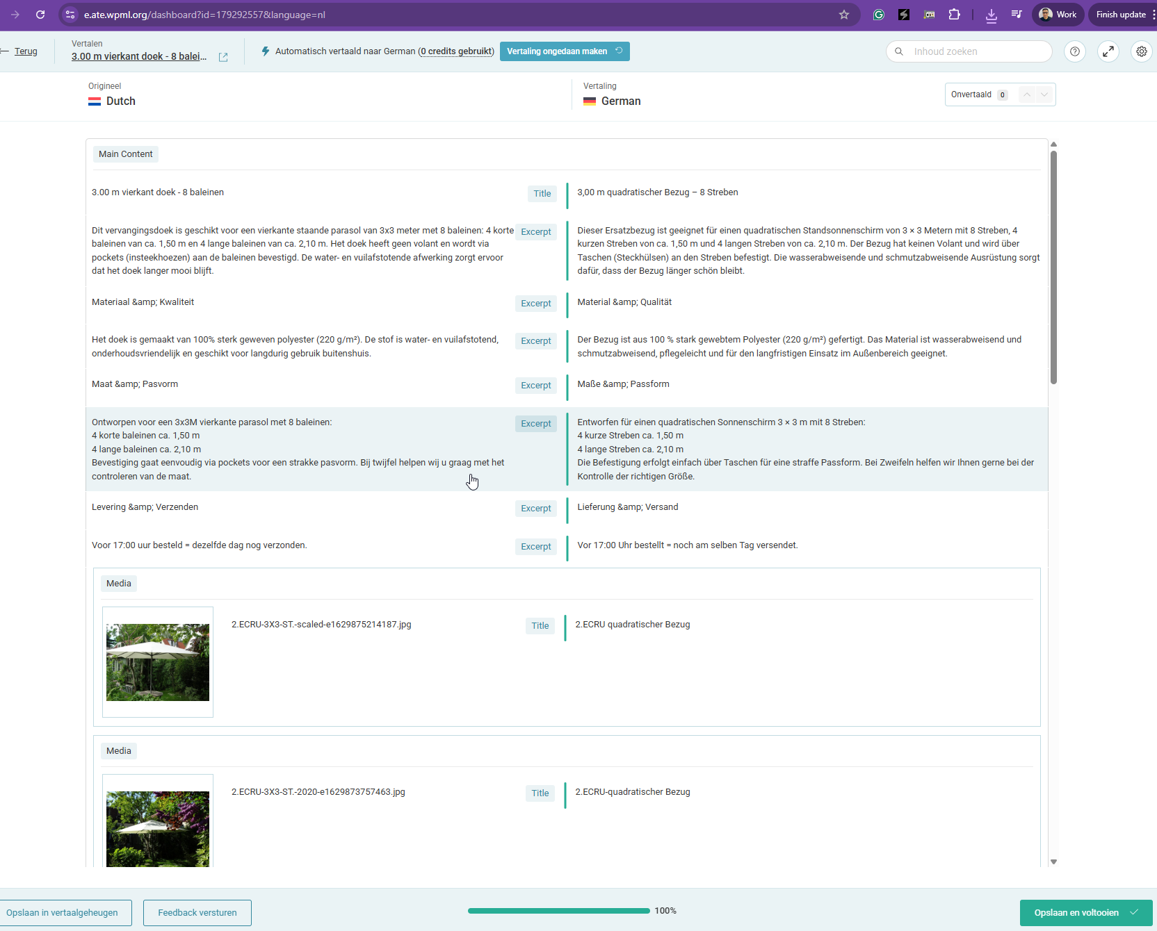

Thanks for your reply. I’ve moved 55,188 credits to hidden link
. Unfortunately, the 2,000 free credits cannot be transferred, as free credits are not movable.
Regarding the translated products, I can confirm that the translations are saved in the translation memory. This means that retranslating the same product will not consume any additional credits.
For example, you can check this product here:
When translating it into German, no credits are deducted, as shown in the attached screenshot.
Could you please try triggering the translations for the products you previously translated and let me know whether any credits are being charged?
