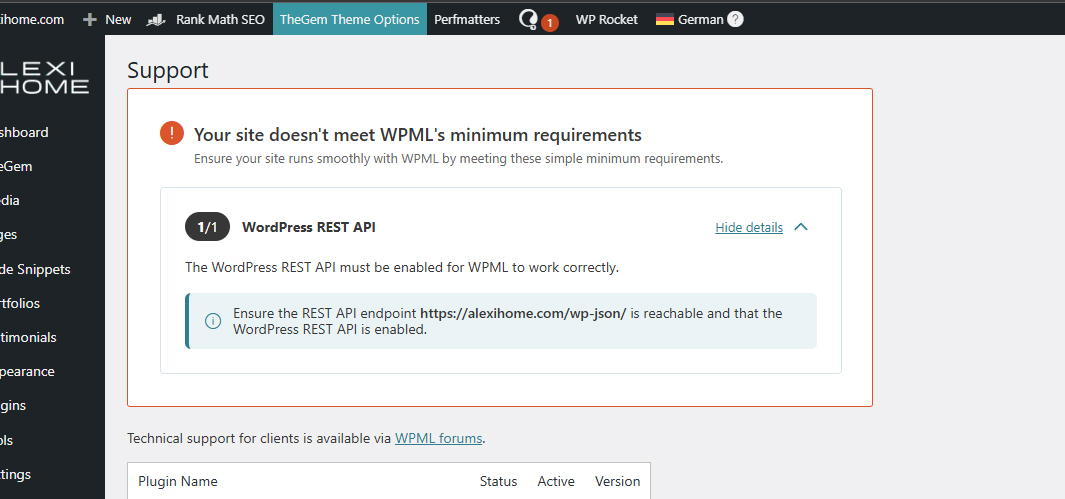

October 15, 2025 at 4:57 pm #17487928
wioletaR
Hi Otto,
I followed your instructions: with ST inactive I ran Fix WPML tables twice and cleared WPML cache, then triggered the installer once via a one-shot MU plugin calling icl_sitepress_activate(), reinstalled WPML String Translation, and verified the missing schema—yhoj_icl_string_batches now exists (indexes added). WPML and ST are working, no more critical errors, translations are fine. The only remaining issue is the wizard still shows “The WordPress REST API must be enabled,” but hidden link
returns 200 JSON and includes wpml/v1. Please take a look into that issue, should not exist on a well written simplke site with such topnotch code like wpml. thank you so much 🙂
i will work tonigjht on the site , if something is ubnormal a will ask u again so far no more fatal errors but the rest api issue must also be solved

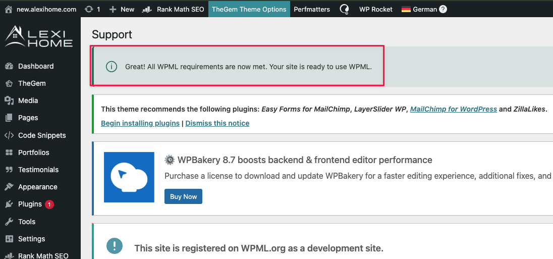

There was a notice about WP Rocket cache. I cleared it. Then in the WPML warning, I clicked on "Fix it".
And after that, the warning is gone, please check the screenshot attached.
Can you try this in your site?

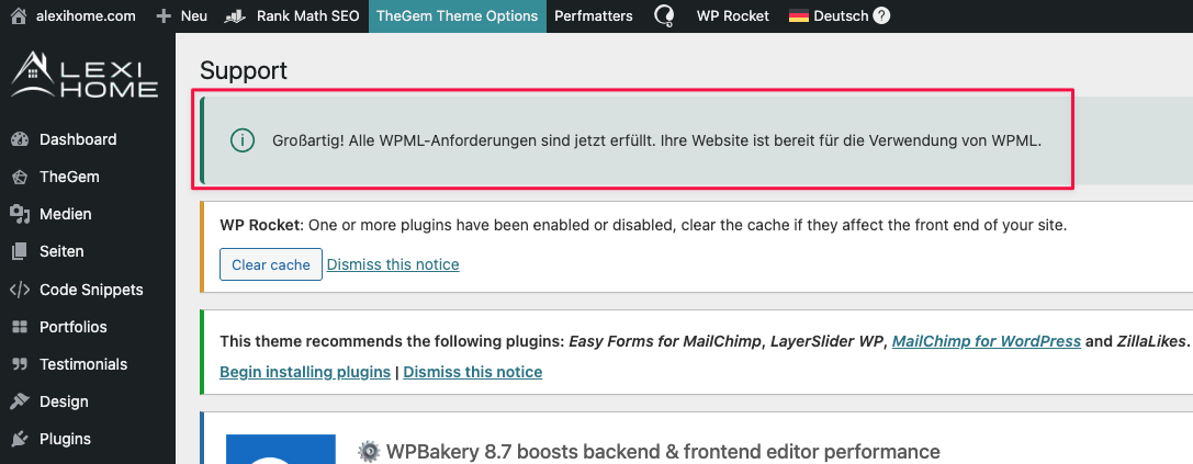

Otto
This is weird... I just clicked on fix it and the issue was gone in the production site too, check the screenshot attached.
Is it OK for you now too?

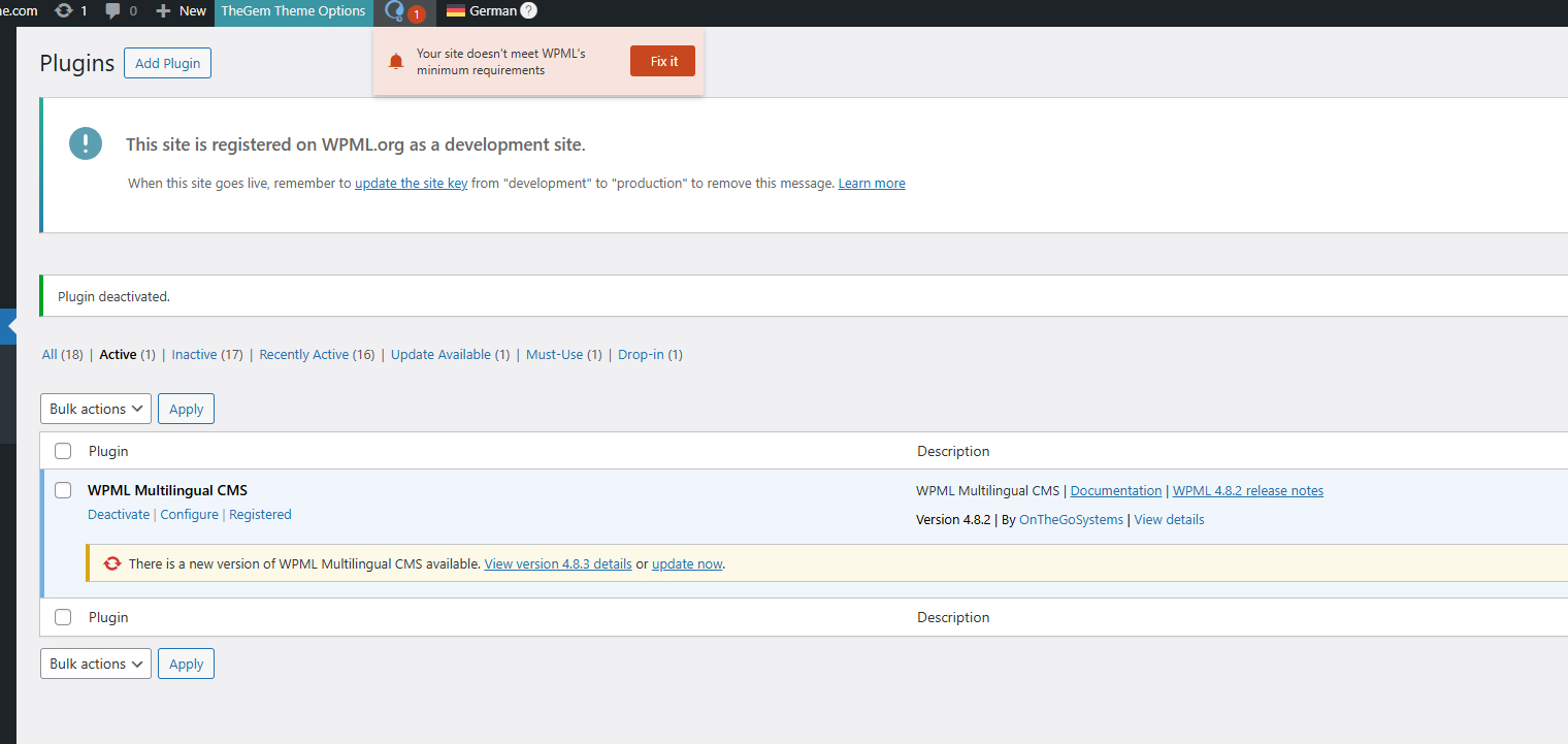

October 15, 2025 at 6:27 pm #17488201
wioletaR
Hi otto, it reappeared on the live site. u have full access thanx

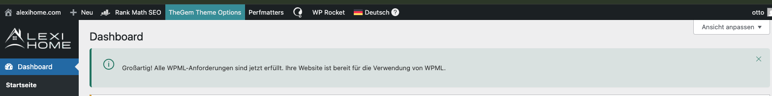

Otto
I just logged in, and it still shows that the requirements are OK. Check the screenshot attached.
I think it may be related to cached files/css/js. Can you please make sure to clear all the caches of your site? I see you have WP Rocket enabled, but besides it also check if there are any caching mechanism at the server level.
After this, "fix it" and see if this time it remains.
