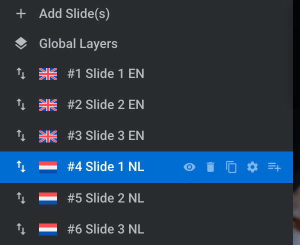

I have translated a revolution slider that contains 3 slides.
All slides have content (text and image).
A language (dutch) has been assigned to each translated slide.

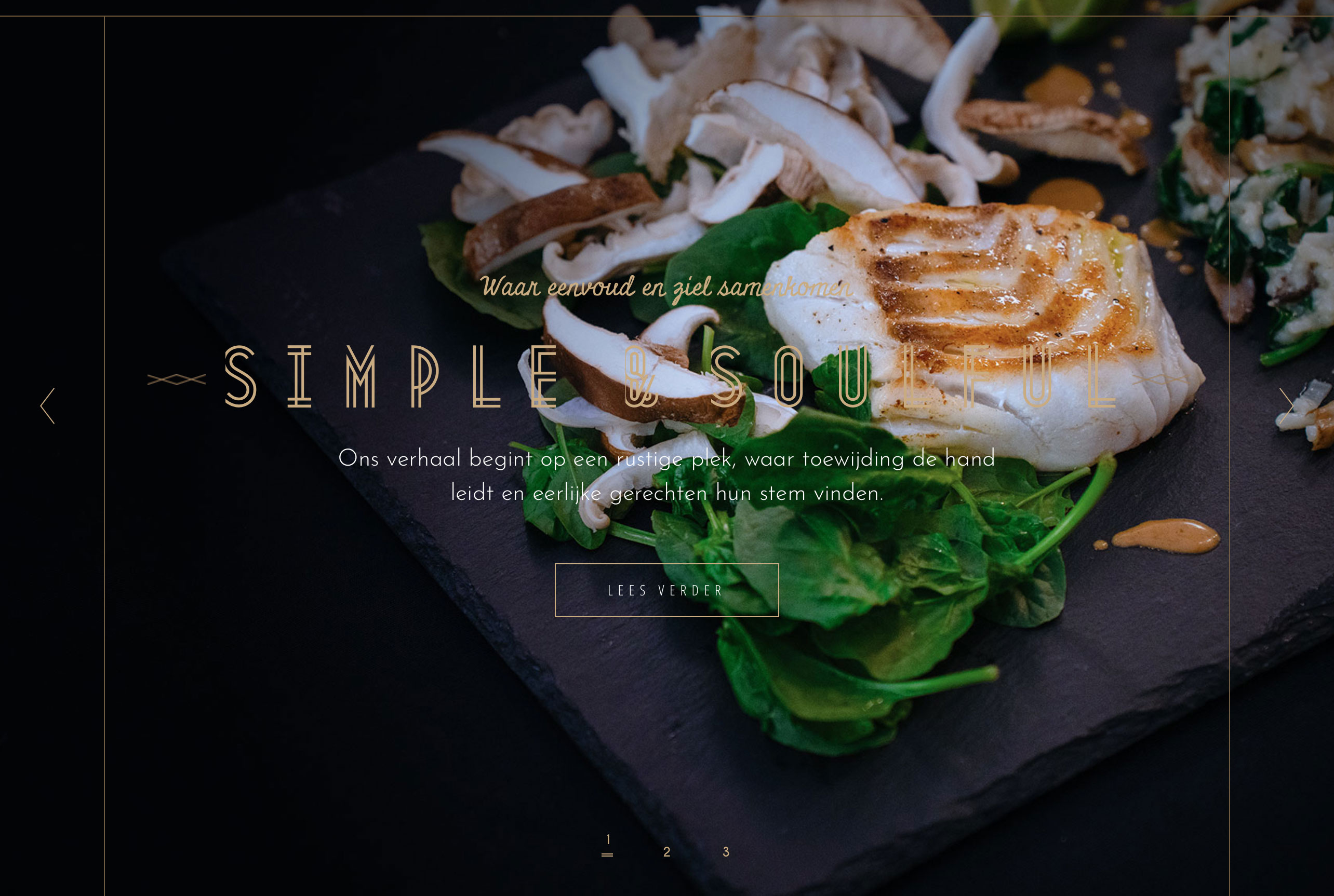

The first slide is displayed on the translated page.

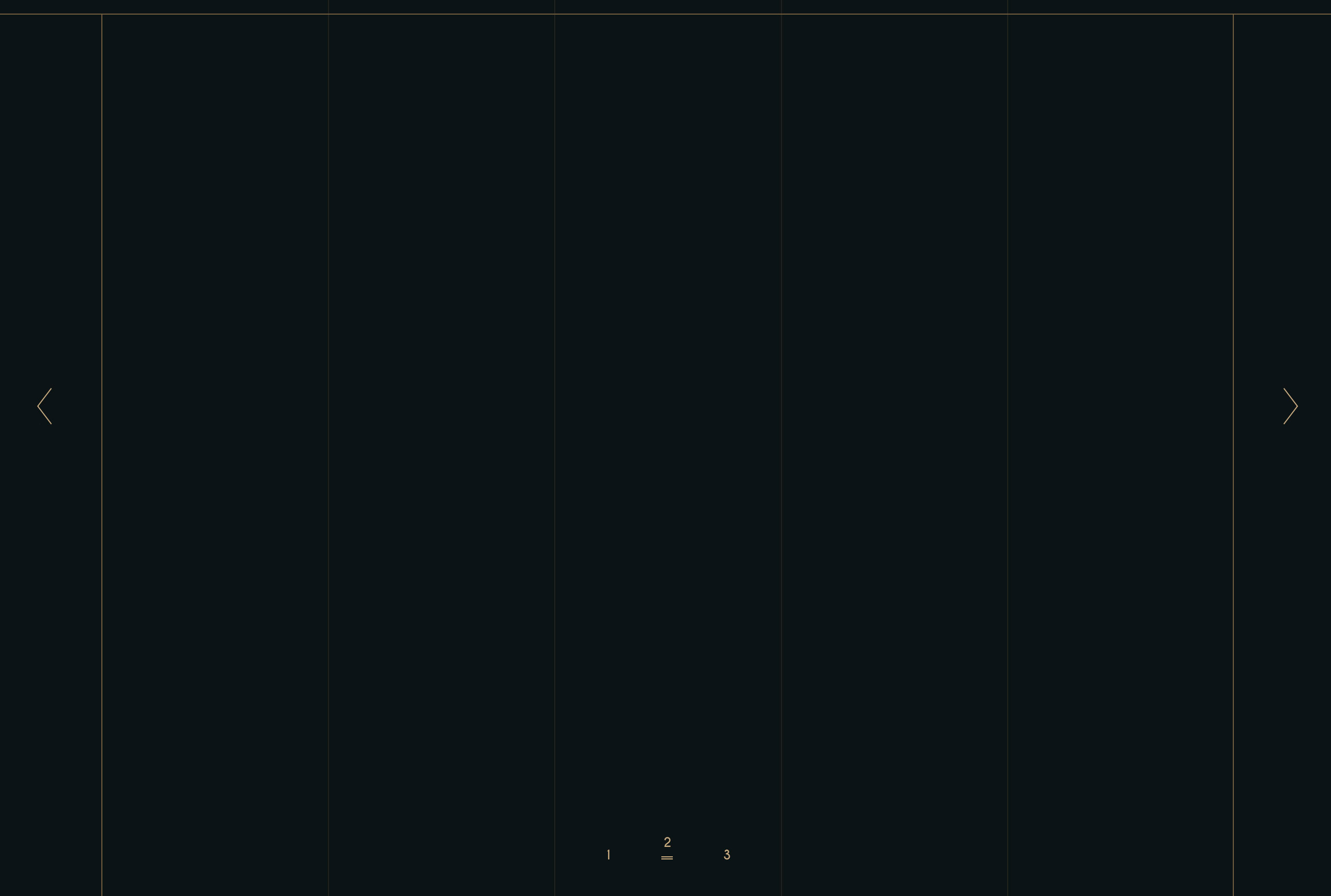

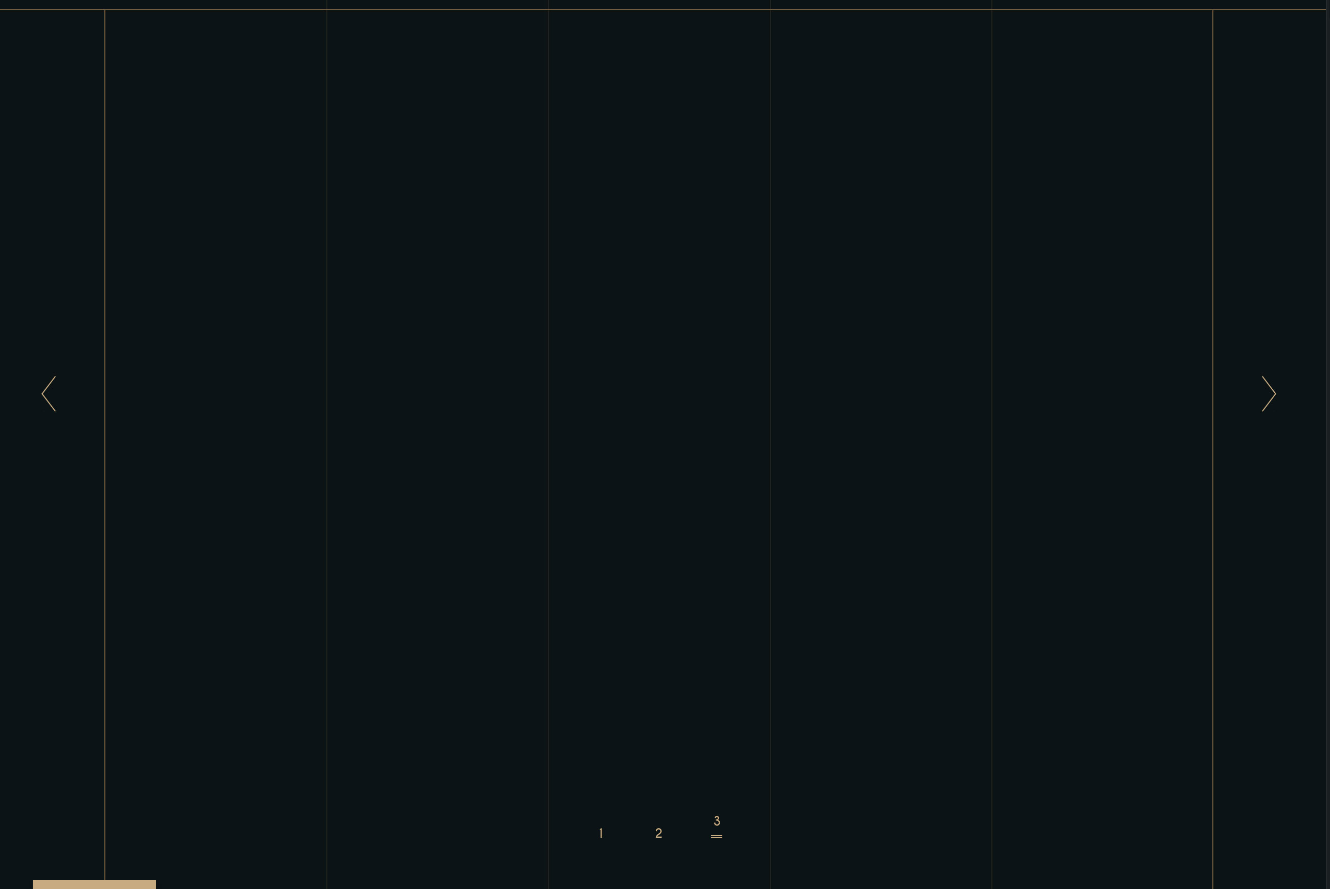

But the second and third slide is empty.
