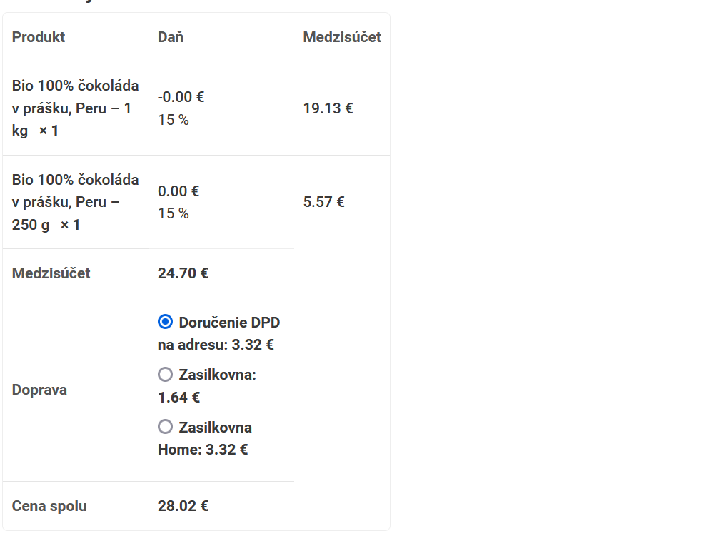

Kc is primary currency with no decimal places, with Euro at a conversion rate of 1 Kc = 0.04 euro. Euro is set for 2 decimal places.
Shipping options are set up for CZ and SK zones, at 50 Kc (inc 21% VAT) (41.3 ex VAT) and 100Kc (inc 21% VAT) (82.6 ex VAT)
So shipping to CZ costs 50 Kc and 100Kc, when not showing decimal places. Correct!!
But 49.67 Kc and 100.35 Kc ---when Kc is showing 2 decimal places!!!!. Not correct!!
Shipping to SK costs €1.98 and €4.02 when Kc is not showing decimal places. Not correct!!
But €2 and €3.99 ---when Kc is showing 2 decimal places!!!!! Not correct!!

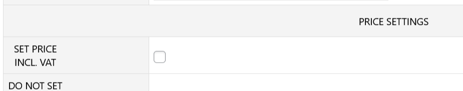

Create Shipping zone for Czech Republic and add Flat Rate shipping. Configure as Taxable and enter 41.3 for cost. Allow automatic currency calculations.
Create Shipping zone for Slovakia and add Flat Rate shipping. Configure as Taxable and enter 41.3 for cost. Allow automatic currency calculations.

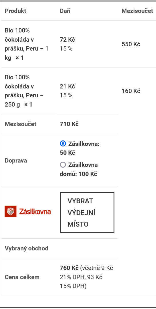

Product price is 500 Kc.
Shipping charge is 50 Kc. This is correct, 41.3 +21%(8.67) rounded to nearest.
Product price is €20 (500Kc * 0.04). This is correct.
Flat Rate shipping charge is €1.98. This is incorrect, it should be €2 exactly.

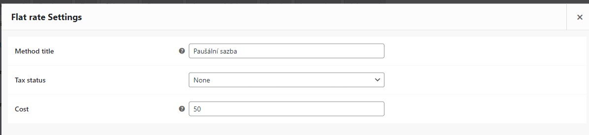

What we suggest is to set the shipping price including the tax and disable taxation so shipping cost will be correctly converted and rounded to up.
Please check and let me know if this works for you.

No, this doesn't work for our situation.
