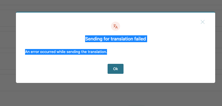

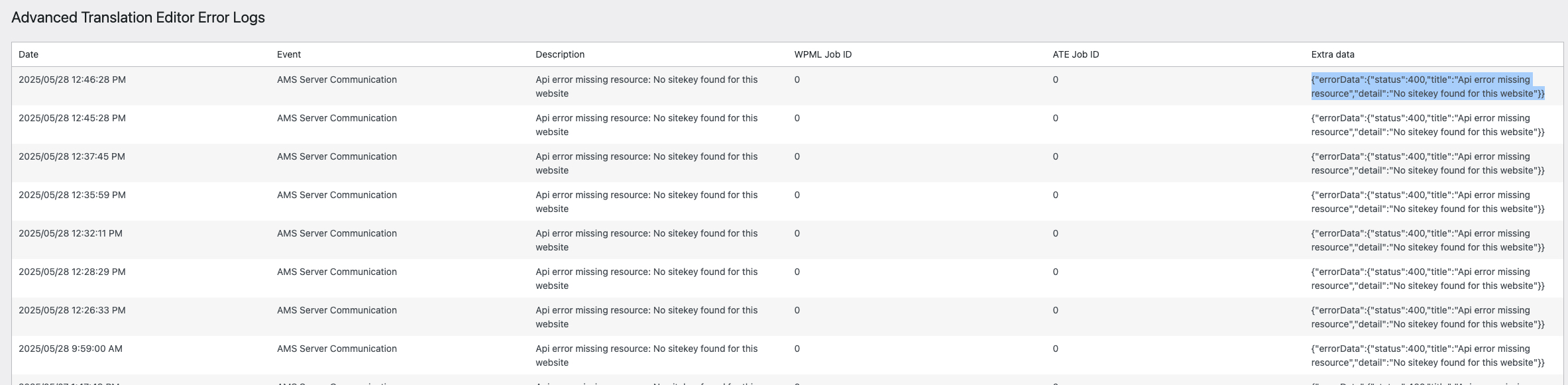

I am trying to duplicate all English posts to Spanish language on my website. After selecting 25 posts to duplicate and clicking 'Duplicate', I encountered an error. I have tried unregistering and registering my key again, but the issue persists. The error log can be seen at: hidden link. The issue can also be seen on this page: hidden link.
Sending for translation failed. An error occurred while sending the translation. The error log states: Api error missing resource: No sitekey found for this website. {"errorData":{"status":400,"title":"Api error missing resource","detail":"No sitekey found for this website"}}
Why am I getting an 'Api error missing resource: No sitekey found for this website' error?
How can I successfully duplicate English posts to Spanish without encountering this error?
