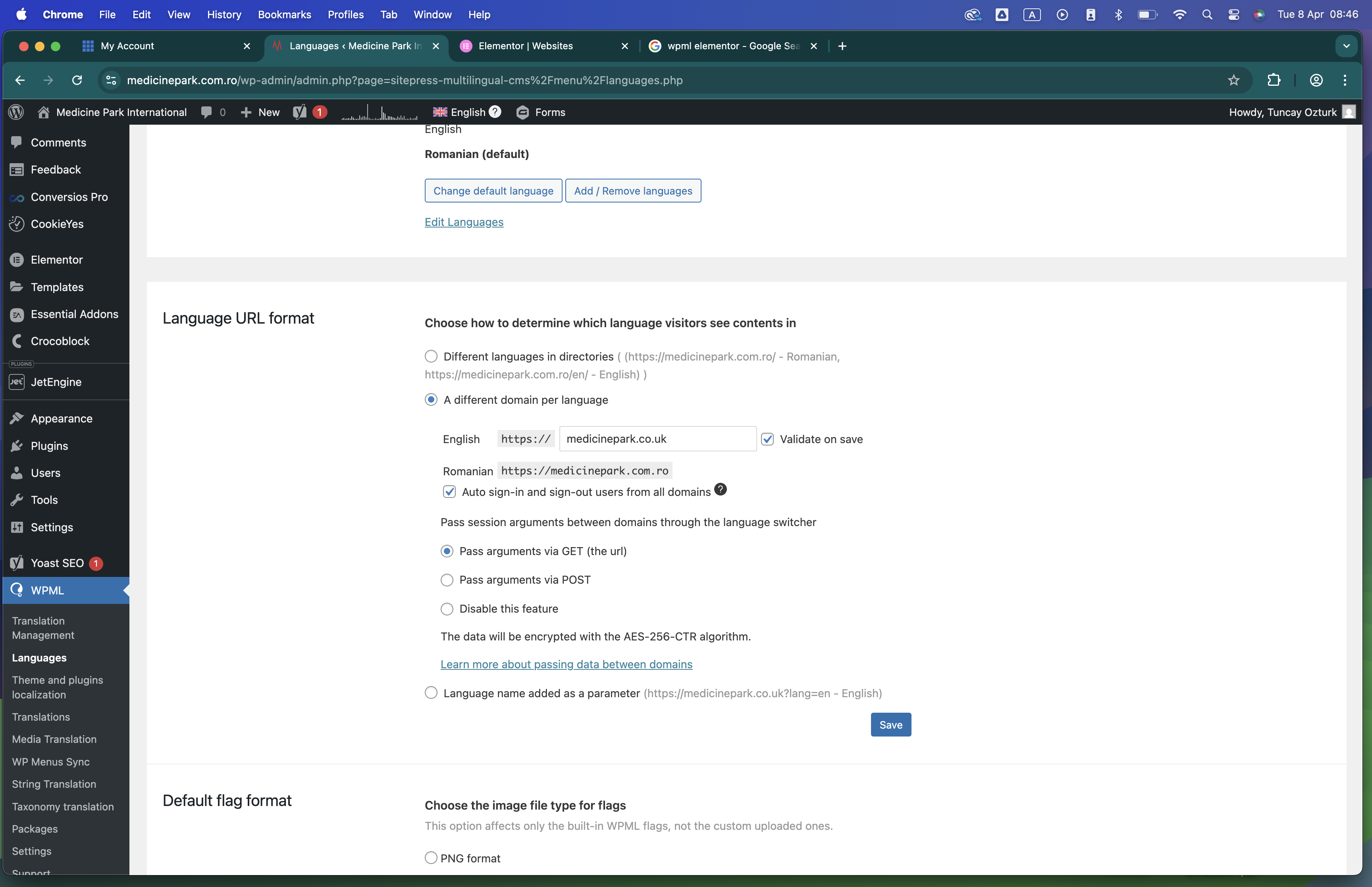

Here I am attaching the domain redirection settings. Please let me know if something is not ok. medicinepark.co.uk should go to english version of the medicinepark.com.ro but it is just redirecting to default page.

And here is the settings of the WPML plugin.
