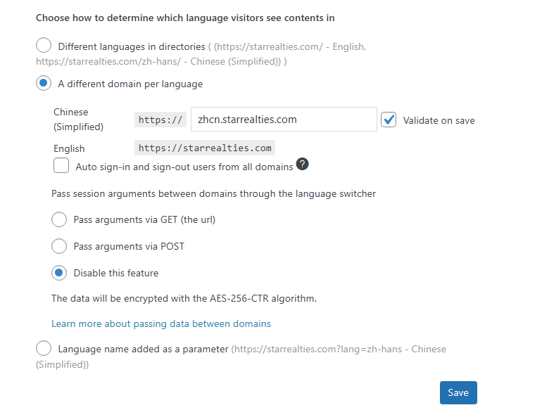

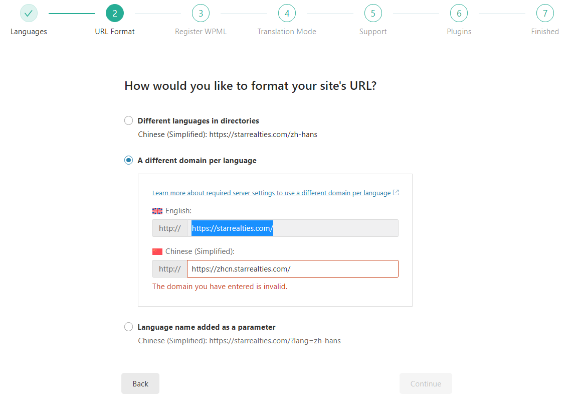

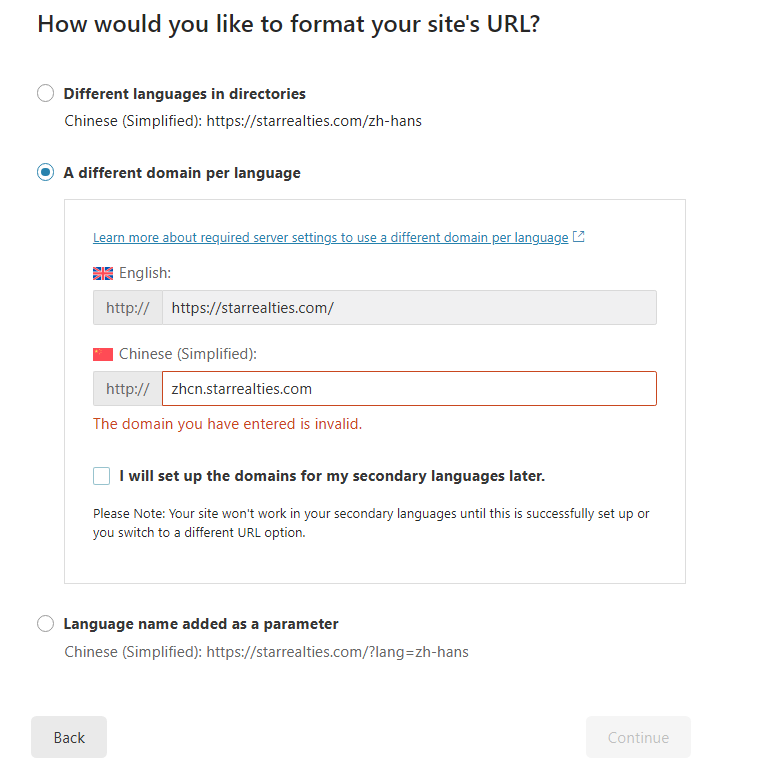

I am trying to set up different domains per language for my WordPress site using WPML. The primary domain hidden link is for English, and I want to use the subdomain hidden link for Chinese.
While entering the subdomain hidden link for Chinese, I got an error message 'The domain you have entered is invalid.'
Why am I getting the error message 'The domain you have entered is invalid' when setting up the subdomain hidden link for Chinese?

if i enter the subdomain "zhcn.starrealties.com" without the "https:", the setting is not complained, but it is default to the hidden link URL, I'm not confident whether this would create a security vulnerability. Please let me know whether it safe to move to the next step for WPML setup. Thank you in advance.

Yes, the HTTP setting is set automatically on the left, you can't add it double times.
Things should be fine if you add on the right as you said: zhcn.starrealties.com
Even if you don't have HTTPS in front, in the site settings, it might still redirect to the correct version on the front-end.
Please let me know how things go.

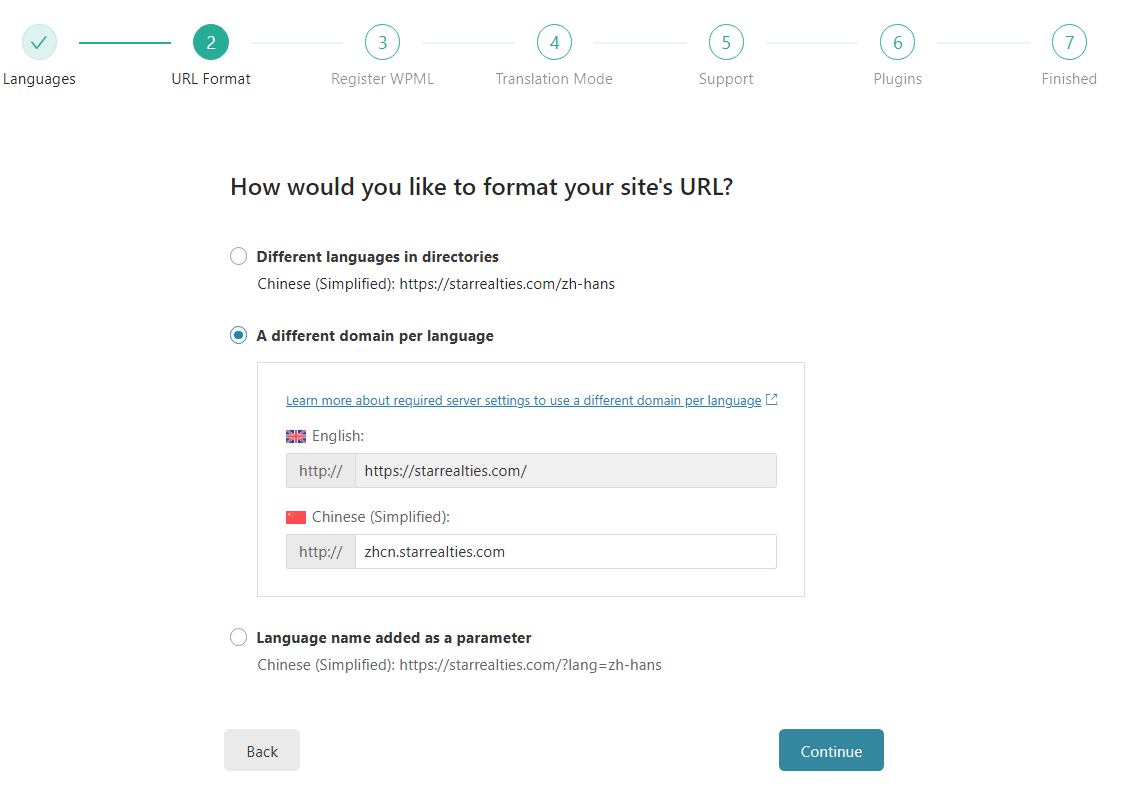

Thank you Mihal for your quick reply. After clicking the "continue" button, I still run into the problem. Please see the attached image.
Very confusing, does not know what to do next.

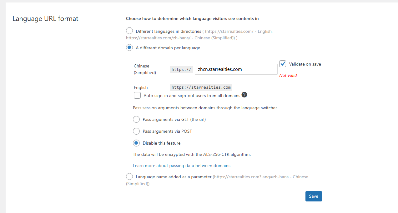

From the WP Dashboard, I selected WPML>>Language, I did see "Language URL format". After trying to use hidden link, the system kept showing "not valid" red message.

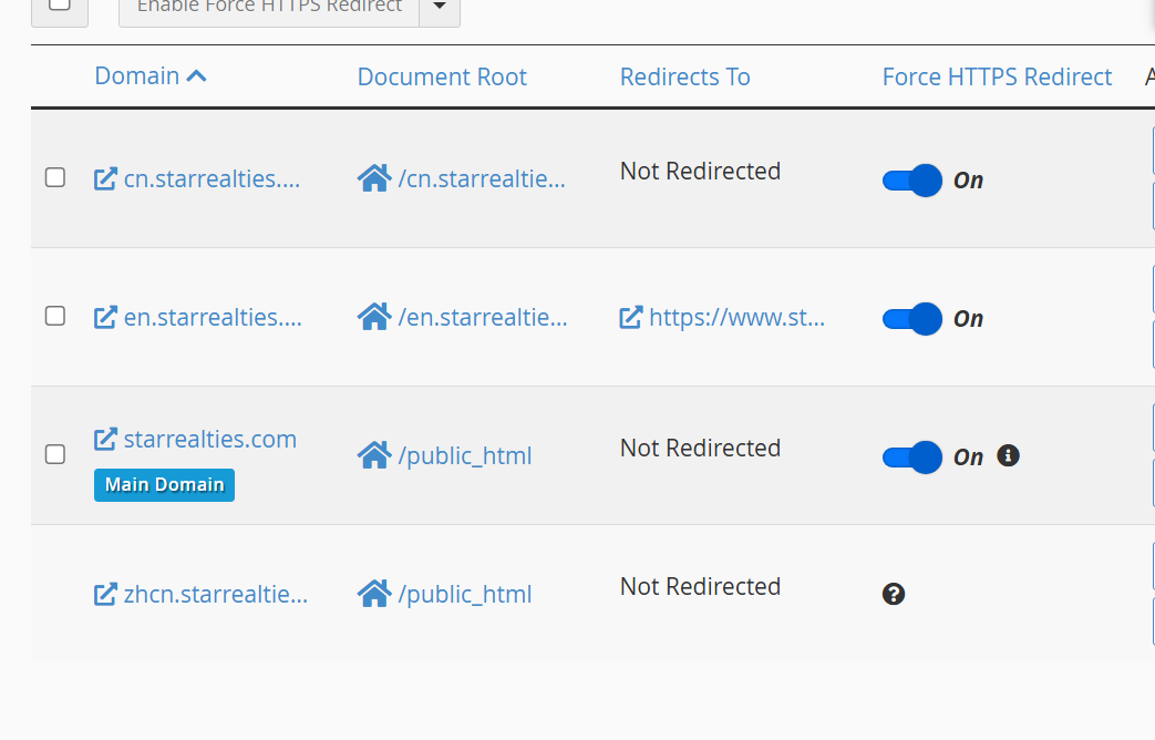

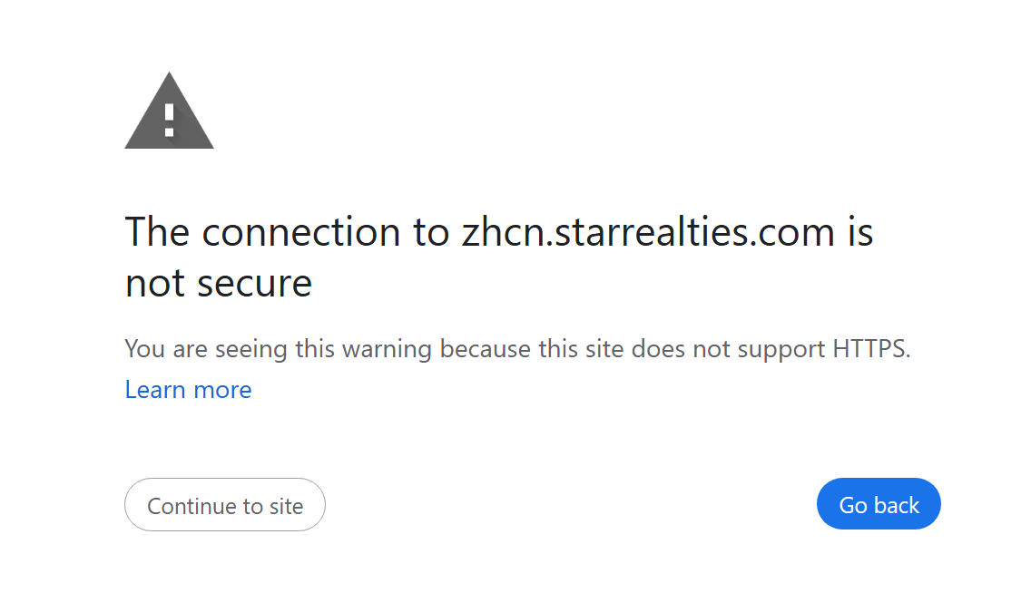

BTW, I found that my subdomain at my host company is not currently in "https" SSL enforced status. I talked to my web support and is waiting for the result.
Is this https related with the error in domain setup? do i need a WPML key for the Chinese sub domain?

Sometimes, the "not valid" note can be just a false-positive notification.
Did you get the chance to translate something, even for testing purposes, so that you can then try to access the translation and see if the subdomain is being used for the secondary language?
That's why I asked for point 1 here (https://wpml.org/forums/topic/setup-different-domain-per-language-en-zhcn/#post-15717844), in order to see what URL/domain is being used for the translation.

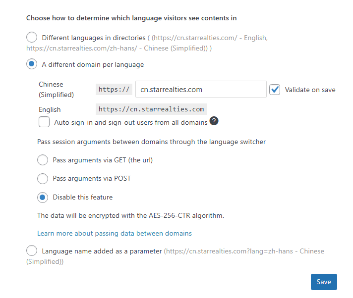

playing WPML in cn.starrealties.com (WP, SiteOriginal, Estatik, WPML),
whenever i activated the WPML Multilingual CMS plugin, the home page will be crashed, and more other issues,
Mihal, i want you login to my dashboard to take a closer look.

The installation for WPML on the primary domain got "not valid" error initially yesterday. However it passed "magically" today (image attached).

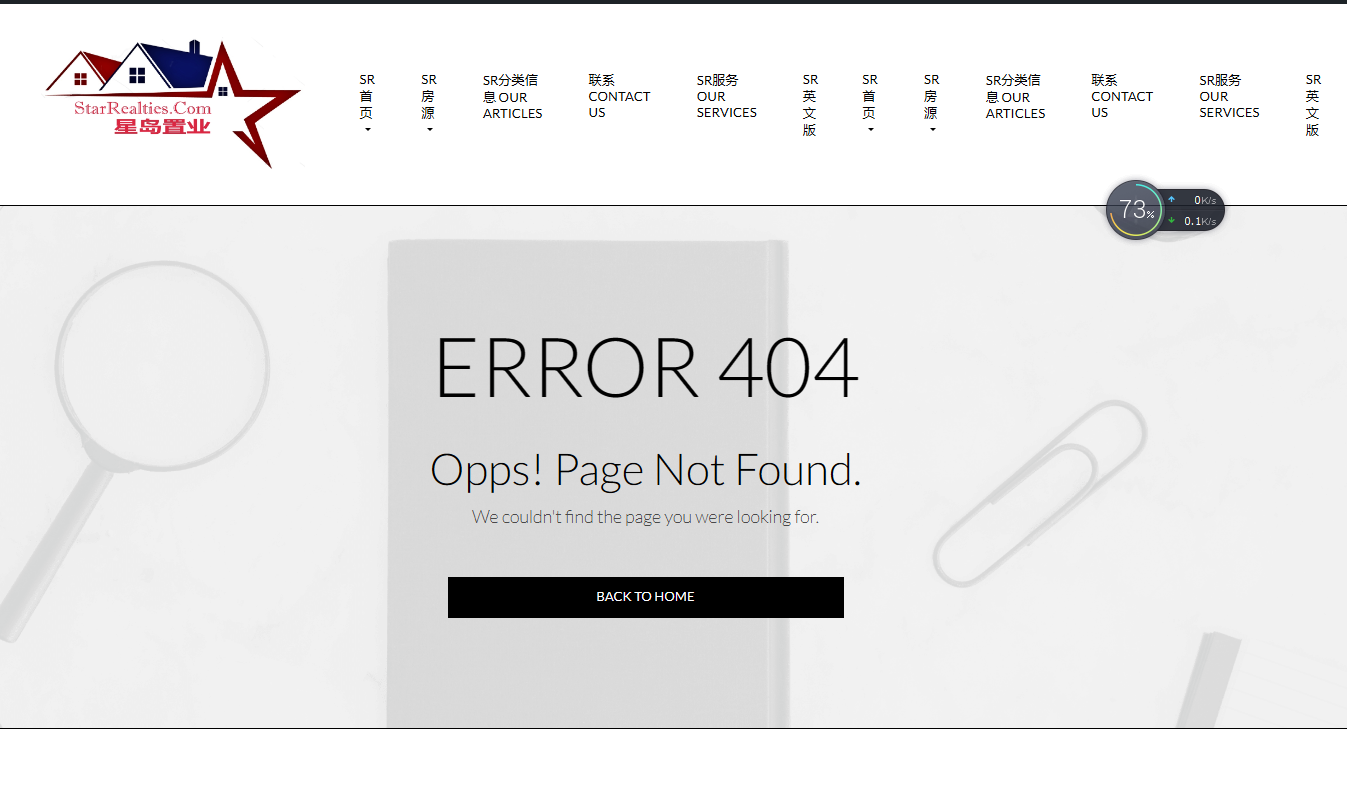

Tried basic translation on one page or post to Chinese, and the translation job was working as descripted.
But do not know how to use the url (subdomain) to show the translated post.
Tried to create a post in Chinese, also do not know how to retrieve the post.

• Starrealties.com : WP based, English version, Real estate search via IDX data from local board, Englist posts and pages
• Cn.starrealties.com: WP based, Chinese version, Real estate search via IDX data from local real estate board, the major real estate listings should be translated at the beginning, updated listings should be translated on the fly.
Since there is no much requirement to mirror posts and pages between the domains, the major translation job in the listings is originally in English. Please be noticed that the listings keep changing in real time (new listings, sold listings, and so on).
I would prefer to install WPML on cn.starrealties.com and complete the listings translation to Chinese in the subdomain.
When WPML CMS is activated, the homepage or other pages will be crashed.( images attached)
