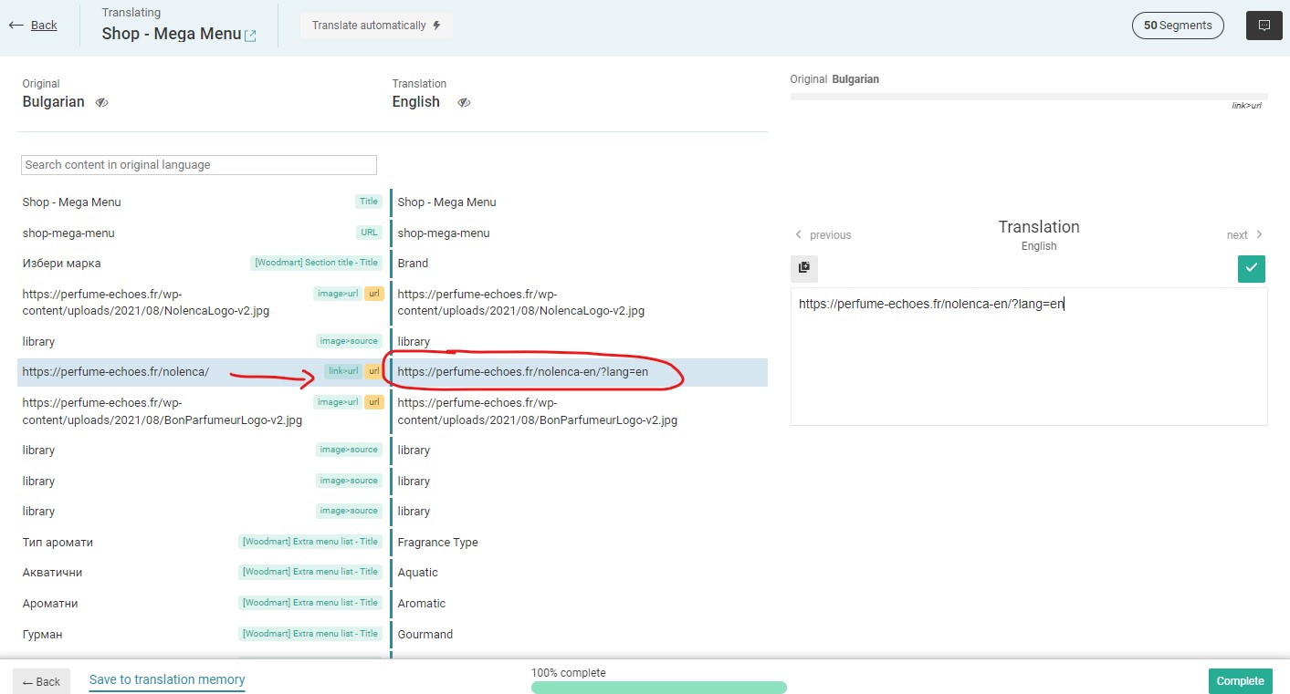

I was able to fix this by adding the following code in WPML -> Settings -> Custom XML Configuration:
<wpml-config>
  <elementor-widgets>
    <widget name="wd_image_or_svg">
      <fields>
        <field>image>url</field>
        <field>image>id</field>
        <field>image>size</field>
        <field>image>alt</field>
        <field>image>source</field>
        <field>on_click_action</field>
        <field>link>url</field>
        <field>scroll_y</field>
      </fields>
    </widget>
  </elementor-widgets>
</wpml-config>
Since that Elementor Widget (Image or SVG) used for brand logo and custom link, isn't a standard one, so it needed to be registered with WPML for translation.
The above code now brings all fields of that widget into the translation editor, where you can translate as needed (see attached). So now you can go to edit "Shop - Mega Menu" in default language and click pencil icon to update the translation. And when in Translation Editor, search for the links and translate accordingly.
For future references, if you use such a widget which doesn't bring its content for translation, you'll need to register it too. Check this guide https://wpml.org/documentation/related-projects/wpml-compatibility-test-tools-plugin/registering-custom-elementor-widgets-for-translation/ for details.

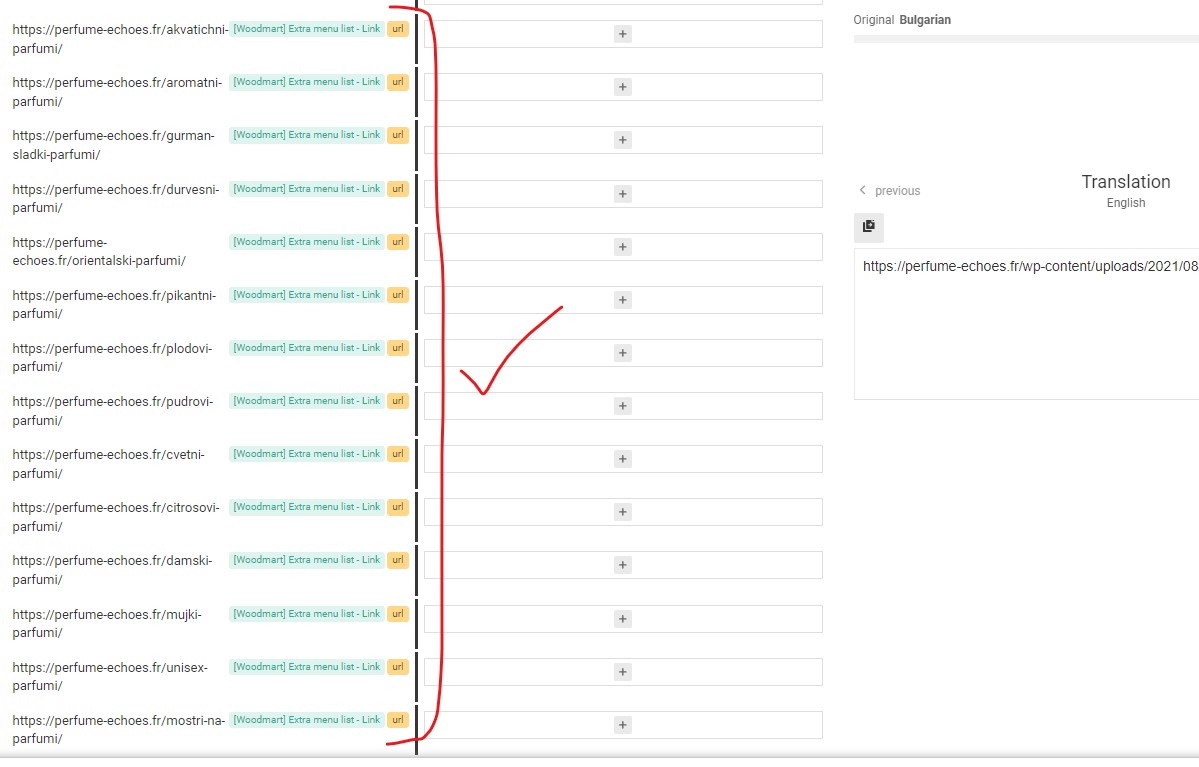

February 20, 2024 at 8:40 am #15320927
danielaH-13
Hi Waqas Bin Hasan,
Thank you for your response.
I have tried to translate the following one from the HTML block: "Shop - Mega Menu". But still unable to translate these links.
FRAGRANCE TYPE
Aquatic
Aromatic
Gourmand
Woody
Oriental
Spicy
Fruity
Powdery
Floral
Citrus
GENDER
For Her
For Him
Unisex fragrances
Discovery sets

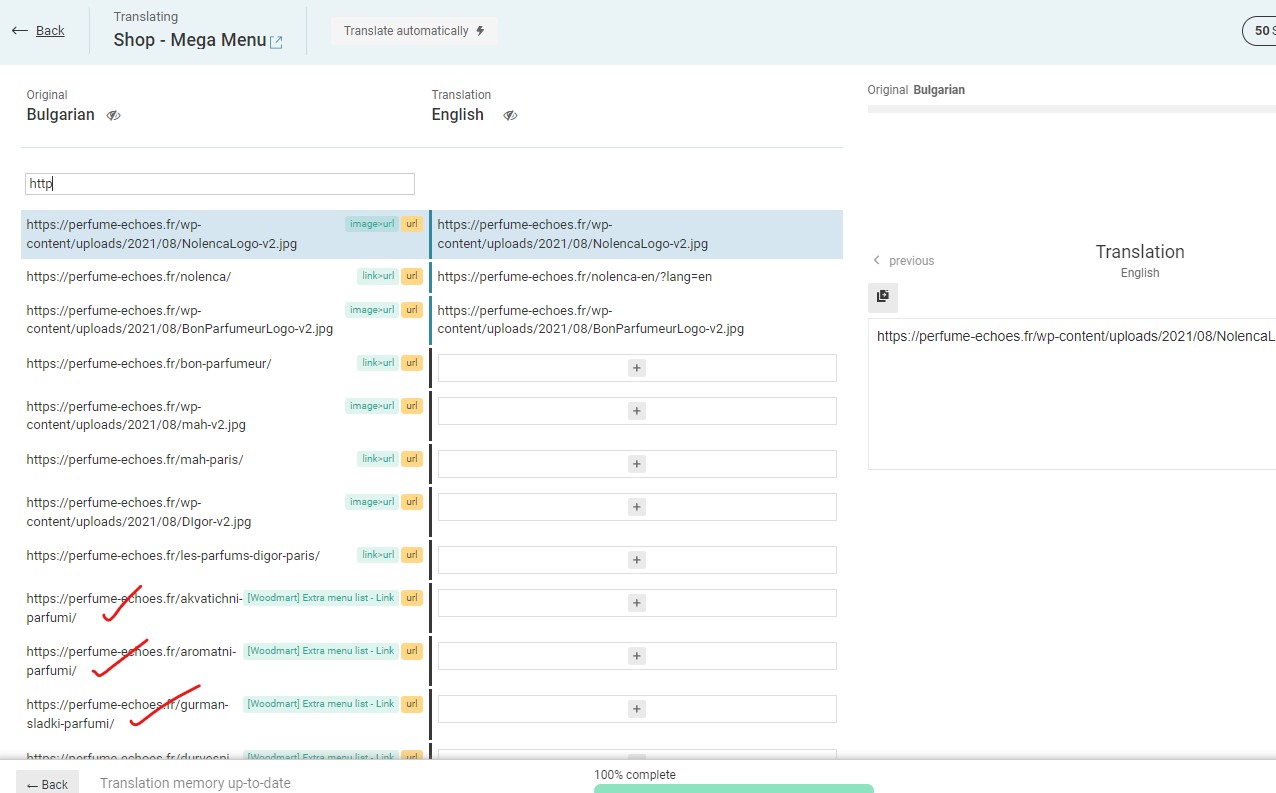

February 20, 2024 at 11:21 am #15322198
Waqas Bin Hasan
WPML Supporter since 05/2014
These are all available in ATE. You need to search for "http" and the ATE 'll show all these links (see attached).
Check this guide https://wpml.org/faq/how-to-translate-urls-shortcodes-and-html-attributes-using-the-advanced-translation-editor/ for details.

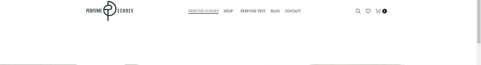

Thank you for your help, I managed to translate everything. However, there is a gap between the header and the slider when the website is translated. And if you click on Shop you will see that the images are missing and just plant text. Could you please, help me with this one?
Thank you in advance ,
