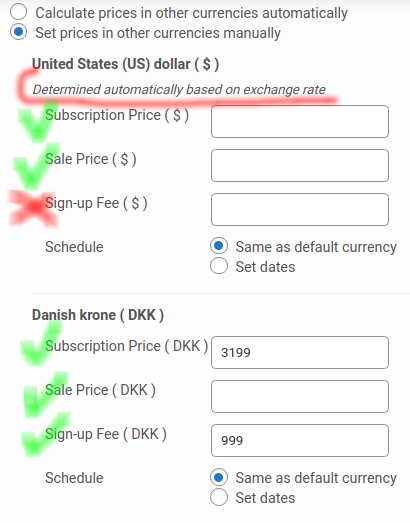

I am trying to use the default rate exchange having multiple currencies on variable subscription product. I set one secondary language with a fixed sign-up fee and leave the remaining secondary fields untouched.
I expected to see pricing with an exchange rate calculated sign-up fee when I select e.g. GBP or USD.
Instead, I got price without any sign-up fee for GBP and USD.
Attached image of the Variations currency configuration.

Then under a subscription variant, you need to set custom prices for only one of the currencies - see attached wp-admin screen shot.
The subscription fee is now missing for Euro as the currency calculation will fail for the one without custom price specified, see attached store screen shot.
The code diff I provided for your verification fixes the issue as far I can tell.

The attached screenshot states that the developers had the very same expectations as I have to the exchange rate calculation feature...
Subscription price and sales price gets calculated. But the subscription fee is left out...
Who on earth would have made up such a requirement in the first place? 😉
