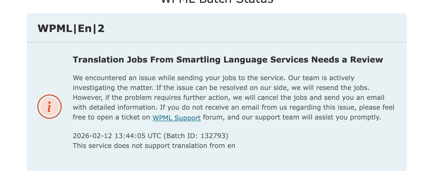

We have configured WPML on wordpress to have two languages:
en and es.
However when trying to send a translation job, on wordpress it shows up as sent to smartling successfully. However checking this link (hidden link) which we get by visiting the Translation Dashboard > Translation Jobs in WPML I get the message `We encountered an issue while sending your jobs to the service. Our team is actively investigating the matter. If the issue can be resolved on our side, we will resend the jobs. However, if the problem requires further action, we will cancel the jobs and send you an email with detailed information. If you do not receive an email from us regarding this issue, please feel free to open a ticket on WPML Support forum, and our support team will assist you promptly.
2026-02-12 13:44:05 UTC (Batch ID: 132793)
This service does not support translation from en`
Can you please investigate and let us know what we need to do to get this service to work.
Thank you

February 12, 2026 at 6:46 pm #17818353
Thanks for your patience. Our 2nd Tier Support checked, and the issue happened because of wrong language mapping. They have added the correct mappings and now the issue is resolved. Please check.
