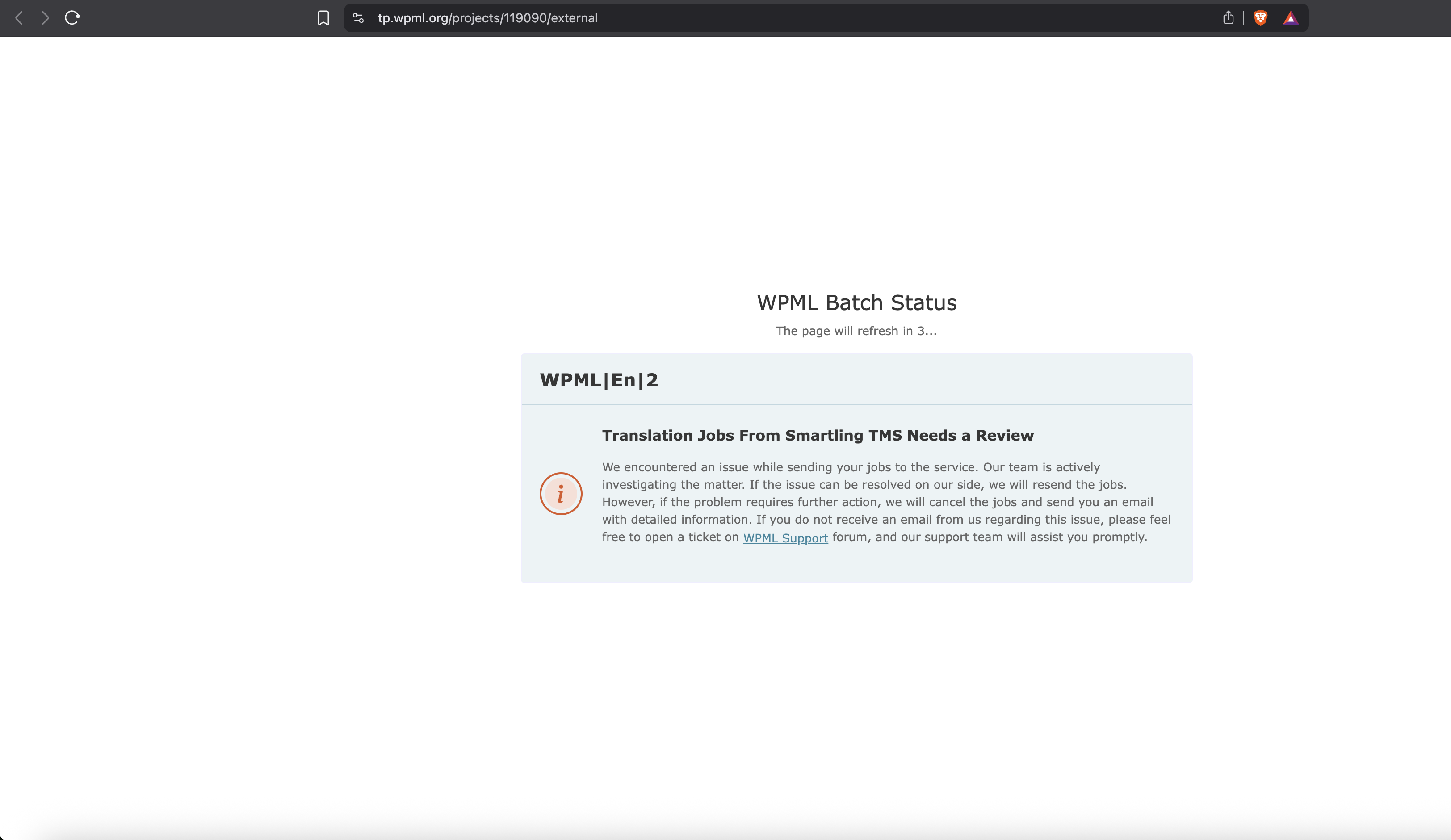

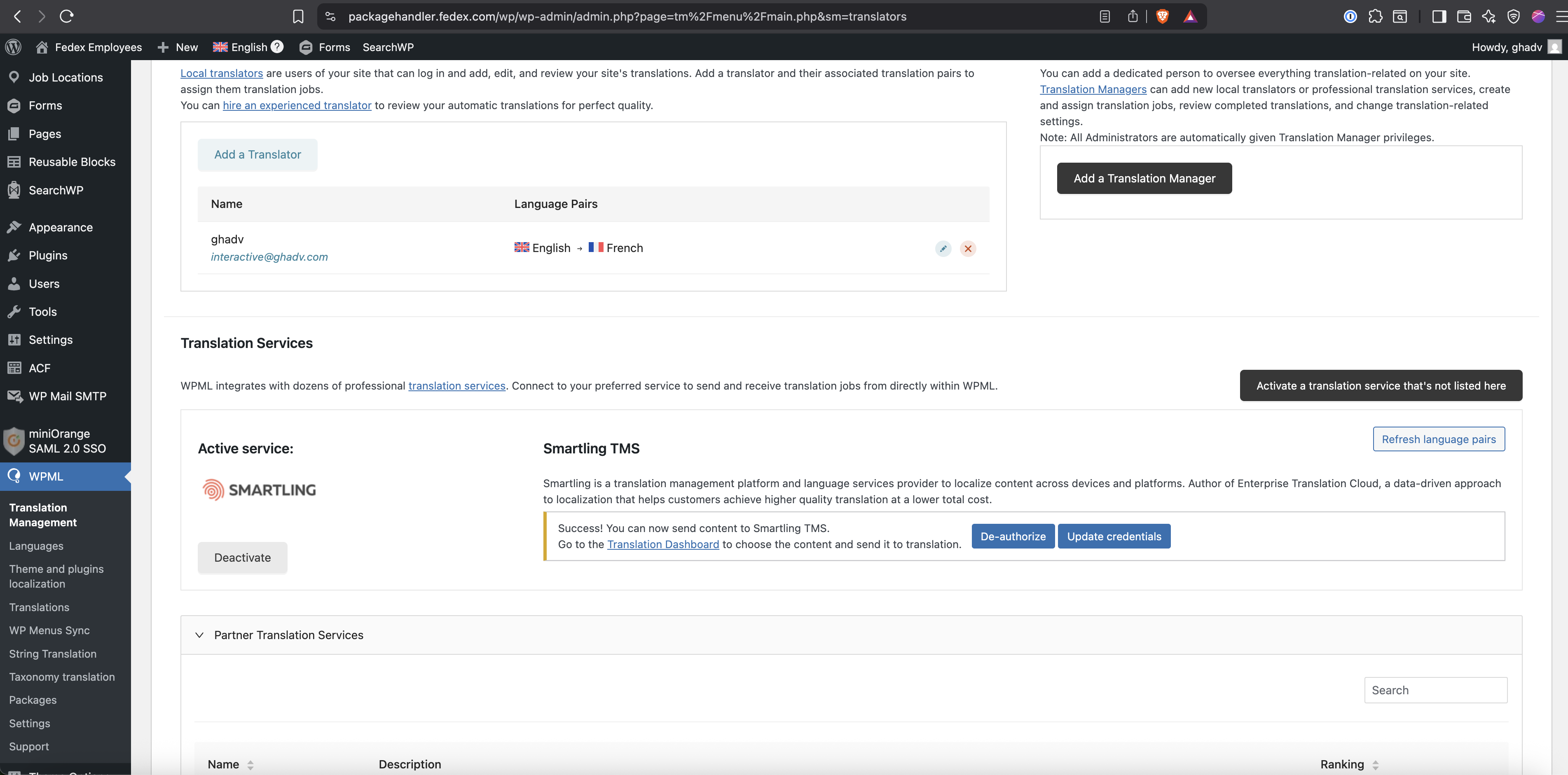

I am attempting to translate content through the Smartling Connector provided by WPML. Integration with the connector was successful, and all settings are confirmed correct both by Smartling as well as WPML itself.
WPML's Batch Delivery fails, and no emails are sent to us with an update. Jobs are subsequently cancelled with no notifications provided from WPML, and no reasons are given as well. I received a notice stating: 'Translation Jobs From Smartling TMS Needs a Review. We encountered an issue while sending your jobs to the service. Our team is actively investigating the matter. If the issue can be resolved on our side, we will resend the jobs. However, if the problem requires further action, we will cancel the jobs and send you an email with detailed information. If you do not receive an email from us regarding this issue, please feel free to open a ticket on WPML Support forum, and our support team will assist you promptly.' No emails are sent, and no support is given.
Why is WPML's Batch Delivery failing?
Why are no notification emails being sent regarding the job cancellations?

I’ve spent some time investigating the issue and found that it was caused by an incorrect language configuration. I’ve corrected the settings, and everything should be working properly now.
Could you please try sending another job and let me know if it works as expected?

We can confirm that the batch job is no longer showing an error. We are checking with our Smartling representative to see if everything is coming through on their end and will follow up if everything moves through as expected.
