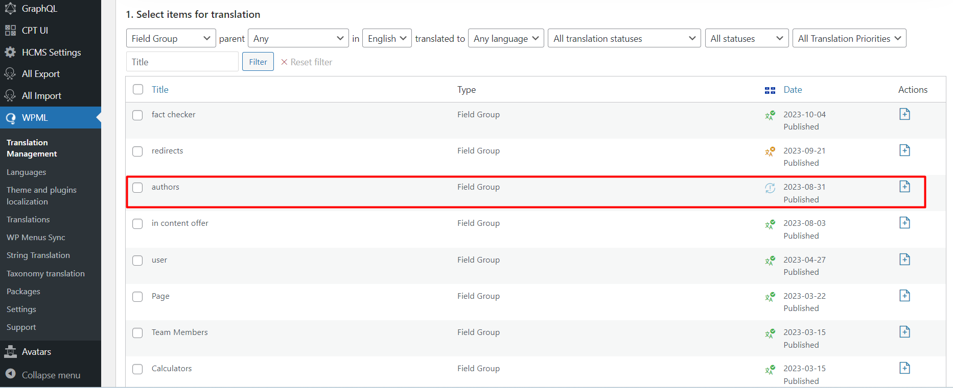

julienB-20
Not a template, they are real pages. Check the screenshot, they are not translated with string translation.

Laura
WPML Supporter since 05/2018
Fields group are not pages, they're similar to strings. If you're using Fields group, it's expected you don't see the authors' "pages" in the sitemap as they are not really translated pages.
At the moment there's no way to add them to the sitemap.

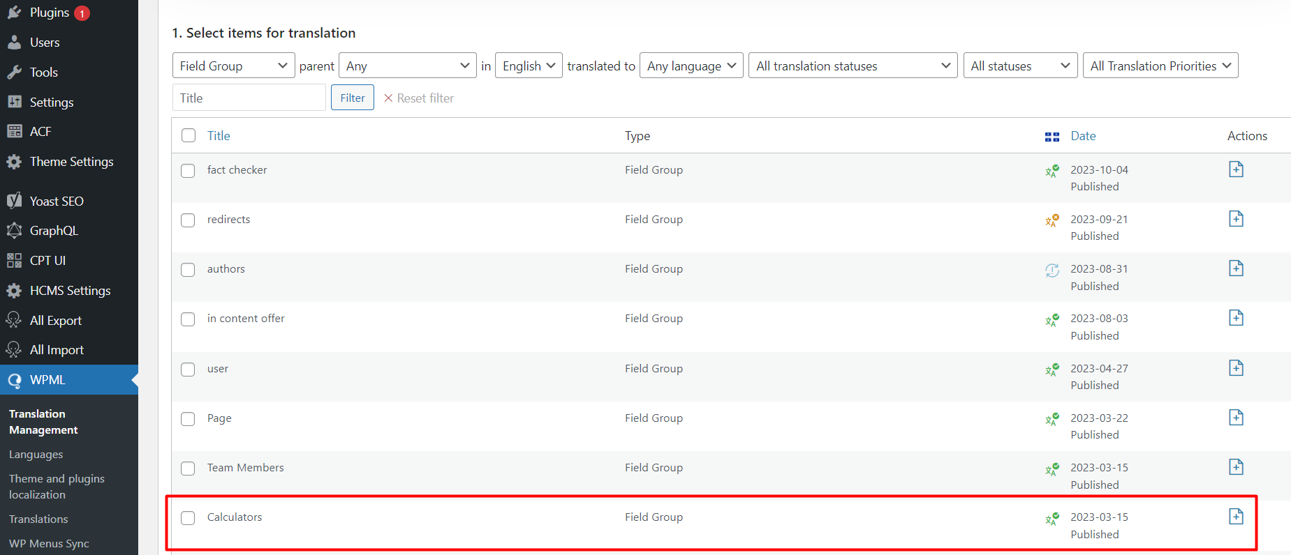

julienB-20
Ok then calculator is also a field group why calculator sitemap have both /en/ and /fr/ versions in it.
Check it please.
October 27, 2023 at 2:02 pm #14680069
Laura
Calculator is also a custom post type (authors is not) so there are actual posts being translated. The fields you see there are fields related to that kind of post type, not the only content you translate.

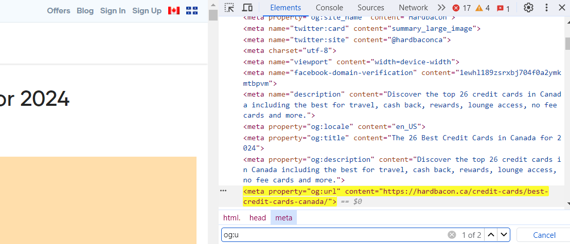

julienB-20
Also, yoast is not adding the page URL with /en/ version in the "og:url" tag.

Laura
Yoast shouldn't add the /en/ category at all.
