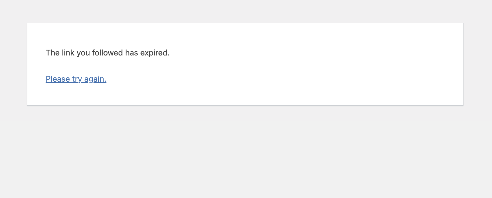

I clicked on your link and tried (several times) to add the Divi Theme to the Sandbox website. I could navigate to Themes and select one from my computer however when I clicked upload I got an error message saying the link expired (see screenshot). I tried logging out of wpml and logging back into my account and clicking your link again but I couldn't get it to work. I am on a mac using the chrome browser. I am stuck here...
Thanks for your help and I apologise for the very complex situation...
