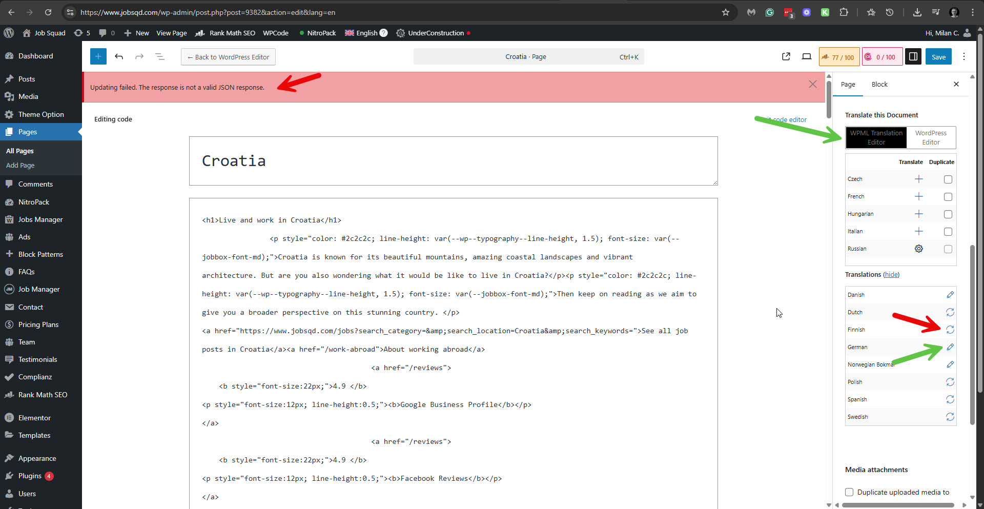

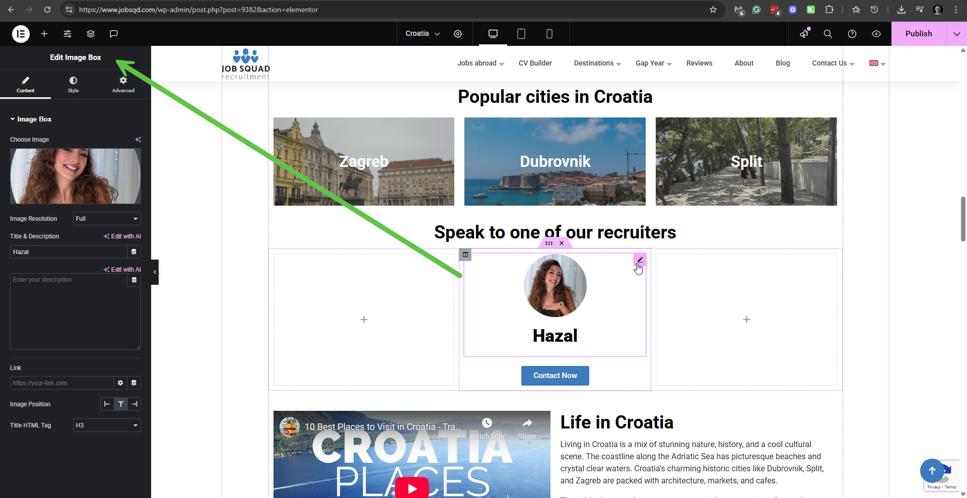

The problem you mentioned, which occurred at the beginning of May, is not due to WPML, as far as I can understand. When I edit the Croatia page in English, the default language, I see an error message: 'Updating failed. The response is not a valid JSON response'. However, from the front end, I can edit with Elementor, and I can see that the recruiter has been added with an Image Box element. Please see the attached screenshot. You should not edit the translations with Elementor to replace the recruiter. You should edit it with WPML's Translation Editor, and this is how it is set for this page. As proof of this, I can see that it worked in the German language (the pencil icon shows and Hazel is the recruiter on the German translated page. I can see that the Finnish language needs an update (as indicated by the circled arrow icon). Please see the attached screenshot. It appears that you need to update Finnish with the Translation Editor to ensure Hazel is displayed as the recruiter in Finnish.

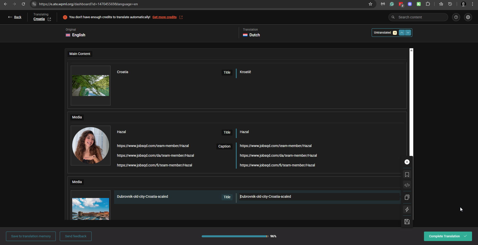

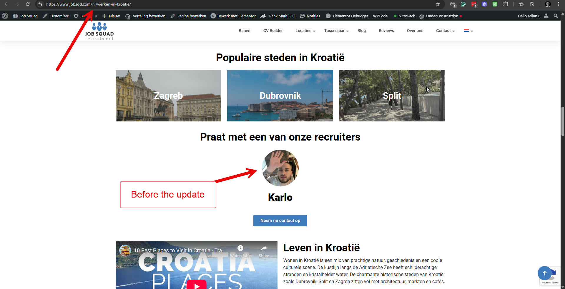

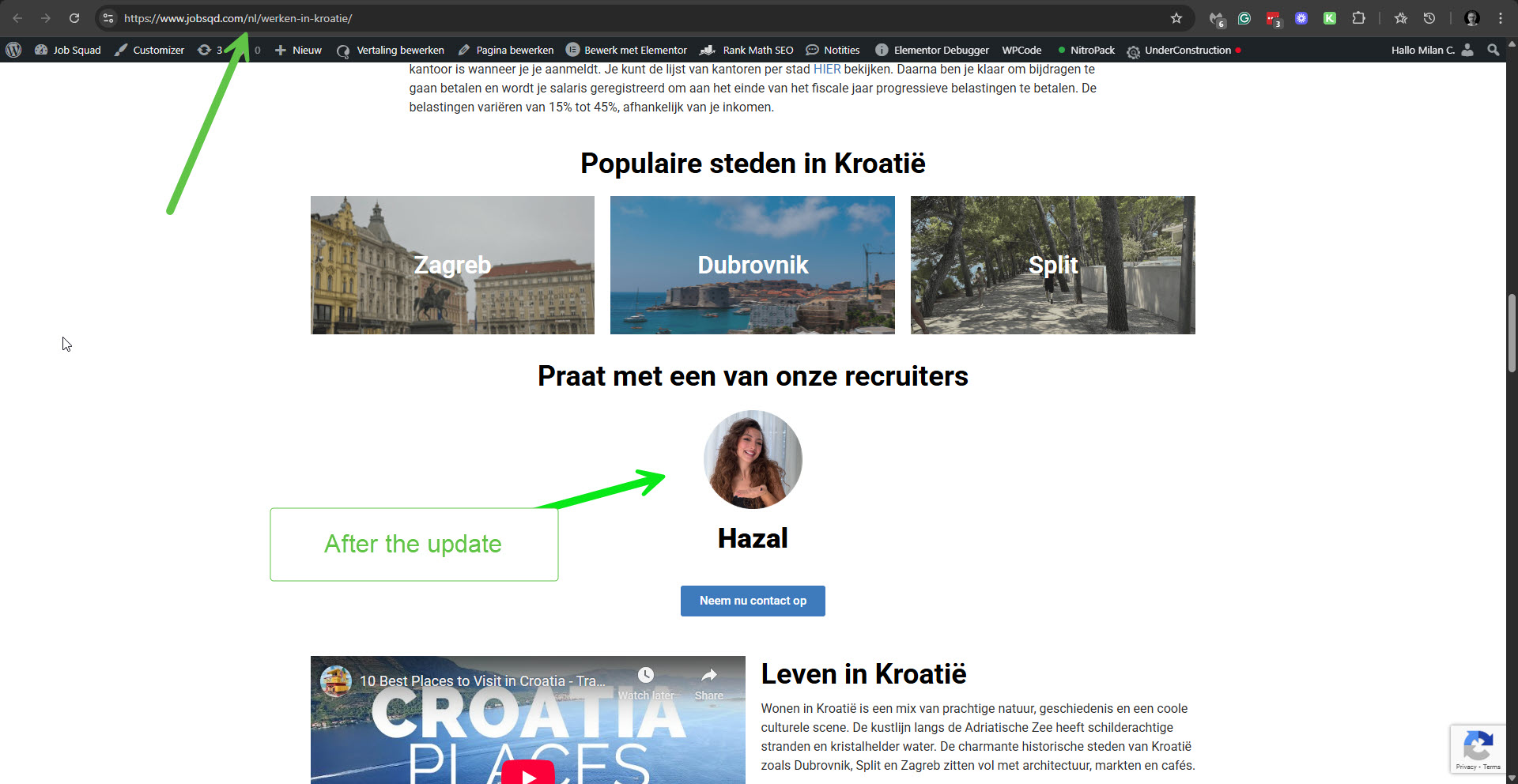

You don't need to update the media library or take any other specific steps except updating the translation with WPML's Advanced Translation Editor. This will update the image, name, and link of the recruiter. I tested it with the Dutch translation, and it worked. I opened the translation with the Advanced Translation Editor and noticed a few strings that needed updating. I noticed that the media for Hazel also required an update. Please see the attached screenshot, hazel-in-ate.jpg. Then I saw the Dutch page has been updated with Hazel's image. Please see the before-and-after screenshots. before-update.jpg and after-the-update.jpg.
