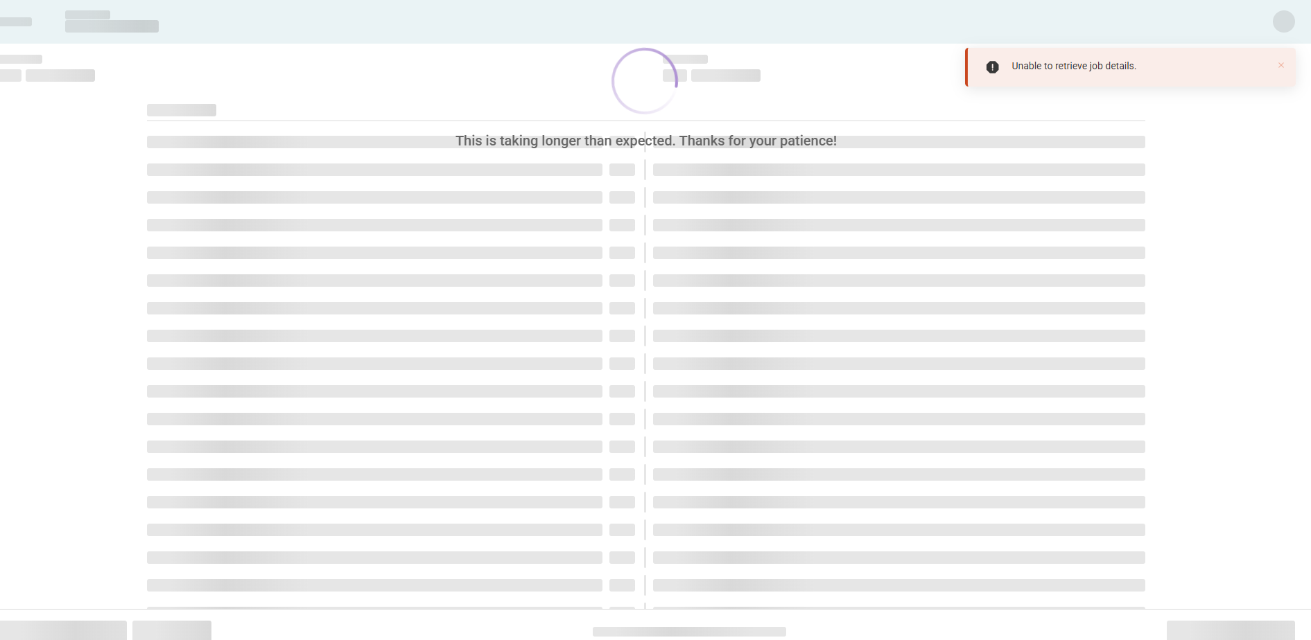

amandaR-4
I deleted and re-added my user. Then, I saw the translations that I sent but when I opened the first form to translate, this happened (it stays like this all the time):

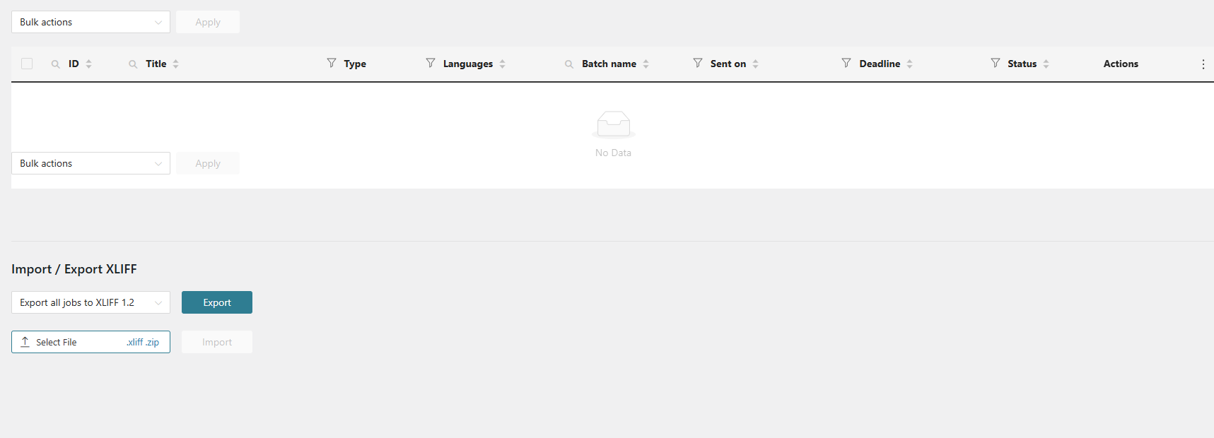

amandaR-4
I run the above commands and again I had the same issue when I tried to manually update the form. Also now when I open the Translations I see this (please see the attached screenshot).

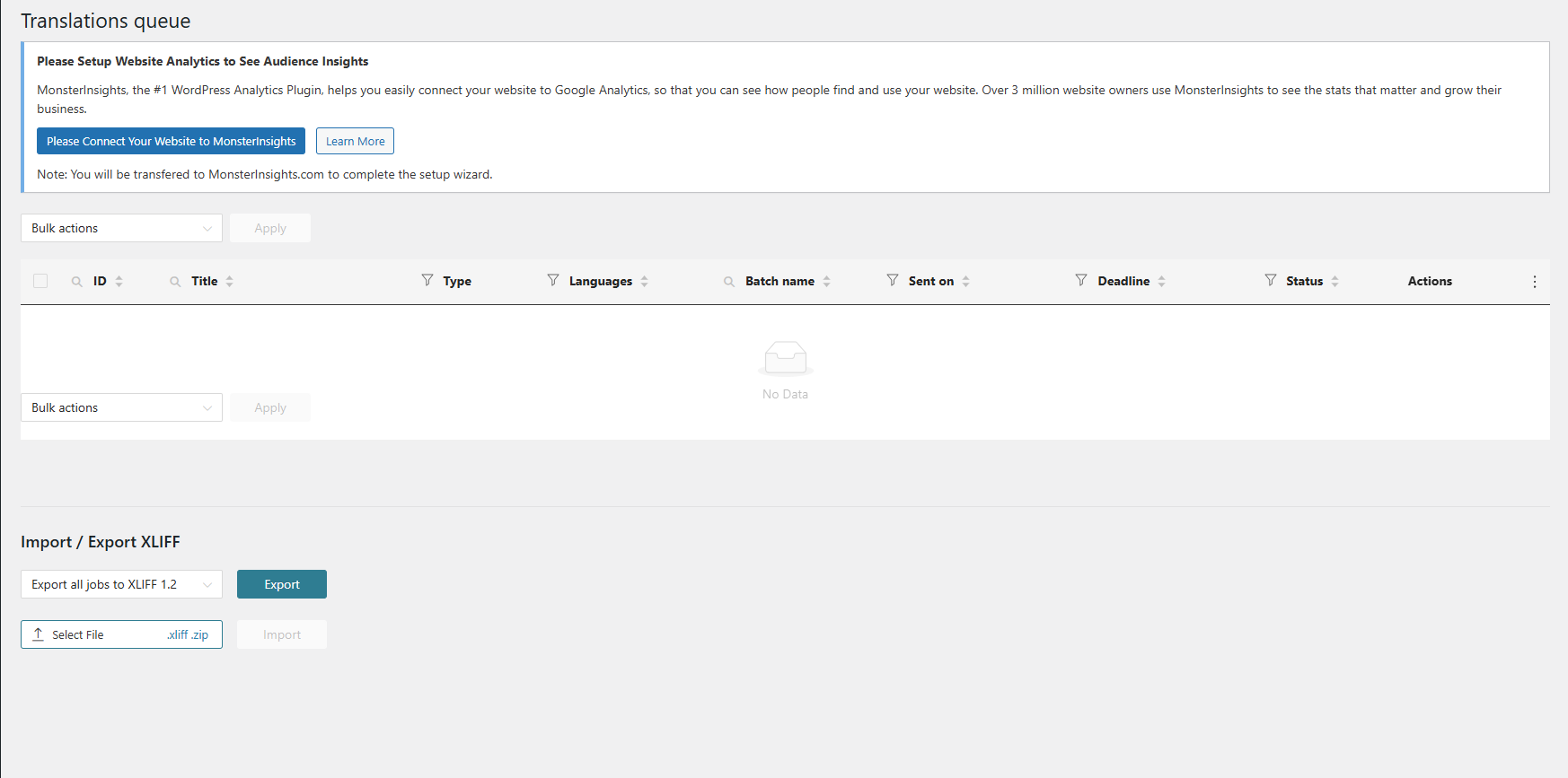

amandaR-4
I still see the following:

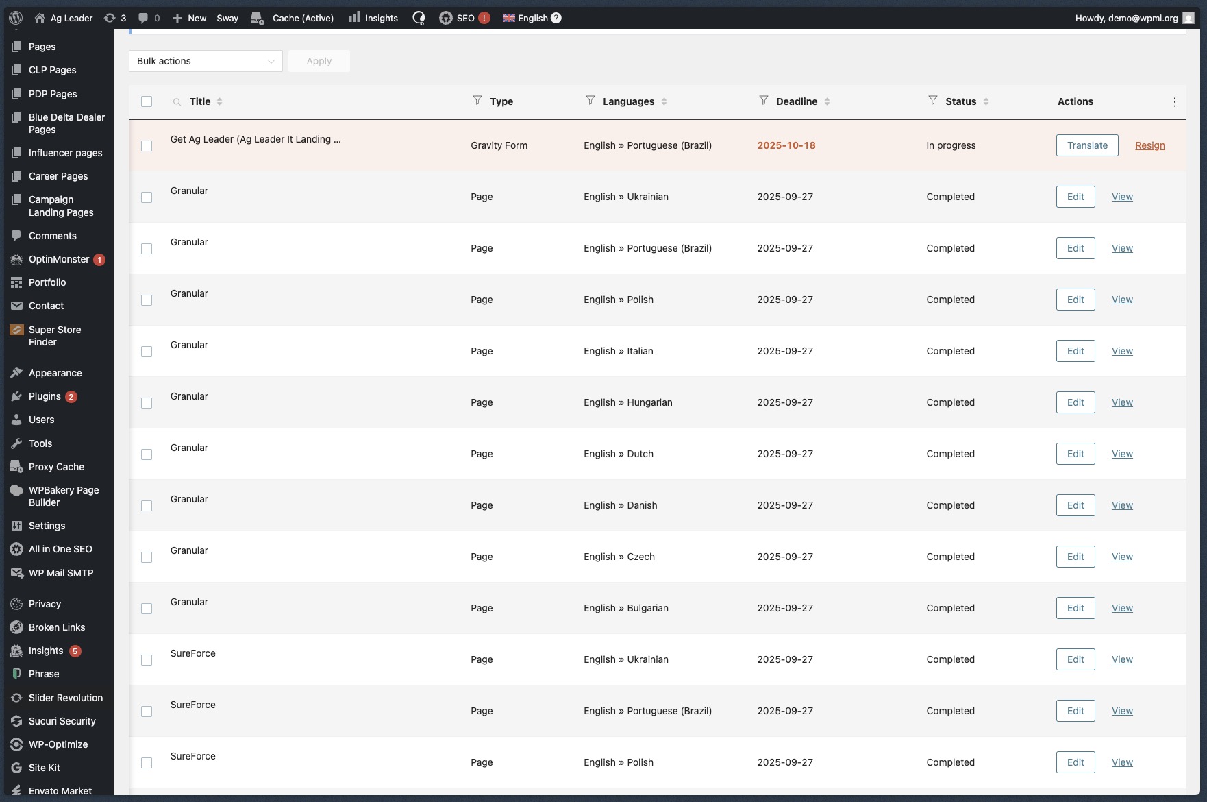

Lucas Vidal de Andrade
WPML Supporter since 11/2023
Hey there,
I still see it working flawlessly to me. Check the image attached.
Please see by sending new Jobs, if they show up on the Translation Queue. Alternatively, check with another admin user — I've noticed that there are 2 users with the same email on the website, which might be causing that.

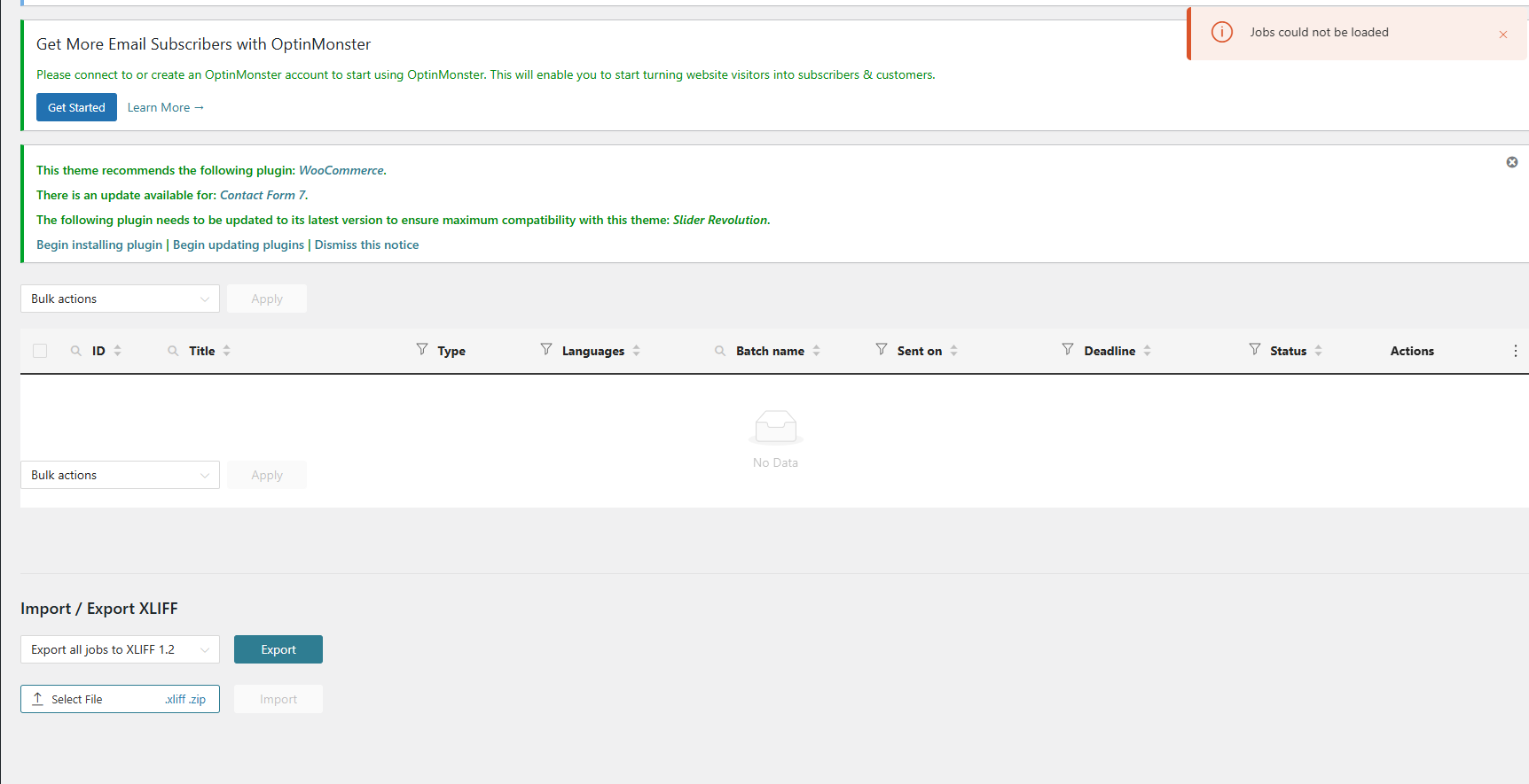

amandaR-4
I have checked my user and the email is not being used by another account. I also created a new admin user, added it to the Translators group and sent the forms for manual translation. After that, I could see the translation jobs but when I opened the first form to translate the same error occurred again. Since then, the same error has appeared on the Translations tab as well. Please see the attached screenshots.
