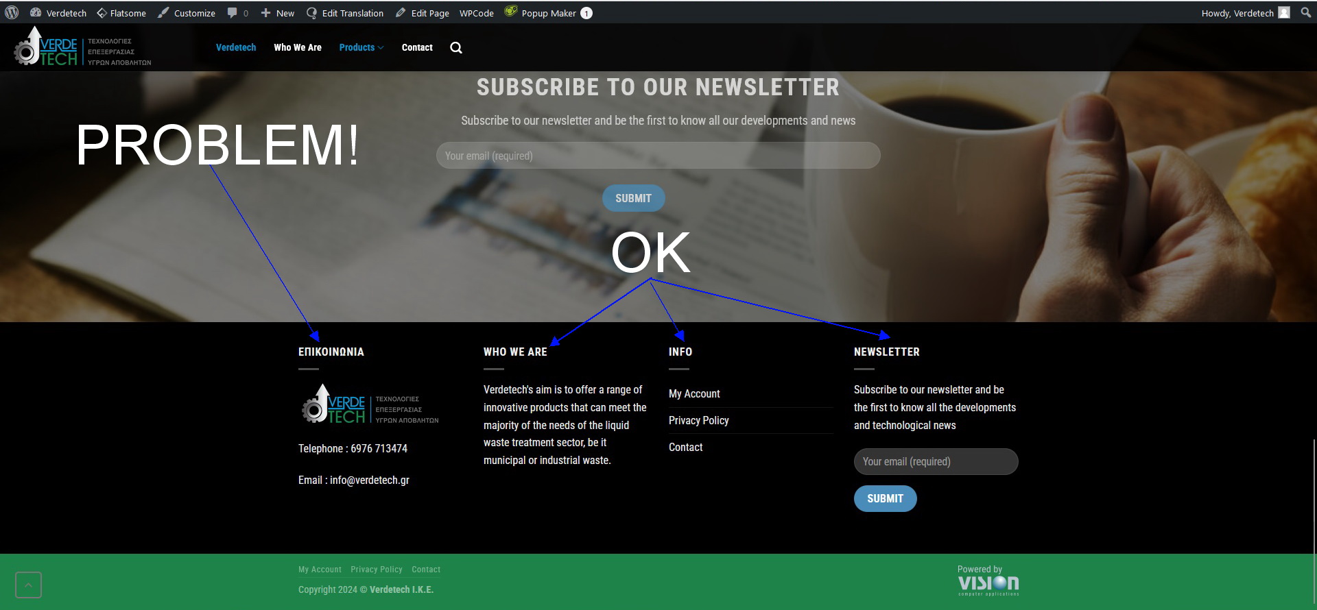

Dear Sir,
ONE widget title NOT translated. I have many widgets which are translated BUT this NOT:
<span class="widget-title">ΕΠΙΚΟΙΝΩΝΙΑ</span><div class="is-divider small"></div>
Thanks in advance!

michaelD-126
Dear Sir,
I've already know the widgetrs translation and all the widgets are OK EXCEPT one :
(Image : Verdetech1)

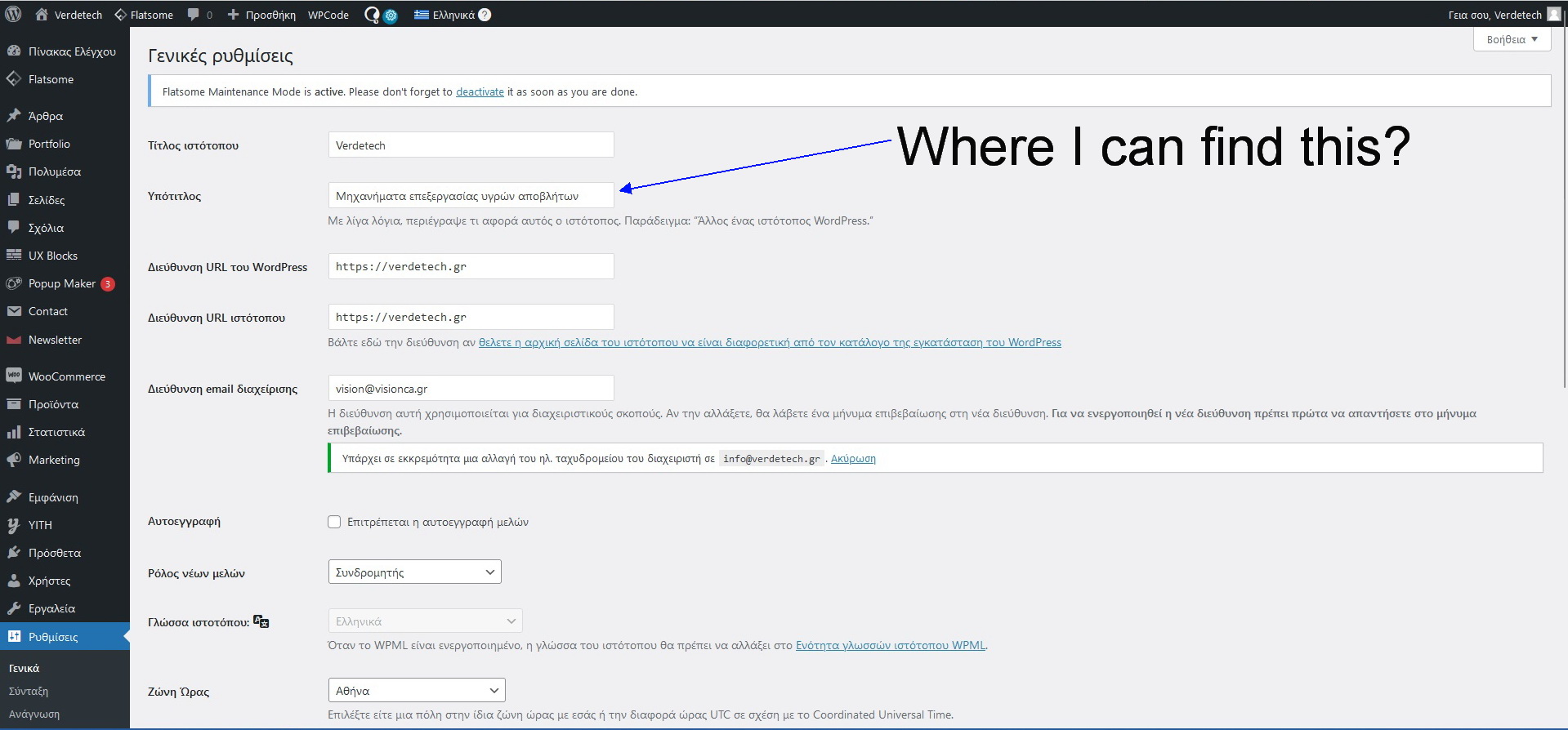

I don't use any SEO plugin so I can't find the Subtitle of my website to translate!

Thanks in advance!
