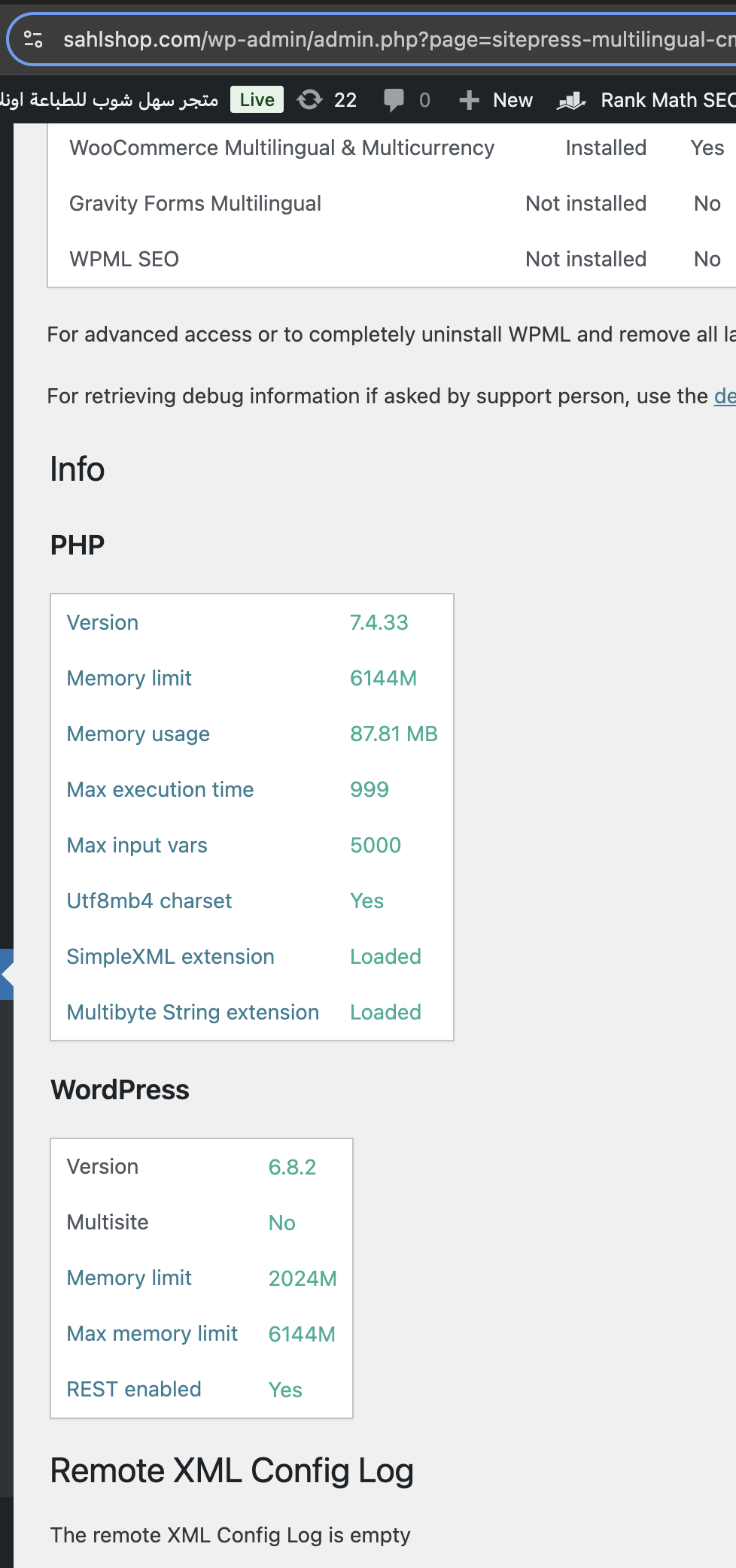

Did you recently downgrade the PHP Version? It is important to keep it updated in order for both issues to be resolved, otherwise the original issue will re emerge.
At the moment the site is showing PHP 7.4 again.

Please upgrade the PHP Version as originally suggested to PHP 8.0.0 or higher, if you are not sure on how to do this, your hosting provider can do it for you.
Your WP environment is showing a warning regarding this as well.
We have an active escalated ticket on the issue you are experiencing and our team is awaiting for your team to upgrade the PHP Version for us to move forward with any debugging if need be.

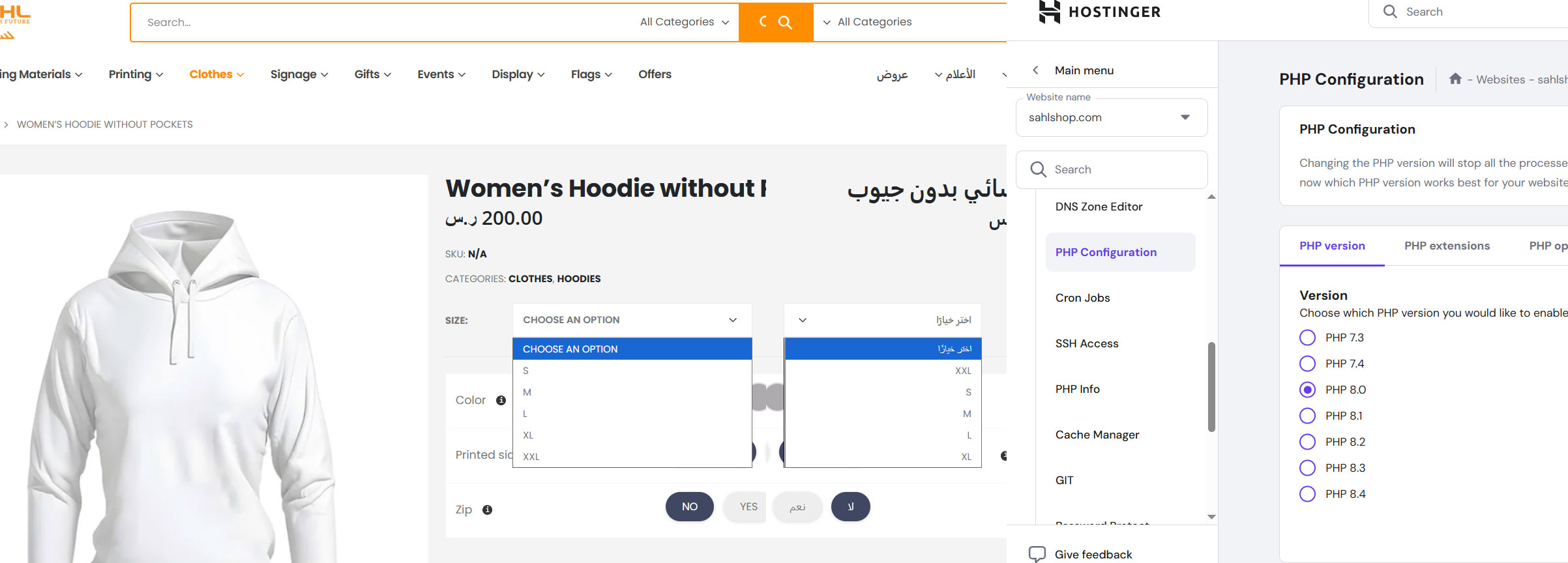

platinumC
php 8 and 8.1 and still same problem

Bobby
WPML Supporter since 04/2015
Please upgrade the PHP version and leave it updated.
Our needs to further debug this issue, if it is not in the right PHP Version we are not able to proceed.

dear... i updated .. the website php 8... then i returned to original 7.4... when updated did not work
