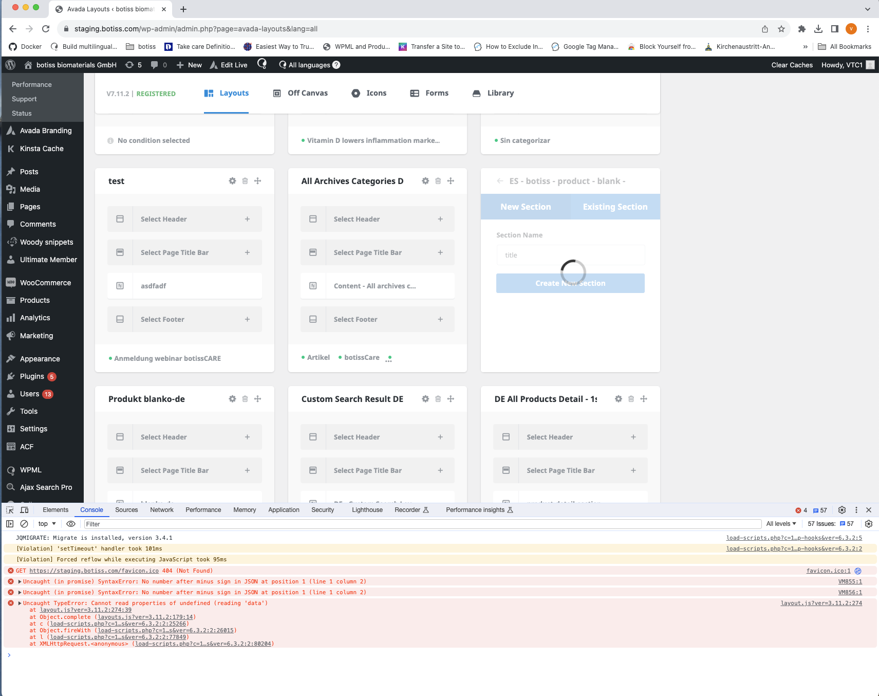

Debug: I have turn on the debug mode via wp-config.php
I changed the config for avada layout to " do not translate ". I think that is unnecessary to have a different layouts for our website. I thought , we just need to translate the sections and the design will be changed automatic on frontend.
However, I saw an error of Javascript "layouts.js" in Avada THeme by ajax loading that when I click loadmore or search any information the avada them stops working. I need to copy the website to localhost and try to fix this problem.

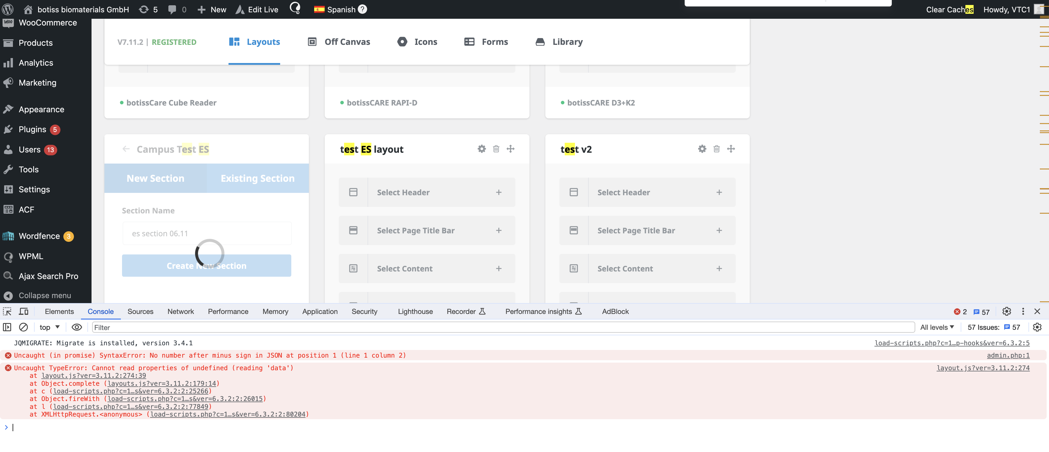

botiss-biomaterialsG
I think it is an error or conflict in wpml , because I created new website with avada theme that everything is working well without error. But for the website the ajax of avada js is not working when I turn off WPML Plugin.
Could you have a look about that ?
thanks

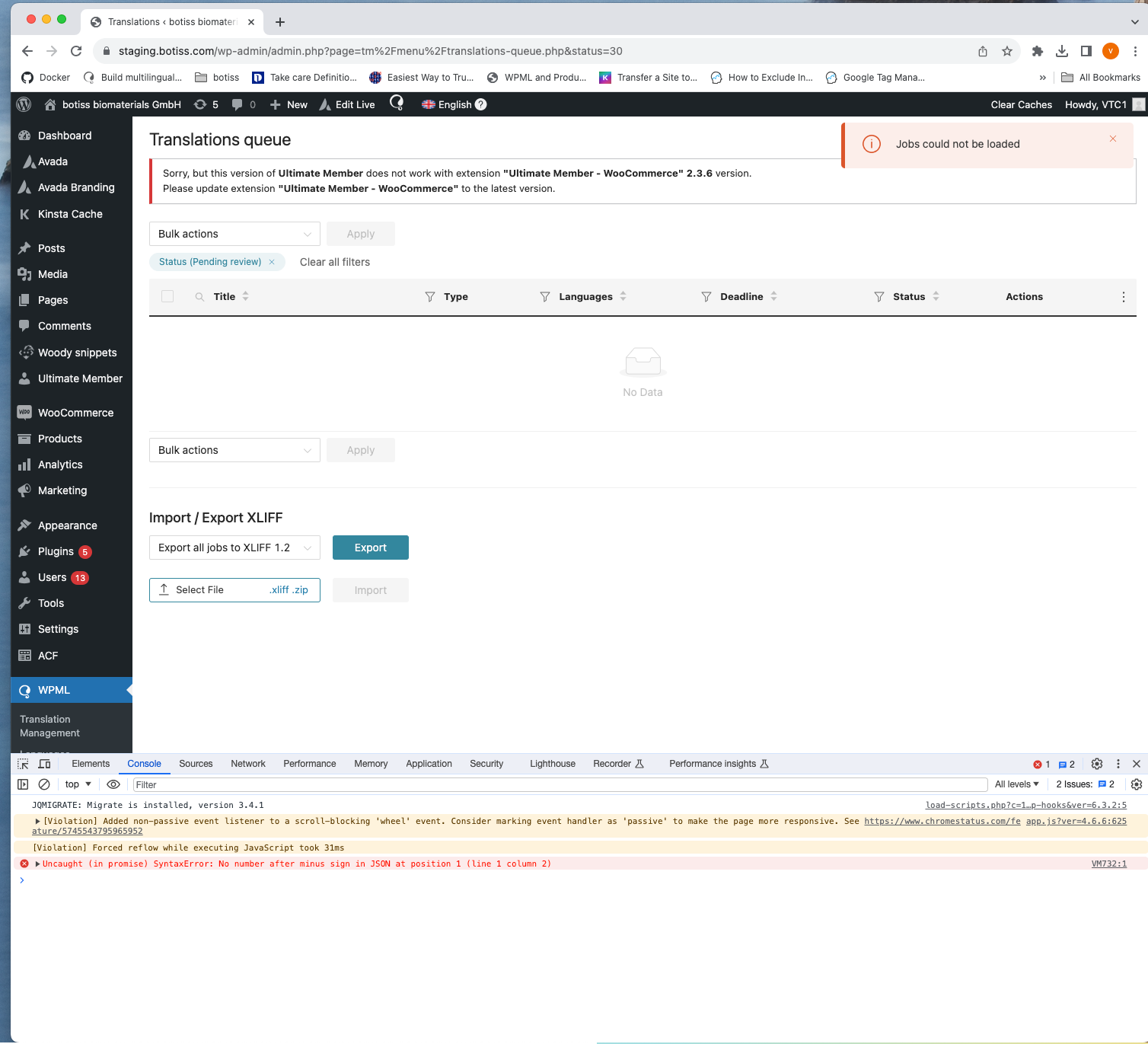

It could be this error of job in translation management . that is cause of avada layout erros
