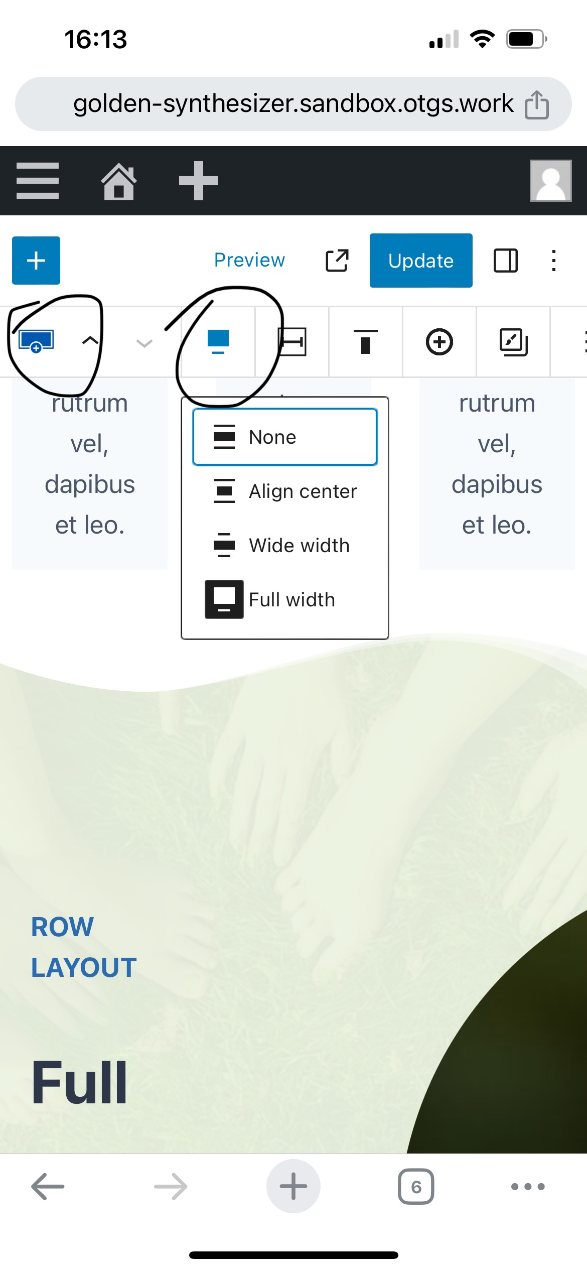

Maciej
Sorry I am only ob mobile now.
But this is set on Row Layout Block - please see attached sreen.
On this test page I copied before this row layout so it it on the bottom.

February 22, 2024 at 2:55 pm #15334236
Dražen
thanks, I checked and could see the issue, but this full width is set from somewhere else not from the row block option, since if you check it is not set to full width in the default language also, but it is showing as full width.
If you set this as full-width in the row block option in the default language and then translate/make edits, it stays like this, so this option is copied correctly, but I am not aware of where is "default" setting that is not being copied coming from or how to reproduce this issue, for example if you create new page.
Can you please check if it works like this for you and if can provide more info on how to reproduce the issue if the new page is created or from where this is set?

Maciej
Drazen,
I am not sure what is going on here. There is no other way (which I would be aware of) to set this row layout to full width. When I was creating each of these pages I set it to full width every time I wanted to have it full width. NO IDEA why it is visible as "None" now, when in fact it is full width!
Maybe that is some bug in last Kadence update... I will check pages to see if they have this full width set everywhere is supposed to be set. Hopefully setting it again will help.
