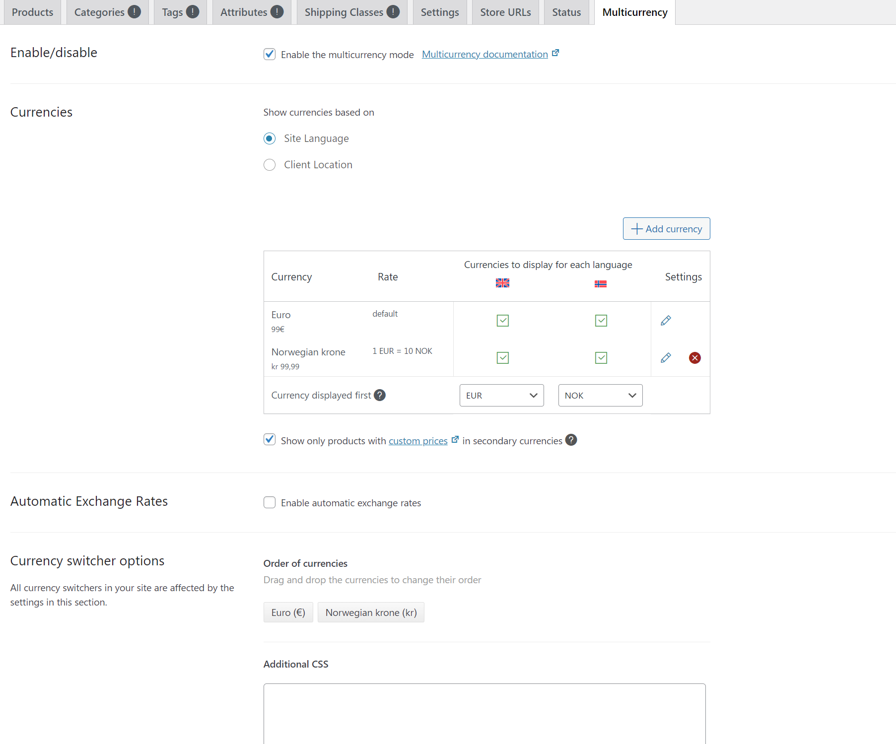

Hi, I have tried to use storefront (and I have up'ed the memory limit), but I still get the automatic price when using the second language, but the correct price on the default language, but the second currency with the currency switcher.
Attached you will find a screenshot of the set up, do you need more info?

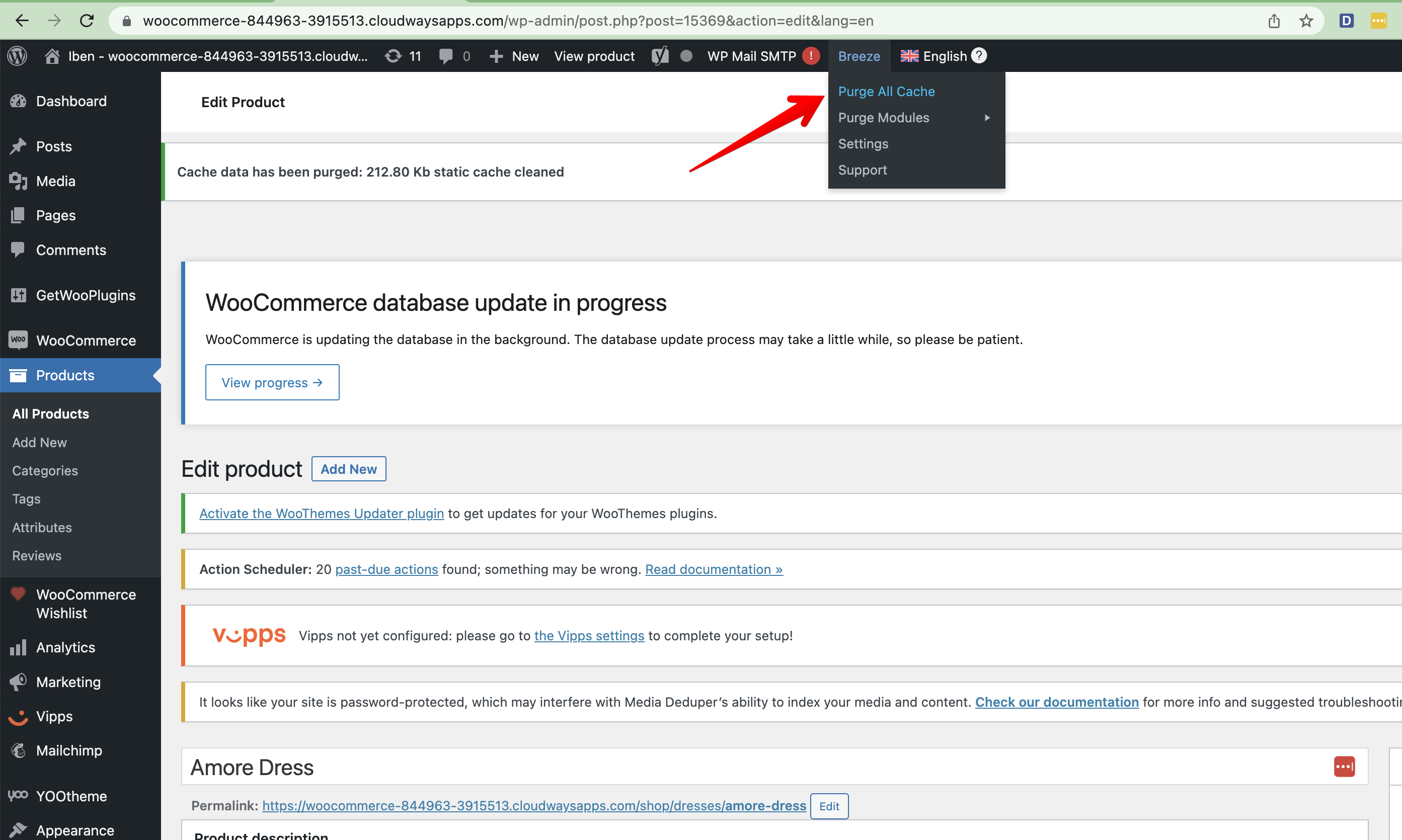

It's a caching issue. In the admin area > Top bar menu > I click on Breeze > Purge All Cache then the price displayed correctly. You can change the cache settings in Settings > Breeze.
I hope I was helpful. Don't hesitate to ask if you find any problem along the way, I'll gladly help you.
