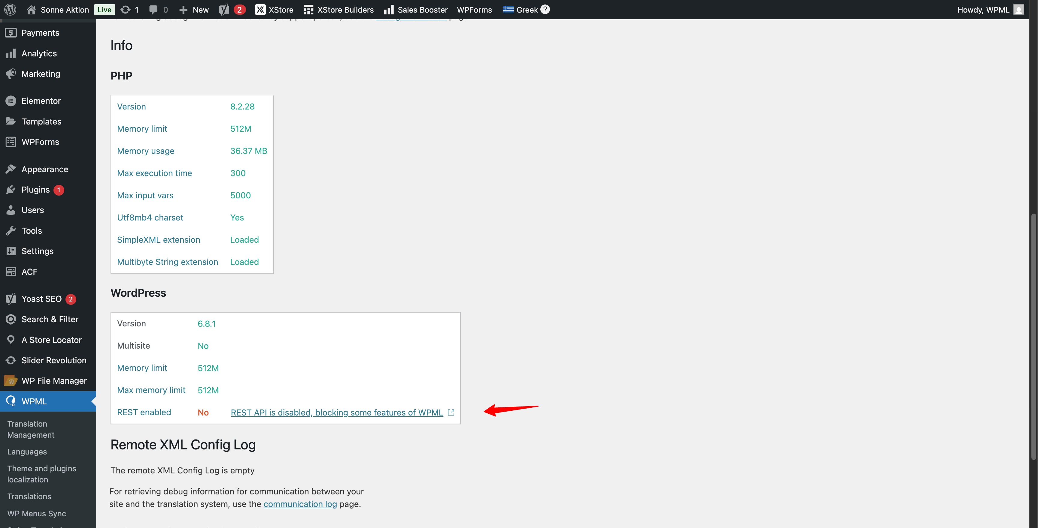

thanks, I checked further and I can see that REST API is not enabled for your website, it is needed for WPML to work correctly.
- hidden link
- https://wpml.org/documentation/support/rest-api-dependencies/
Please check with your hosting and make sure it is enabled.
Drazen

We temporarily disabled HTTP Basic Authentication for the REST API endpoints.
The REST API was then enabled, but the issue with the translated posts was not resolved.
For the time being, we cannot permanently disable HTTP Basic Authentication, as this is a development site.

I checked and it works fine now, but you will need to edit your default language page with Elementor, make small change to content save, then remove the change and save and then re-translate.
Since probably disabled Rest API also affected saving of post in DB; so it was not saved correctly.
